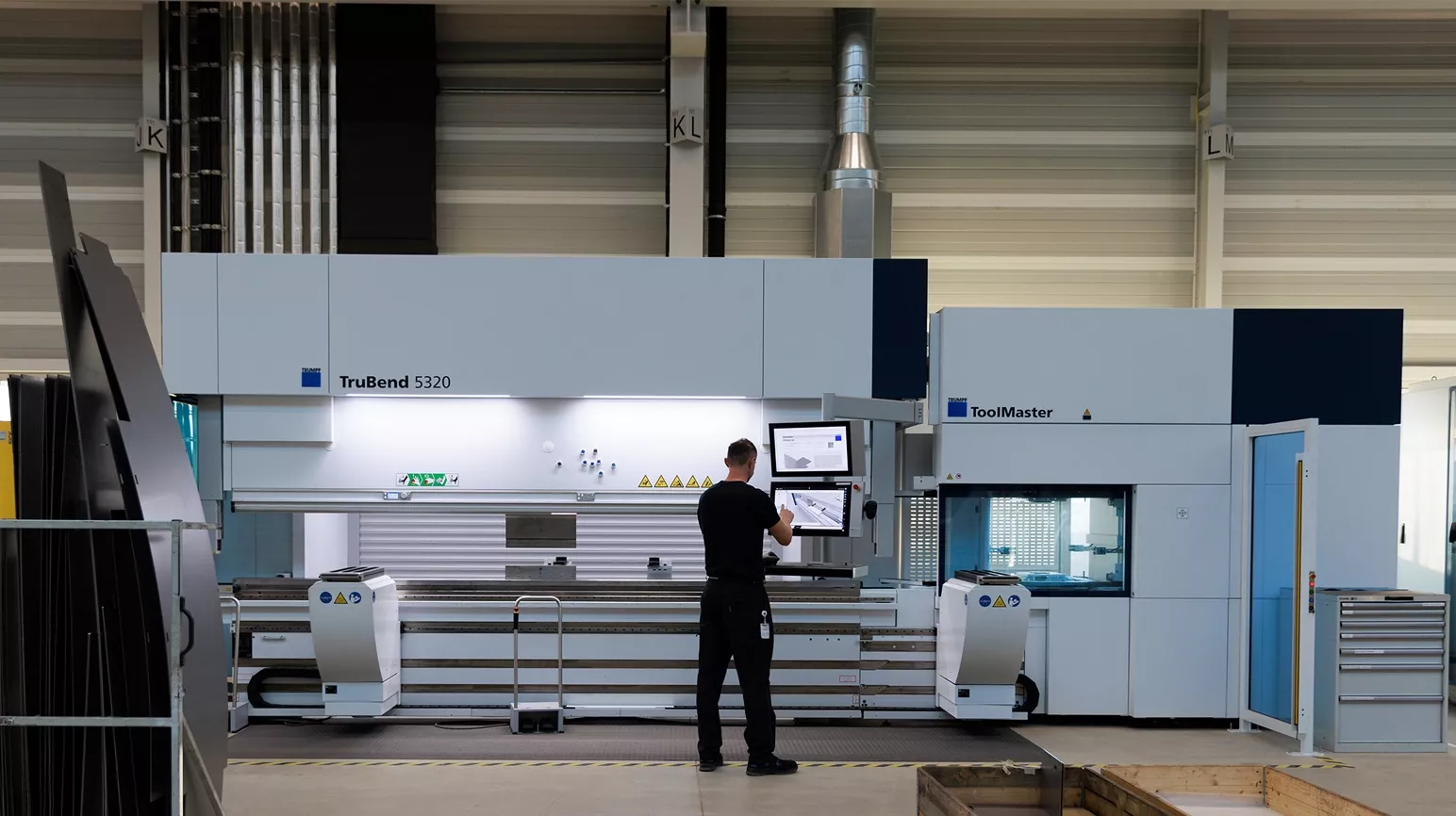

Trumpf has recorded significant growth with its bending machines in recent years and has continuously expanded its product portfolio in this segment. With its capacity utilization increasing, the company had to order the frames it uses for its multi-ton bending machines. This led to longer production times, higher costs, and limited flexibility in production. Welding was done manually at the supplier’s premises, which led to time-consuming rework. This included an energy-intensive spheroidizing process that was needed to avoid hardening in the steel, an undesirable effect of manual welding.

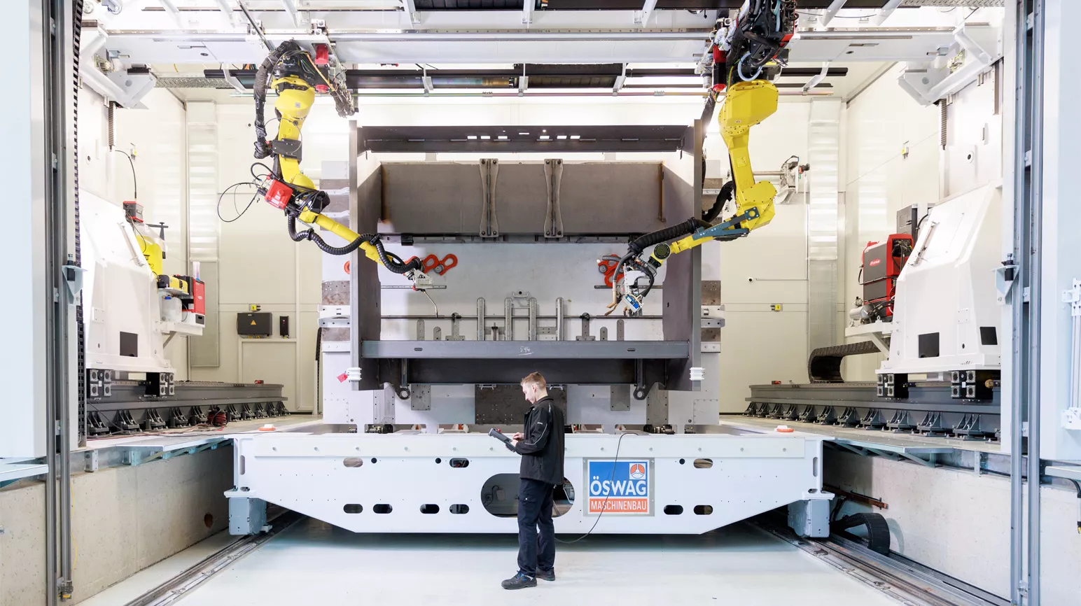

Trumpf evaluated concepts from various suppliers before opting for the LaserHybrid robotic welding system from Fronius. The aim was to find the best solution from both a technical and profit perspective. Options for moving the components—which weigh up to 18 tons and measure 4.5 × 3 × 2 m—during welding or placing them on rotary tilting positioners were quickly taken off the drawing board. These approaches would not have been able to accommodate setup parallel to production, which Trumpf preferred from the outset, or could only provide for this to a limited extent.
The company therefore decided to install a two-station gantry system with one LaserHybrid and one MIG/MAG welding robot as well as two large tilt positioners that allow components to be fed in horizontally. While one machine frame is being welded, the next one can be clamped on the free positioner.
“As well as impacting setup parallel to production, rotary tilting positioners would pose a risk of excessive tilting moments if the center of gravity of our multi-ton components were too far away from the turning or tilting axis. This would create an extremely high risk of damage to the system as well as accidents,” explains Reiter. “The only way to avoid these issues was by using huge rotary tilting positioners. But then we would have a problem with the working height. Due to the enormous size of some of the components, we would either need a trench two and a half meters deep or a machine height of at least two meters.”
All things considered, the version proposed by Fronius turned out to be the best. A number of factors were crucial here, including a sensible safety concept, the fact that using two welding robots would eliminate the need for a torch changing station, the system’s hassle-free hosepack routing, the use of WireSense for seam tracking, and ready accessibility to corner areas thanks to the slim MIG/MAG robot. Efficient production was also guaranteed, with the two tilt positioners allowing for setup parallel to production. Other plus points that put Fronius ahead included the partners’ long-standing and trusting business relationship, offline programming of welding jobs with Pathfinder, and the expertise the Fronius specialists had to offer around system technology.
No tool changes required
To avoid torch changes and all the related problems that come with transferring the hosepack, the experts at Fronius opted for a gantry system with two welding robots. Each is equipped with one LaserHybrid and one MIG/MAG welding head, both of which move overhead on a rail while operating one at a time. The LaserHybrid robot starts by carrying out root pass welding. Hard-to-reach areas and top passes are then welded using the MIG/MAG hollow-arm robot.
“The hollow arm of the MIG/MAG robot guarantees optimal routing of the hosepack. Hosepacks that are routed to the side often dangle unintentionally, which can cause damage or, in the worst case, even mean they come detached. There is also a risk that these hosepacks could get caught on components or devices, which can prevent robots from moving freely,” Reiter explains.
Sophisticated: two welding robots on a single rail
Using two welding robots on the same rail presents a particular challenge. As a solution, only one robot welds the component at a time, while the other remains in the park position. A specific program template was created for each robot, which contains all movements and travel and serves as the basis for programming the component-specific welding tasks.
