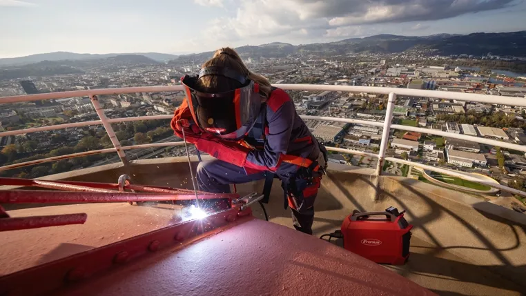

Welding with the Ignis Battery above the rooftops of Linz

Whether you’re working on exposed installations and construction sites, in the great outdoors, or in an open field: These and many other situations pose a particular challenge for welding specialists. Complex grid leads often have to be laid to the welding point or a heavy and noisy generator used—both very costly and time-consuming measures.
With the Ignis Battery, a mains power connection is not required. Thanks to complete independence from the energy supply, you can rely on a stable and high-performance welding process for both manual arc and TIG welding with innovative battery technology. Leaving you to focus fully on the task at hand.

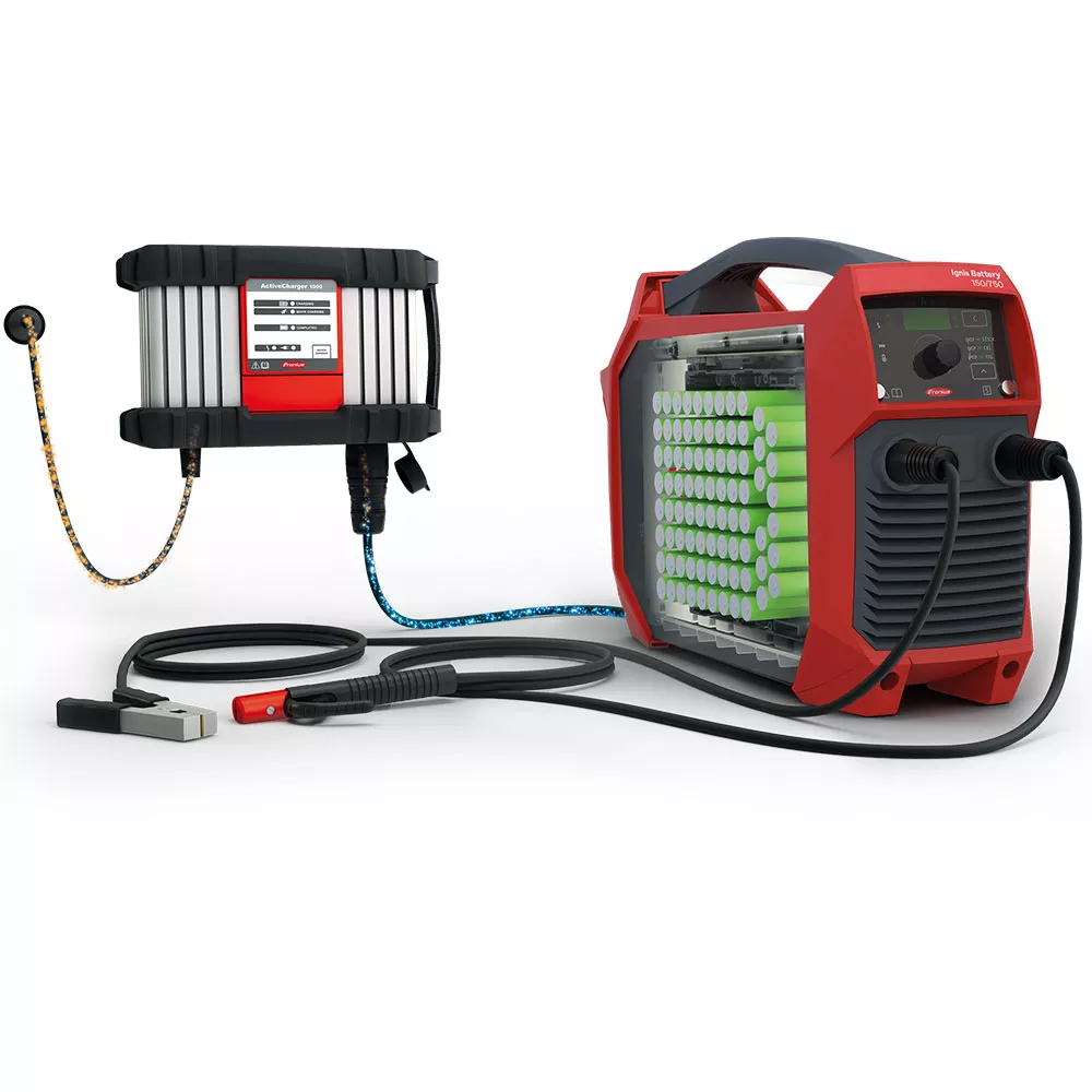

Special features: 84 battery cells, 750 Wh, no memory effect, low self discharge, voltage monitoring of all battery cells and protection from overcharging, deep discharge, and overheating. A quick charge is possible in just 40 minutes (80% state of charge), full charging takes 60 minutes.

Ignis Battery battery characteristics
