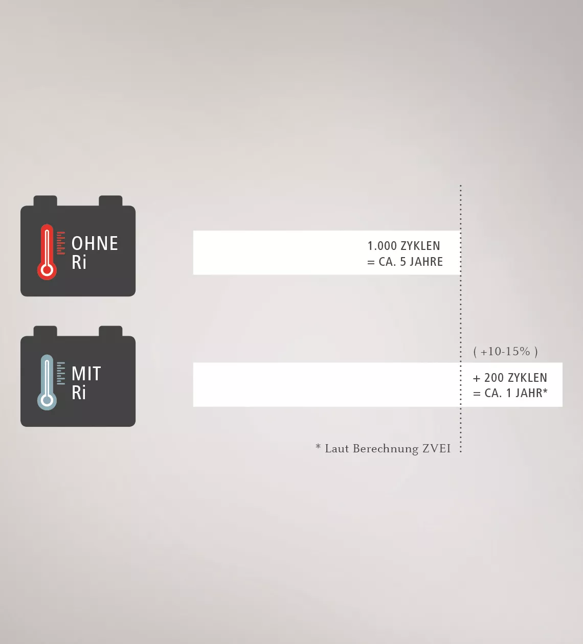

The bigger the battery, the bigger the investment: the traction battery is a significant cost factor when purchasing a forklift truck system. However, the service life of the battery is crucial for the cost effectiveness of the overall three-part system (forklift truck, battery and charging technology). This is particularly noticeable if the battery is charged frequently. Due to the chemical reaction that takes place during charging, the temperature inside the battery increases – and the hotter it becomes, the quicker its service life diminishes.
Using the right charging technology plays a vital role in extending the service life of expensive batteries. The new Selectiva battery charging systems from Fronius feature the innovative Ri charging process. This does not follow a fixed characteristic; instead it adapts to the age, temperature and state of charge of the battery. Every single charging cycle is therefore unique and has its own characteristic, ensuring extremely gentle charging. In addition, the charging process can be extended over the entire available time period (for example overnight), reducing any harmful warming of the battery to a minimum. The cooler temperature during charging increases the service life of the battery, which in turn promises significantly lower operating costs.
