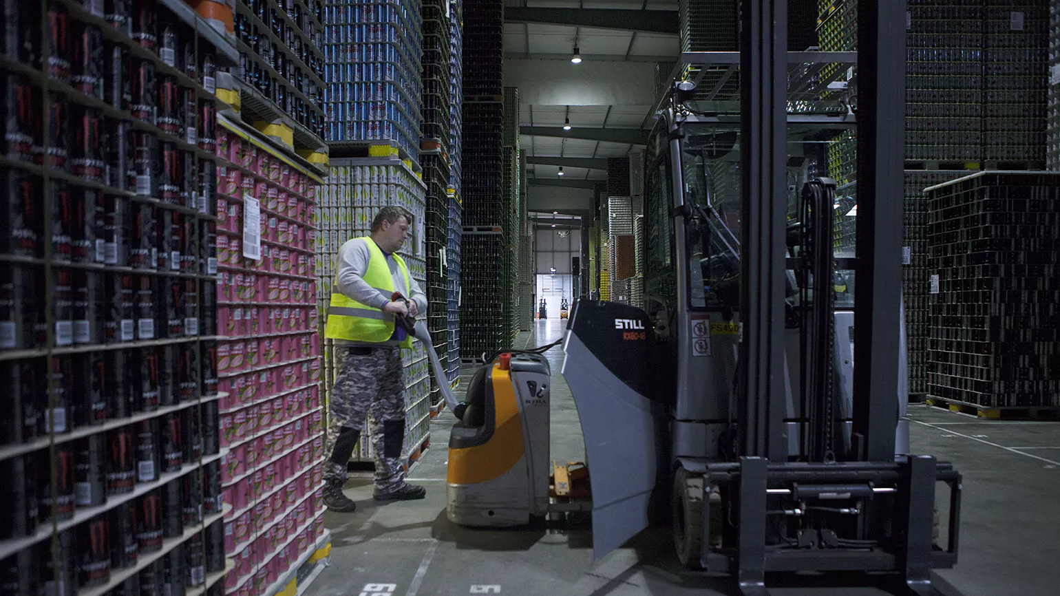

remove the heavy 80-volt batteries from the vehicle using a manual lift truck
The employees remove the heavy 80-volt batteries from the vehicle using a manual lift truck, transport them carefully to the storage area and exchange them for a fully-charged battery.

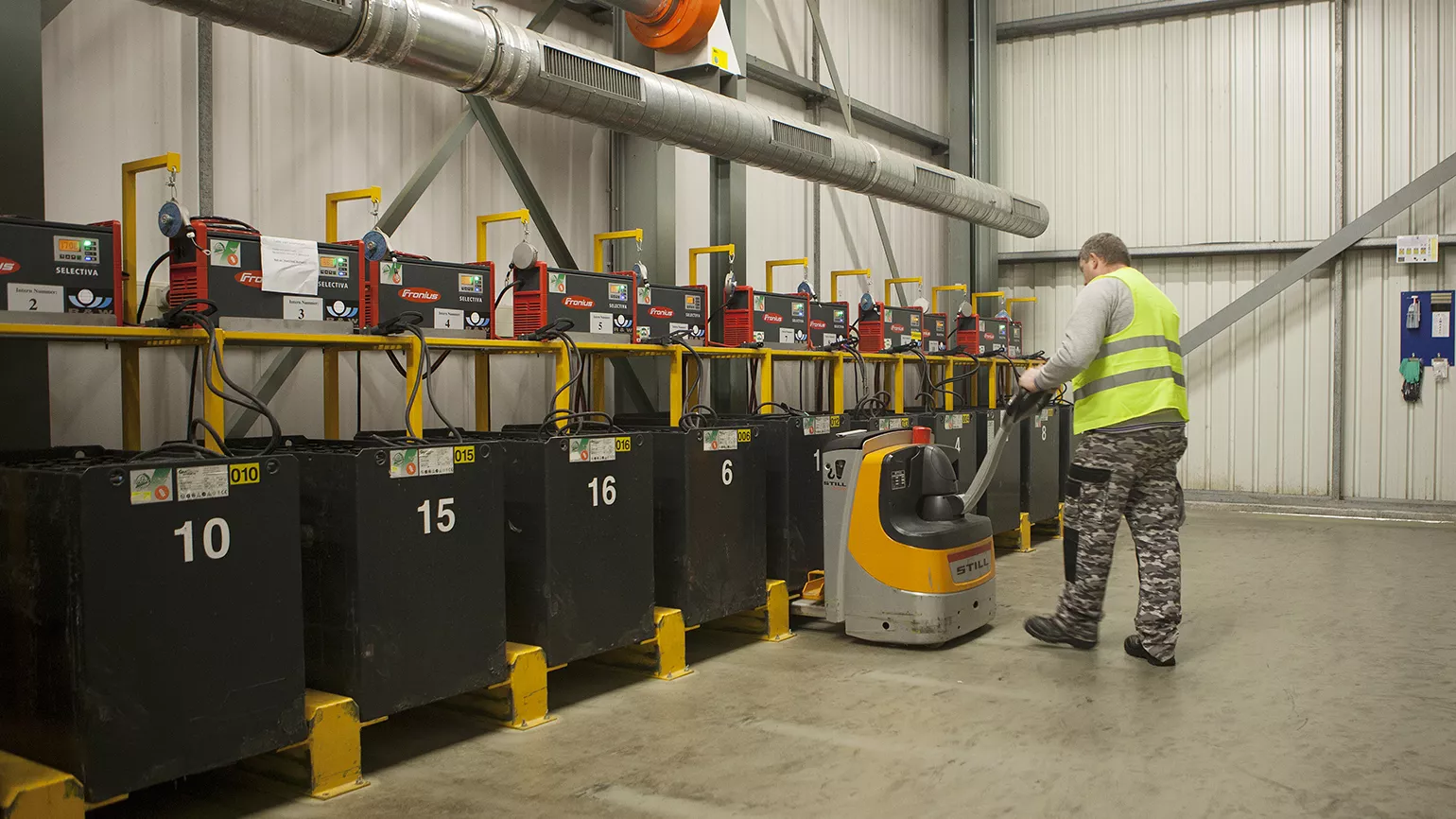

In order to stop such problems arising, the logistics specialists gradually replaced the old chargers with battery charging technology from Fronius. Today, the charging station consists only of devices from the Austrian experts. These devices were delivered and set up by the Dutch sales partner of Fronius, R & W Batterijen. “When it comes to the energy consumption and the performance of the forklift trucks, many users generally look only at the batteries and the vehicles themselves,” explains Stevan van Laar, account manager at R & W. “However, it is in the charging technology – a component that is frequently overlooked – that the greatest potential for optimisation is often found. We therefore recommended the Fronius devices, as many of our customers have had good experiences with them in the past.”
Ri charging process enables gentle charging
Bikker LogisticsBV is using the battery charging systems from the latest generation of theSelectiva product range. These systems incorporate the Ri charging process.“This is the most advanced process currently available on the market,” notesStevan van Laar. The secret: unlike conventional technology, this process doesnot follow a rigid characteristic with a fixed current across the entirebattery capacity range. Instead, the characteristic results from the effectiveinner resistance (Ri) of the battery, which is dependent on its voltage,capacity and state of charge. “This means that each charging process is unique,with an individual characteristic,” explains Stevan van Laar. “Furthermore,losses during the main charging phase, which impair the energy balance and leadto harmful heating up of the battery, are minimised.” The Selectiva batterycharging systems from Fronius also have a special Refresh characteristic. Thishelps to improve the performance of deeply-discharged and sulphated batteriesagain. Warehouse managerSander Schuijers is also impressed by the technology: “The gentle and adaptedcharging preserves the capacity of the batteries and extends their servicelife. This allows us to reduce our operating costs and, above all, to increasethe availability of the fleet of forklift trucks.” What is more, the process ofreplacing and connecting the batteries is also extremely simple. The employeesremove the heavy 80-volt batteries from the vehicle using a manual lift truck,transport them carefully to the storage area and exchange them for afully-charged battery. This process takes only a few minutes, then the forklifttruck is ready for use once again. Employees simply have to connect the plug –everything else happens automatically. “With the new charging technology fromFronius, even older battery models function reliably again. Frequent failuresare now a thing of the past,” summarises Sander Schuijers. “Thanks to Froniuswe can concentrate on our actual work again – and rely fully and completely onthe availability of our forklift truck fleet. This ensures seamless processeswithin our company.”
