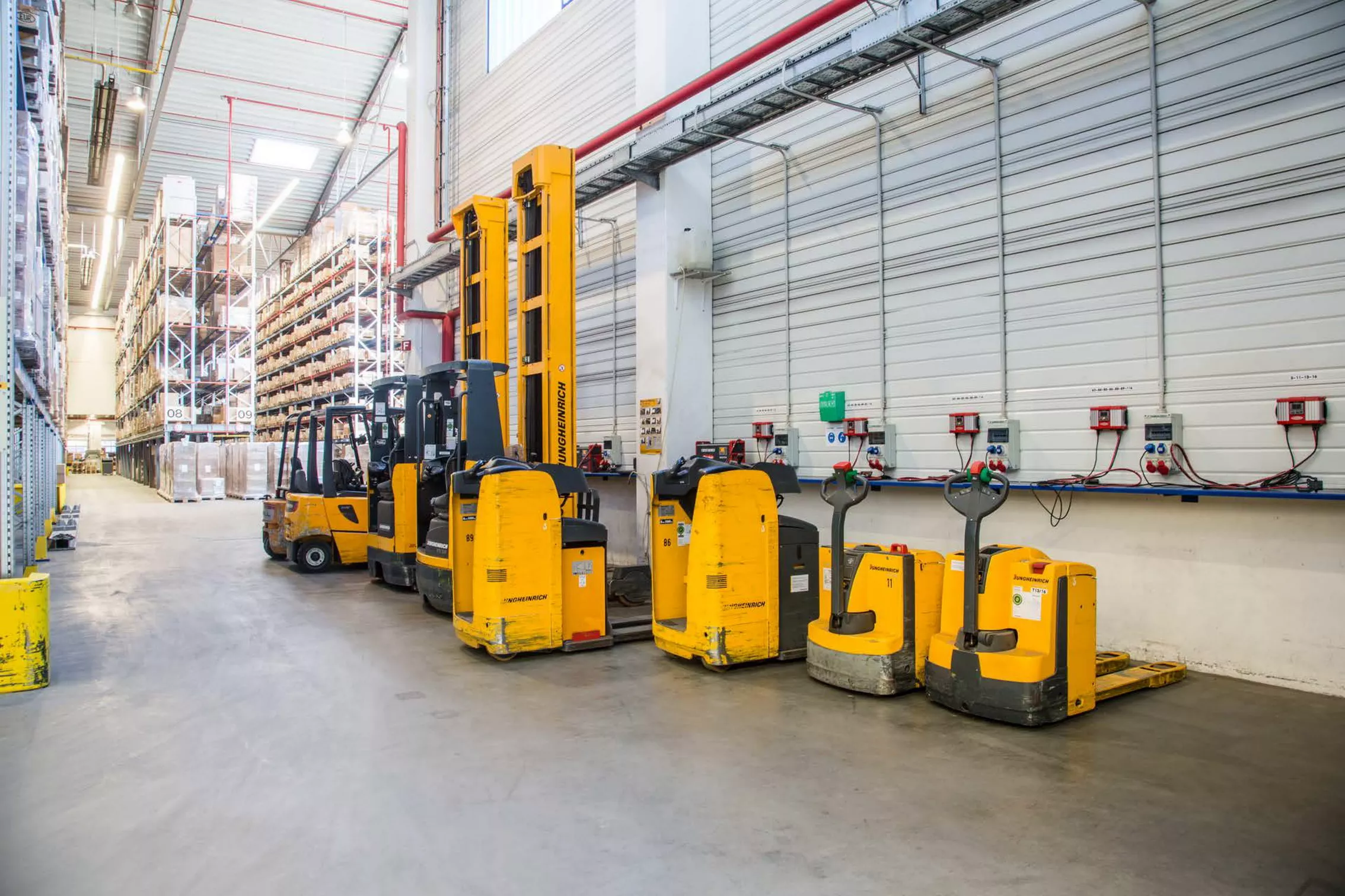

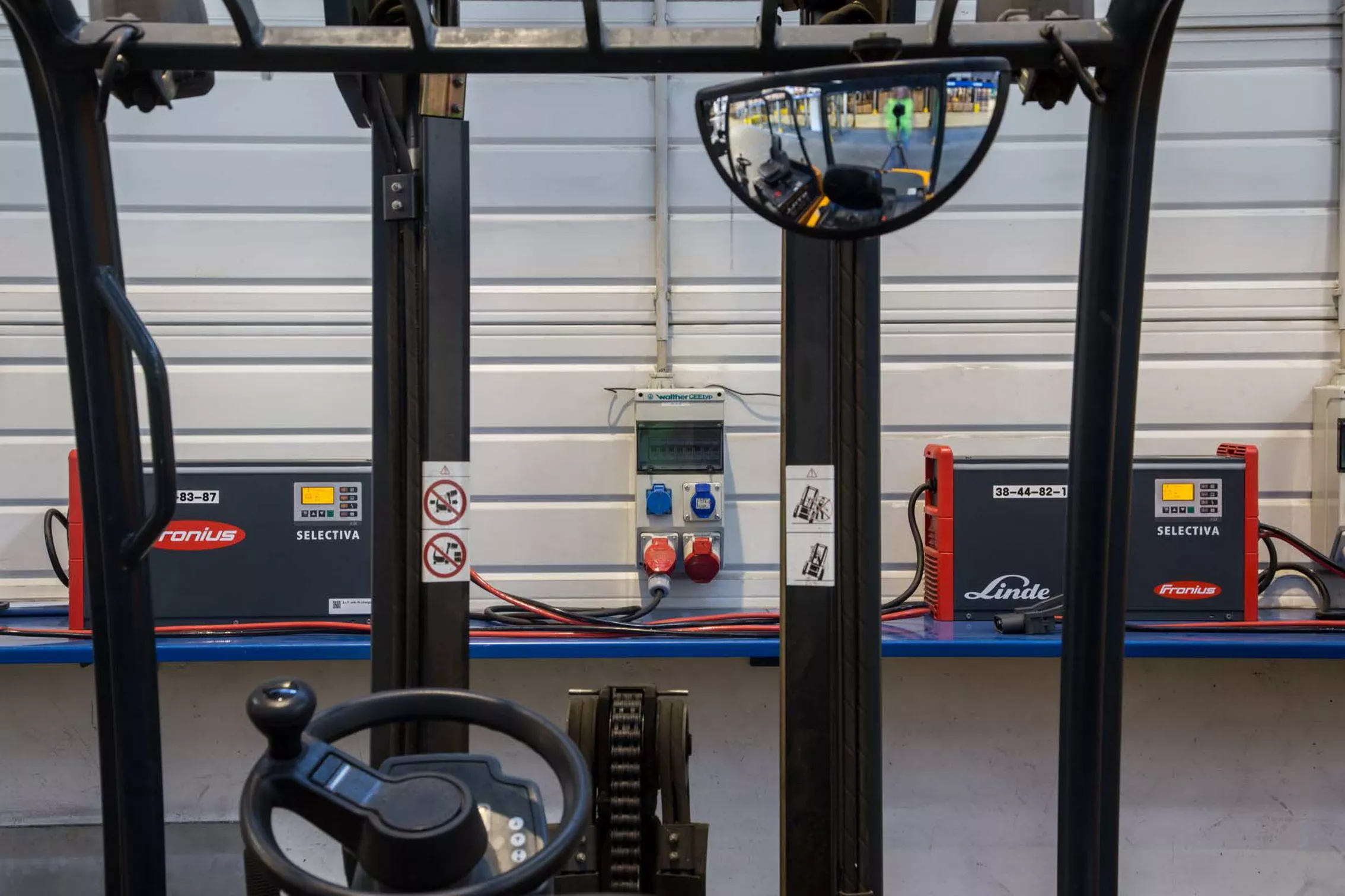

As part of the environmental management process, Rhenus took a closer look its fleet of forklift trucks to discover that considerable savings could be made in terms of energy consumption and process efficiency. The electrically-powered forklift trucks are driven by lead batteries, which are charged using a central charging station at the side of the hall. As the logistics centre does not employ a multi-shift operation, the forklift trucks do not have back-up batteries. “Previously there were fixed times at which we connected all the forklift trucks to the station for charging at the same time, irrespective of how full or empty the respective battery was,” recalls Kellenberger. “However, that was not particularly cost-effective.” In addition, the available technology was no longer up to date; some of the battery charging systems still relied on the old 50 Hz technology. This resulted in unnecessarily high energy costs and was partly responsible for the excessive overcharging of the batteries, which frequently caused the expensive lead batteries to reach the end of their useful life prematurely.

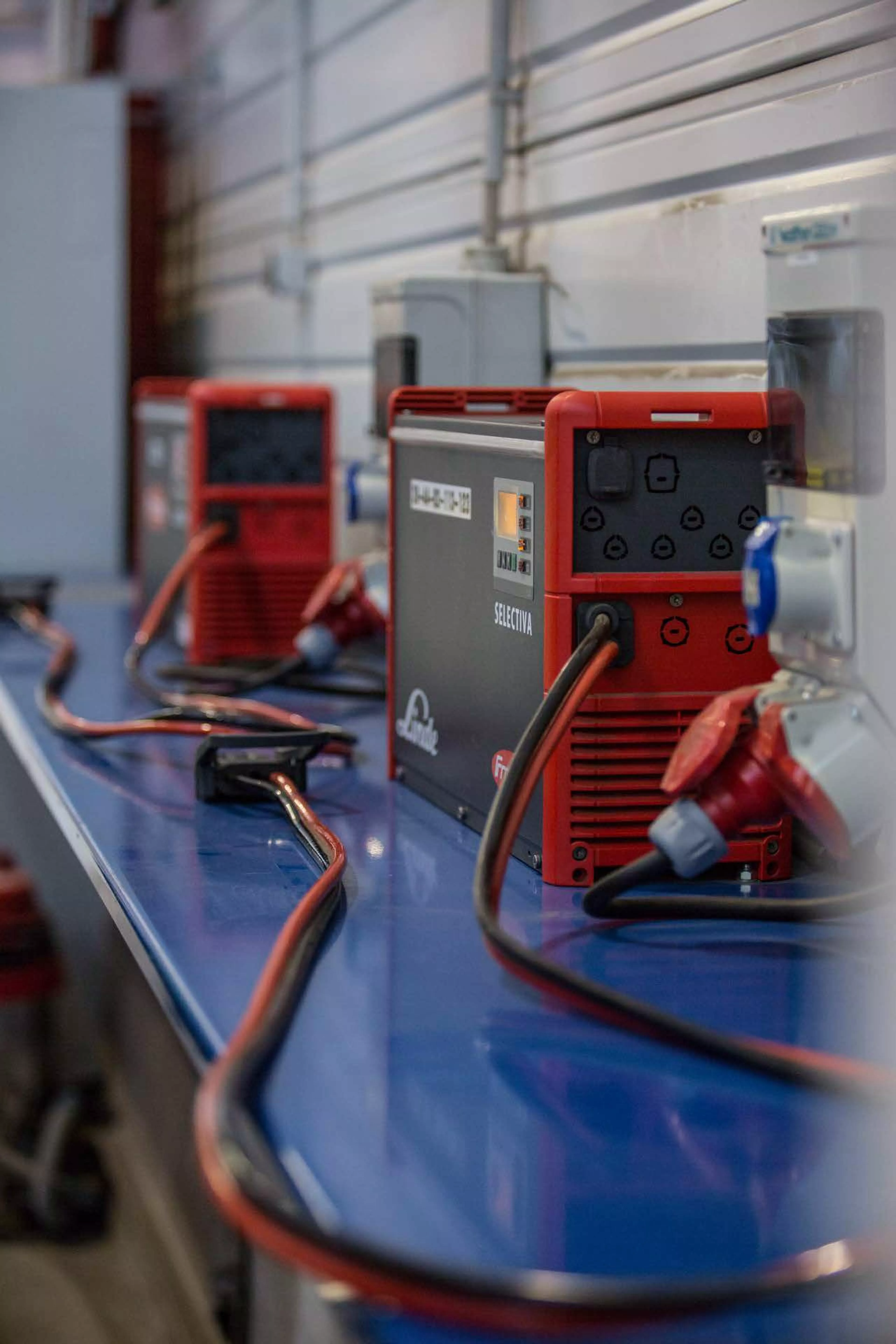

When searching for a way to optimise the charging process, the managers at Rhenus Contract Logistics soon came across Fronius. The leader in battery charging technology with headquarters in Pettenbach, Upper Austria, has developed a solution for increasing the efficiency of the charging process and the service life of the traction batteries with the new generation of Selectiva devices. “The secret is the new Ri charging process, which adapts to each individual battery,” explains Reto Baumgartner, Sales Advisor for Battery Charging Systems at Fronius Switzerland. “The charging characteristic is determined by the battery’s effective inner resistance, which in turn is dependent on the age, temperature and state of charge of the battery.” This minimises the overcharging responsible for high energy losses and harmful warming of the battery, thereby reducing energy consumption and ensuring a longer service life.
Charging when required instead of at a fixed time

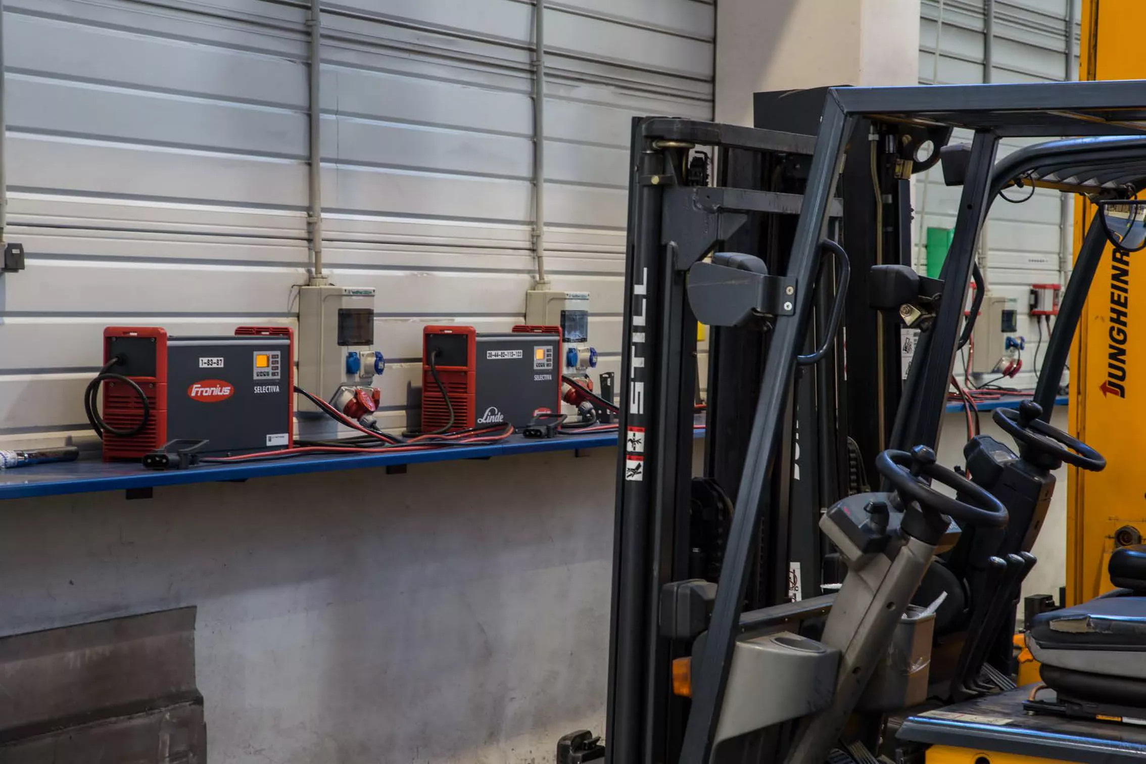

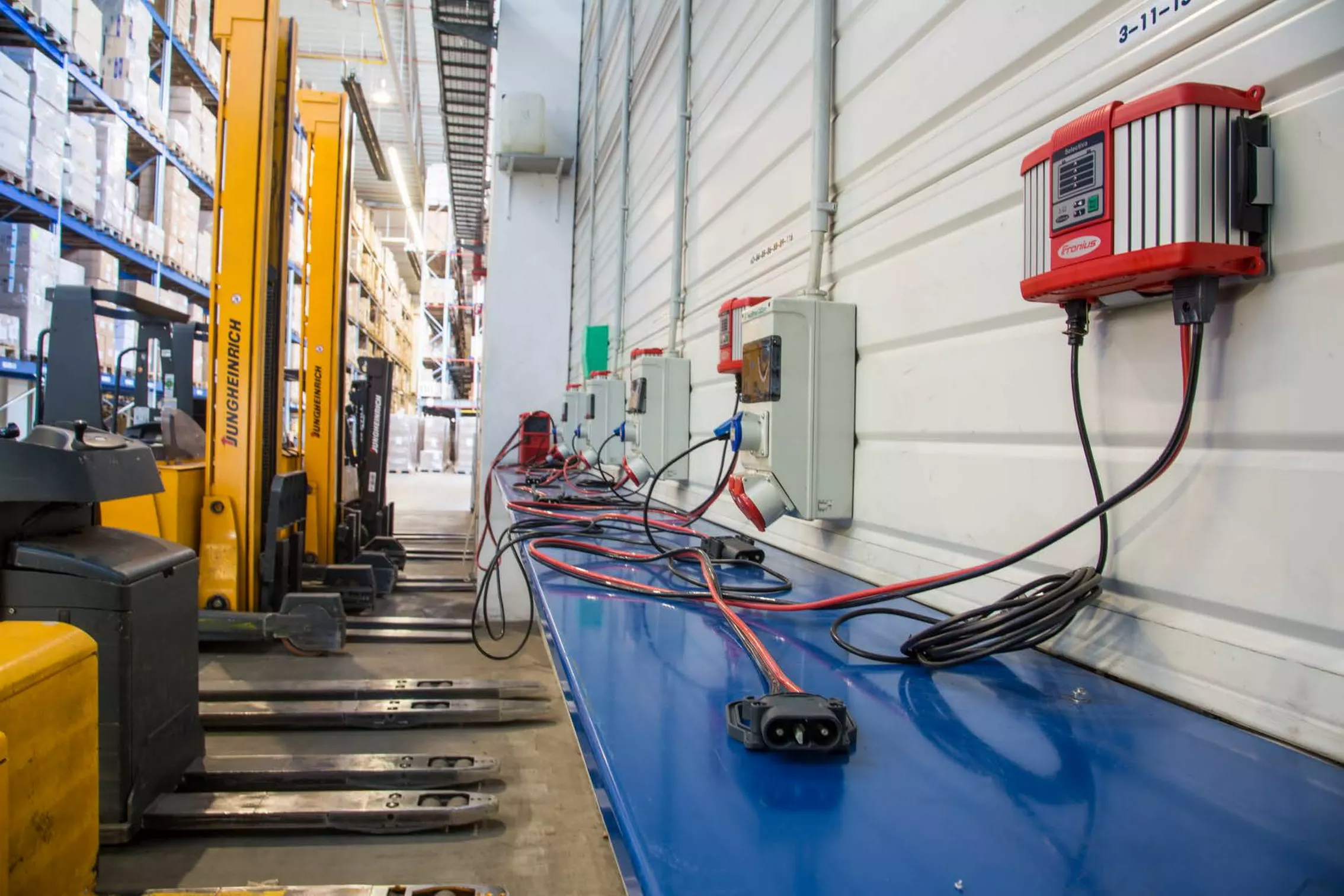

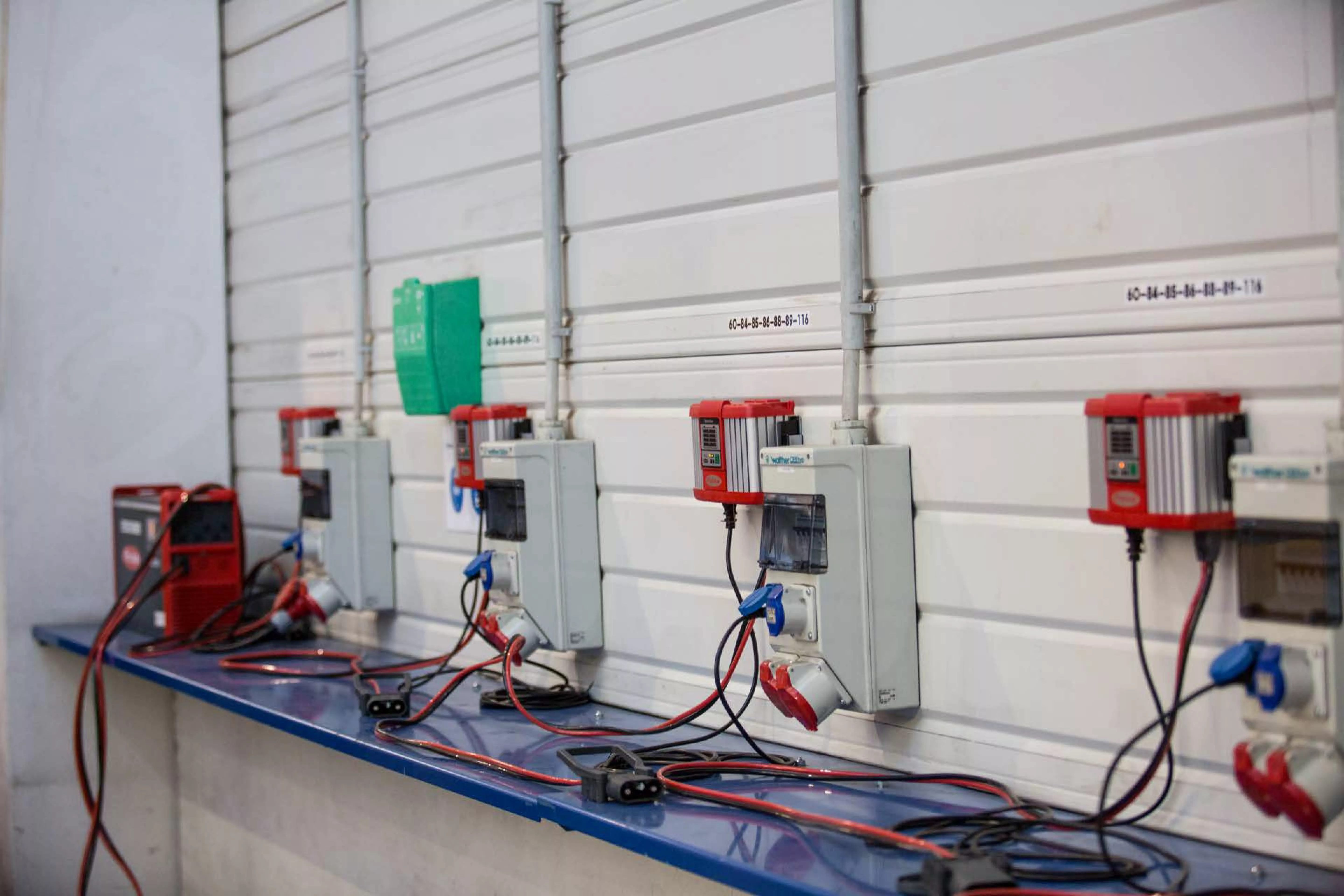

Since August 2015, Rhenus has been using twelve Selectiva devices from Fronius, which have been a resounding success. “The compact design alone has made our charging station more visually appealing and much more modern,” says Kellenberger. And that’s not all. “We were also able to dramatically increase the efficiency of the charging process,” adds the warehouse manager. The devices (with an output of 1 to 8 kW) are flexible and can charge various types of battery. Forklift trucks and battery charging systems are numbered for straightforward assignment, which helps prevent errors. In addition to all this is a significant change: “The charging process now takes place as required, rather than at specific times,” reveals Kellenberger. “This means that we no longer need a battery charging system for each forklift truck; we actually need half as many.” At the same time, the availability of the forklift trucks has increased considerably - an important step in optimising processes at the logistics centre.
Kellenberger enthuses about the advantages of the Ri charging process: “Gentle charging has enabled us to dramatically reduce the energy consumption of our forklift truck fleet. The process also protects our batteries, which in turn extends their service lives.” This is evident from the operating costs, as the expensive traction batteries need to be replaced less often. The new technology is also much more reliable. “Previously, current peaks would always occur at the start of charging,” recalls Kellenberger. “This could even lead to fuses becoming overloaded, and if this goes unnoticed, charging will not take place.” However, this problem is now a thing of the past thanks to the Fronius devices. Rhenus has also been able to continue using the existing fuses, reducing installation work considerably.
