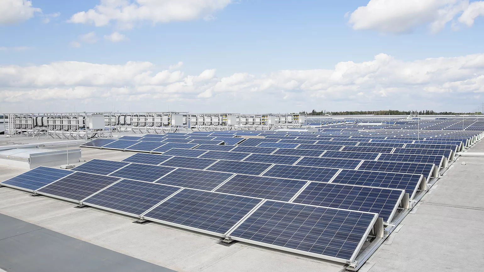

Larger storage capacities for commercial systems
Commercial enterprises often need a lot of energy during the evening and at night, too. With one or more energy storage systems, the energy that is generated during the day can also be used at night for the company’s own loads.
This makes it possible to cover various company base loads, such as power for lighting, the computer infrastructure, cooling, production machinery, forklift trucks, or feeding machinery for agricultural enterprises.

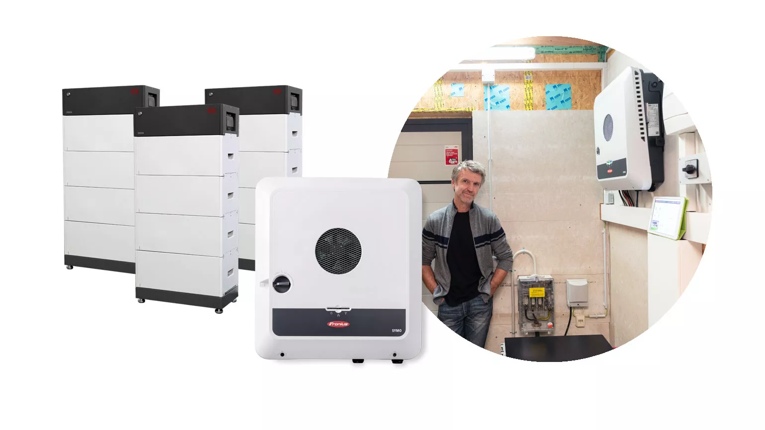

Simple installation and commissioning
Installation of the storage system in parallel operation requires no additional hardware, which saves on costs. The floor mounting means that the installation can be carried out quickly and easily, as usual.
This combination is possible with all Fronius hybrid inverters (Fronius Symo and Primo GEN24 Plus, Fronius Symo Hybrid). Up to three battery storage systems of the same type and size can be connected in parallel*. More information about the possible combinations can be found here.
