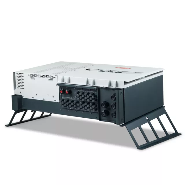

Connection options On the AC side, cable cross sections of up to 240 mm² can be implemented. This not only allows maximum planning flexibility, but also means huge cost savings in ongoing operation.
3
Flexible installation Practical brackets allow Fronius Tauro to be installed vertically or horizontally.
4

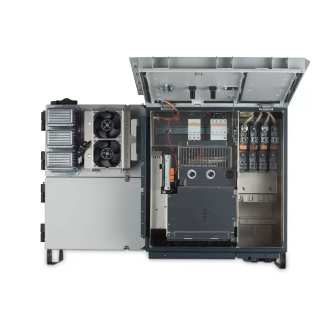

Active cooling Active cooling continuously transports heated air to the outside, thus protecting the power electronics from heat.
1
Generous connection area The generously proportioned connection area has space not only for a surge protection device, but also for other third-party components.
2
Component replacement Simple power stage set replacement allows fast service by only one person on site.
3
1
Active cooling
2
3

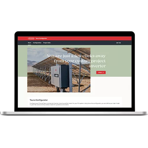

Configure project inverters easily online
Create your customised project inverter with just a few clicks: use the configurator to optimally match Fronius Tauro with your PV system requirements.
Based on your configuration, we will prepare a tailor-made offer for you, and you can order Fronius Tauro conveniently online.
Configure now
