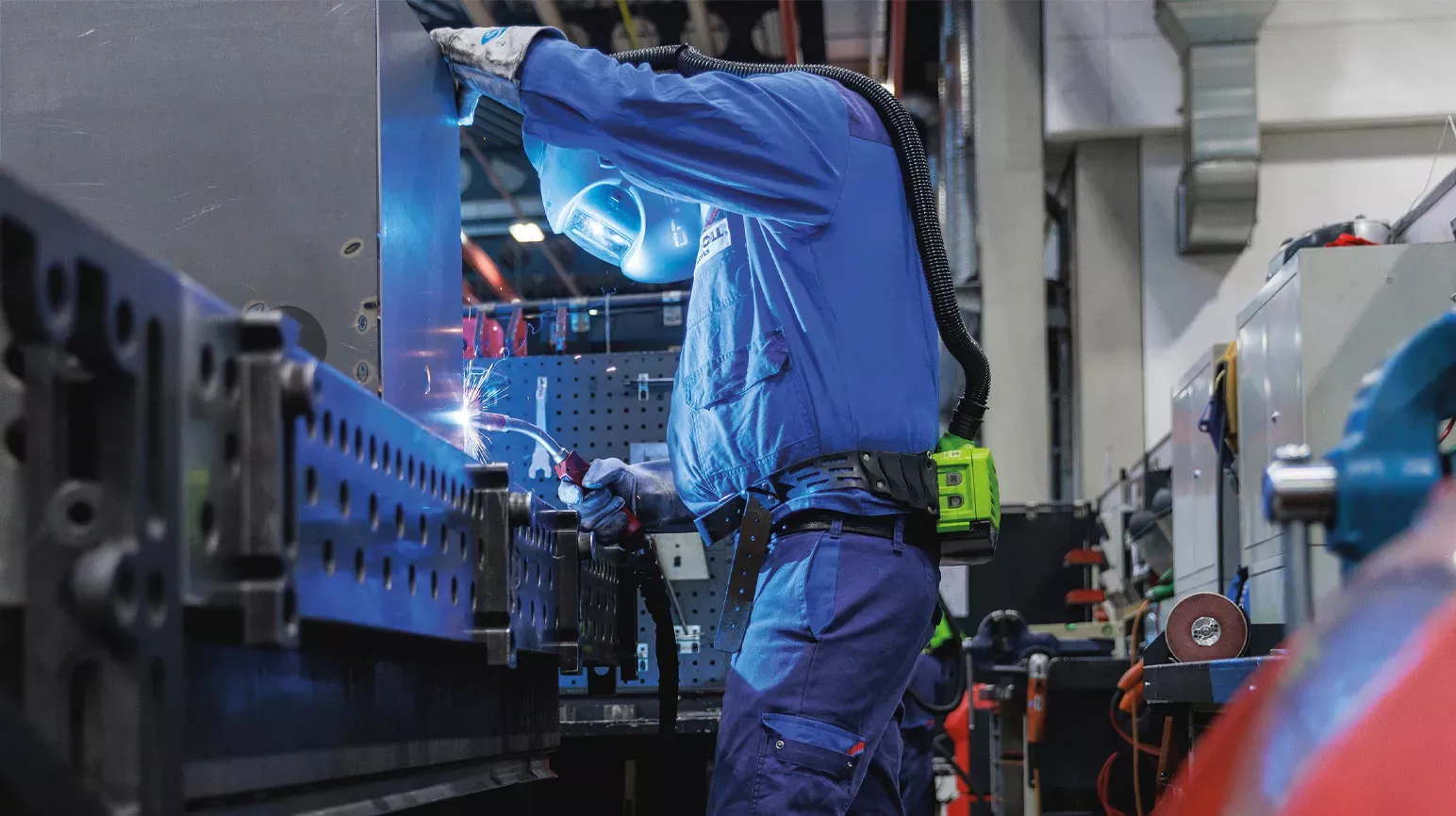

Whenever series production is not a consideration, welding is frequently carried out by hand. Welders often work in positions that strain the joints and muscles, for example when welding while forced to adopt awkward postures. This results in complaints such as sprains of the lower back or arms, which not only affect the health of welding professionals, but also come at the expense of the company’s productivity. Companies are therefore increasingly focusing on ergonomics during welding.

Most causes of injury are not restricted to specific industries, but result from the movement and behavior patterns of welders. Typical here are repeatedly stretching the body, twisting the spine, being supported by or kneeling on hard surfaces, maintaining the same posture over a longer period of time, or a lack of rest. If such risk factors occur repeatedly (individually or in combination) they can lead to work-related musculoskeletal disorders (MSDs), in other words injuries and diseases that affect muscles, nerves, tendons, ligaments, joints, intervertebral discs, skin, subcutaneous tissue, blood vessels, or bones. In addition to the causes previously mentioned, unfavorable environmental conditions such as extreme temperatures can also contribute to the development of MSDs, while personal risk factors such as physical condition, pre-existing illnesses, or age also come into play.

Time and again, welders are forced to adopt unfavorable postures for a variety of tasks—frequently over long periods of time. It is often easier for the welder to move around large, heavy components themselves than to move the component into the optimum welding position. Is it therefore paradoxical to talk about ergonomics and welding in the same sentence? Absolutely not. Because despite all the hindrances, there are plenty of ways in which welding companies can design workplaces and work equipment ergonomically. Effort that is generally rewarded by a healthier workforce, better morale, higher productivity, and enhanced product quality. For example, height-adjustable welding tables and stools are tried and tested means of adapting the welding height to the physical requirements of welders.

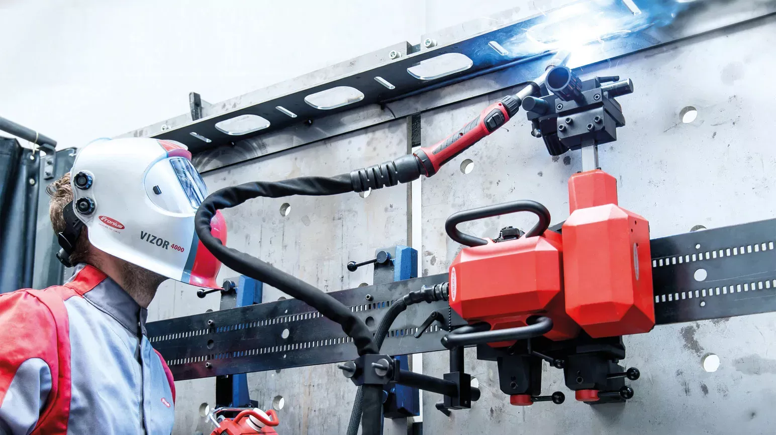

Ideal for long seams: welding carriages
“Rather than welding meters of welds by hand in the overhead position, rail-guided welding carriages can often be used. The same applies to longitudinal seams and circumferential welds of large dimensions, which can be joined either with rail-guided carriages or with magnetic welding carriages. If mechanized systems like these are used, professional welders essentially only have to operate the remote control, while standing upright and with no physical exertion required,” explains Christian Neuhofer, Product Manager Fronius Welding Automation.
The compact Fronius FlexTrack 45 Pro can be used in a wide range of applications. Three different rail types are available to suit different requirements. In industries where surface geometries vary, such as shipbuilding or container construction, FlexTrack 45 Pro welding carriages are perfect for all-round use.
