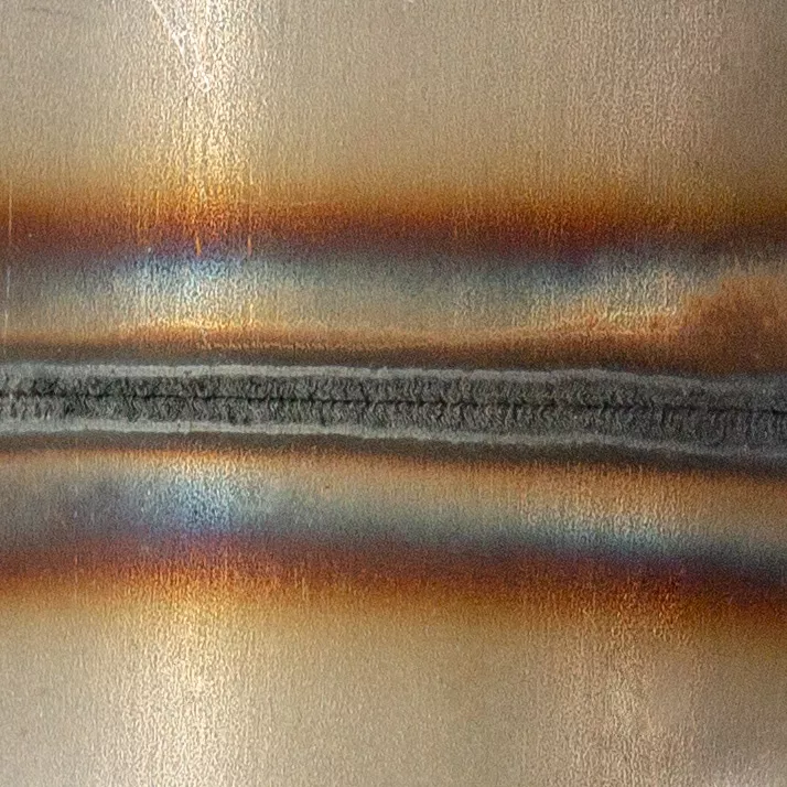

Weld seams with undesirable temper coloration
Temper coloration is produced when welding without oxidation protection (forming). At these points, the passive layer of the stainless steel has been damaged by the welding process, which can lead to corrosion. The use of forming gases is therefore necessary, especially on the inside of the pipe or on the underside of the root, where the shielding gas from the welding torch cannot create a sufficient gas shroud. This is the best possible way to avoid temper discoloration and oxidation.

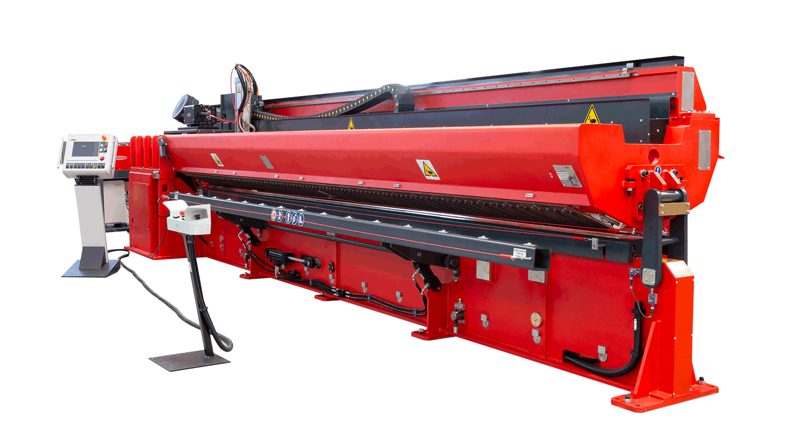

Longitudinal seam welding systems
For welding container shells

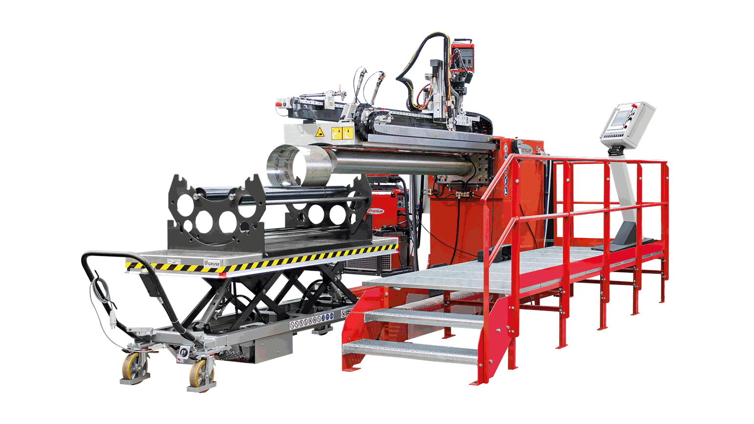

FCP 2100-2 Seam welder
FCP 2100-2 seam welder with intuitive HMI system controls, TIG, ArcTig, Plasma
FCP 6100-2S Seam welder
FCP 6100-2S seam welder with intuitive HMI system controls, TIG, ArcTig, Plasma

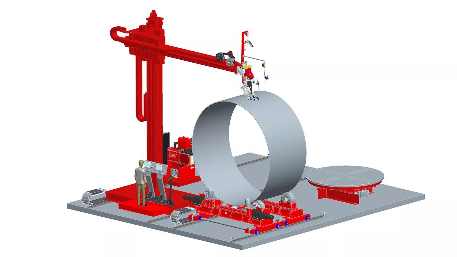

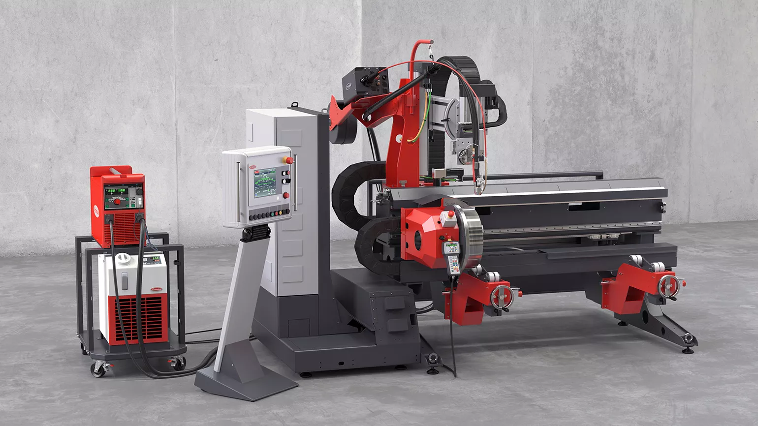

Circumferential welding systems
Circumferential welding system for joining container shells in flat position (PA)
Intuitive HMI system controls, remote control, and ArcView camera system for monitoring the weld seam.
Welding processes: TIG, ArcTig, Plasma
Circumferential welding system  for joining container shells in horizontal-vertical position (PC)

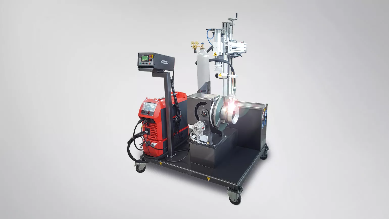

FCW 650 Circumferential welding system
Mobile welding system incl. FCU-20 system controls. Ideal for small and medium-sized businesses.

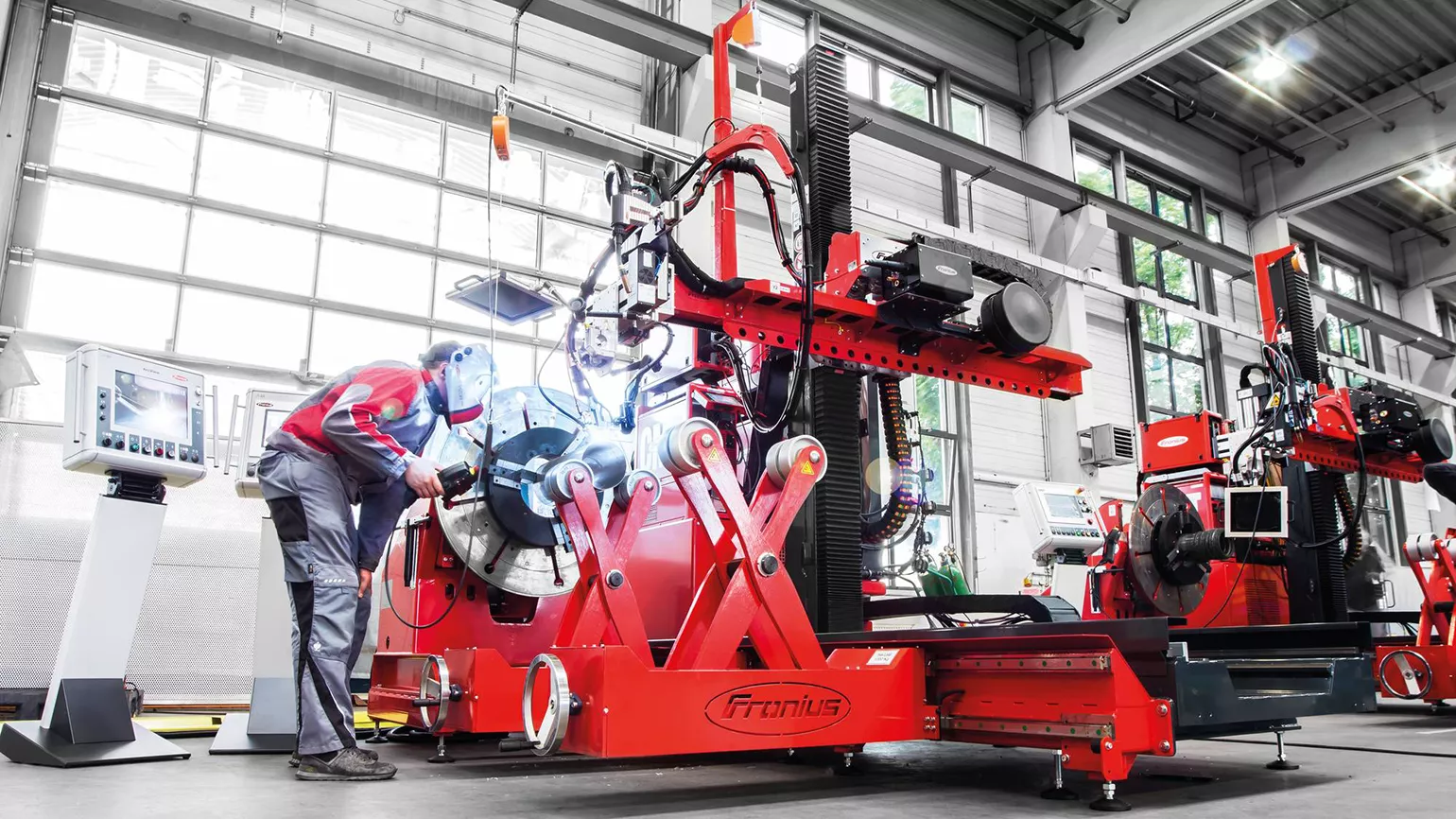

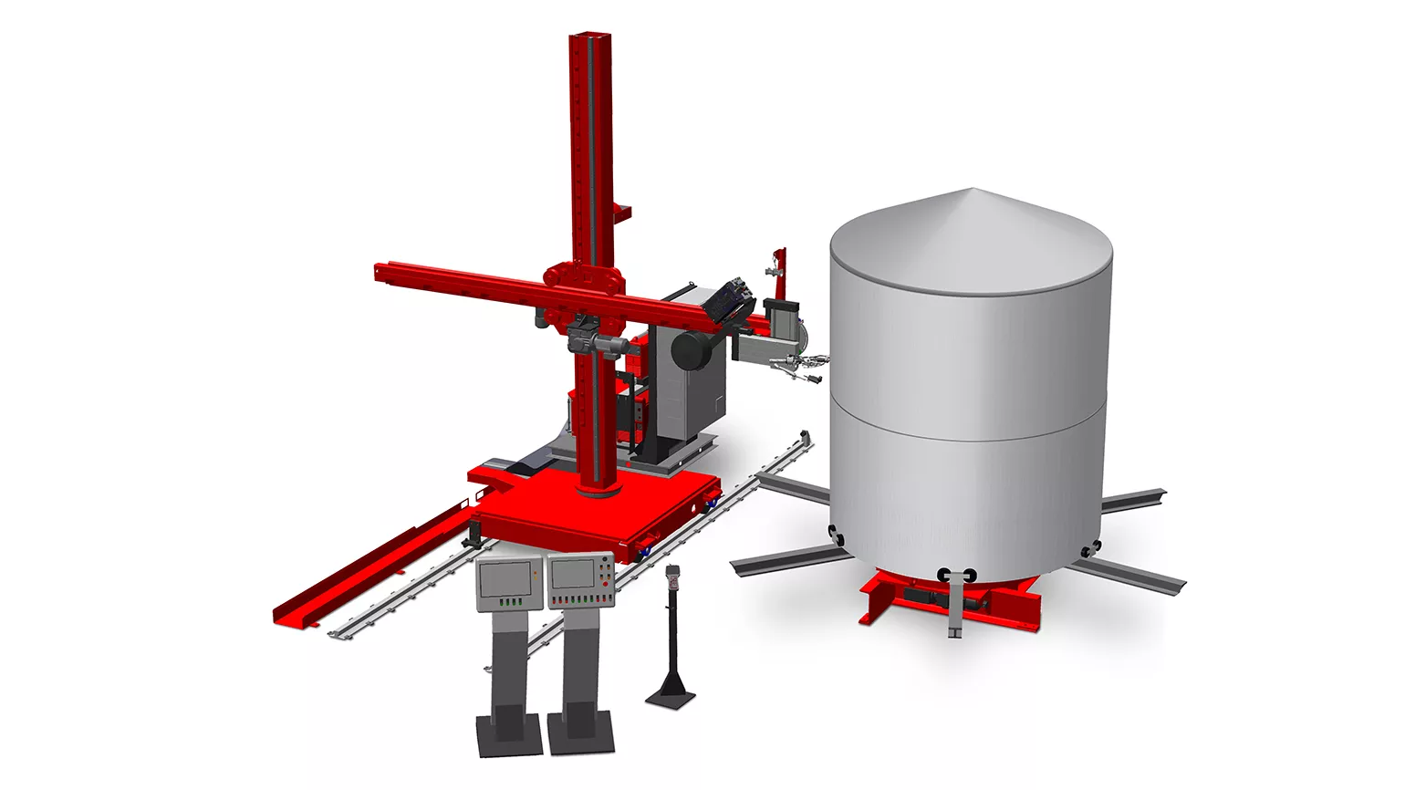

Circumferential welding systems for welding different components, e.g., agitator mixer
FMW Multi welding system
Welding system for circumferential and longitudinal seam welding of different components. Intuitive HMI system controls, remote control, and ArcView camera system for monitoring the weld seam.
Welding processes: TIG, plasma

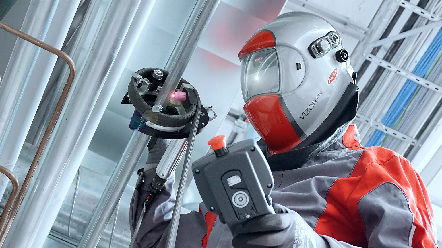

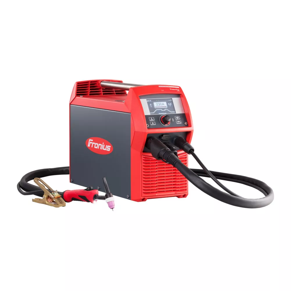

Manual welding in container construction
Typical applications
Welding systems
For manual welding in container construction

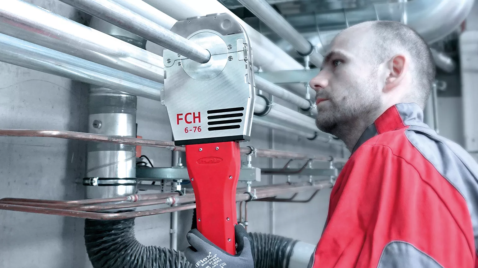

Mechanized welding in pipeline construction
Typical seam connections
Orbital welding systems
Mechanized orbital welding systems for joining pipes and flanges
FCH closed orbital welding heads
More about FCH
FOH open orbital welding heads
More about FOH

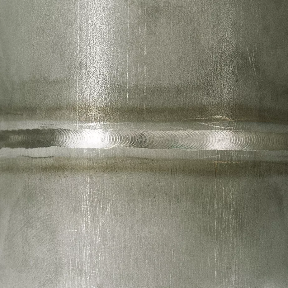

Seam appearance
Of welded joints in container and pipeline construction
