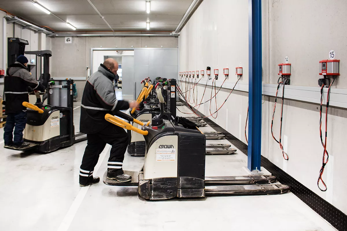

The ambient conditions are particularly tough in cold chain logistics as the goods need to be transported through various temperature zones. Temperatures down to -24 degrees Celsius present considerable challenges for the forklift fleet. Fronius has the perfect solutions for charging traction batteries safely, reliably and efficiently under these extreme conditions.
The ‘delayed charging start’ feature enables users to set their preferred time for charging to start on almost all Selectiva battery chargers. This gives the battery enough time to warm up to near its ‘comfortable temperature’ before charging begins.
Upon request, Fronius can fit its battery chargers with ‘temperature-controlled charging’, which involves fitting a temperature sensor between the cells in the cell case. The innovative Ri-charging process records the battery’s temperature at the start of charging and adapts the charging characteristic accordingly. This extends the battery's service life and makes the entire forklift truck system significantly more cost-effective in the process.
