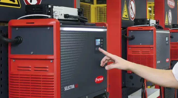

TEMPERATURE-CONTROLLED CHARGING
A temperature sensor enables precise control of the charging process
DELAYED CHARGING START
Users can set a time for the start of the charging process on more or less any Selectiva battery charging system

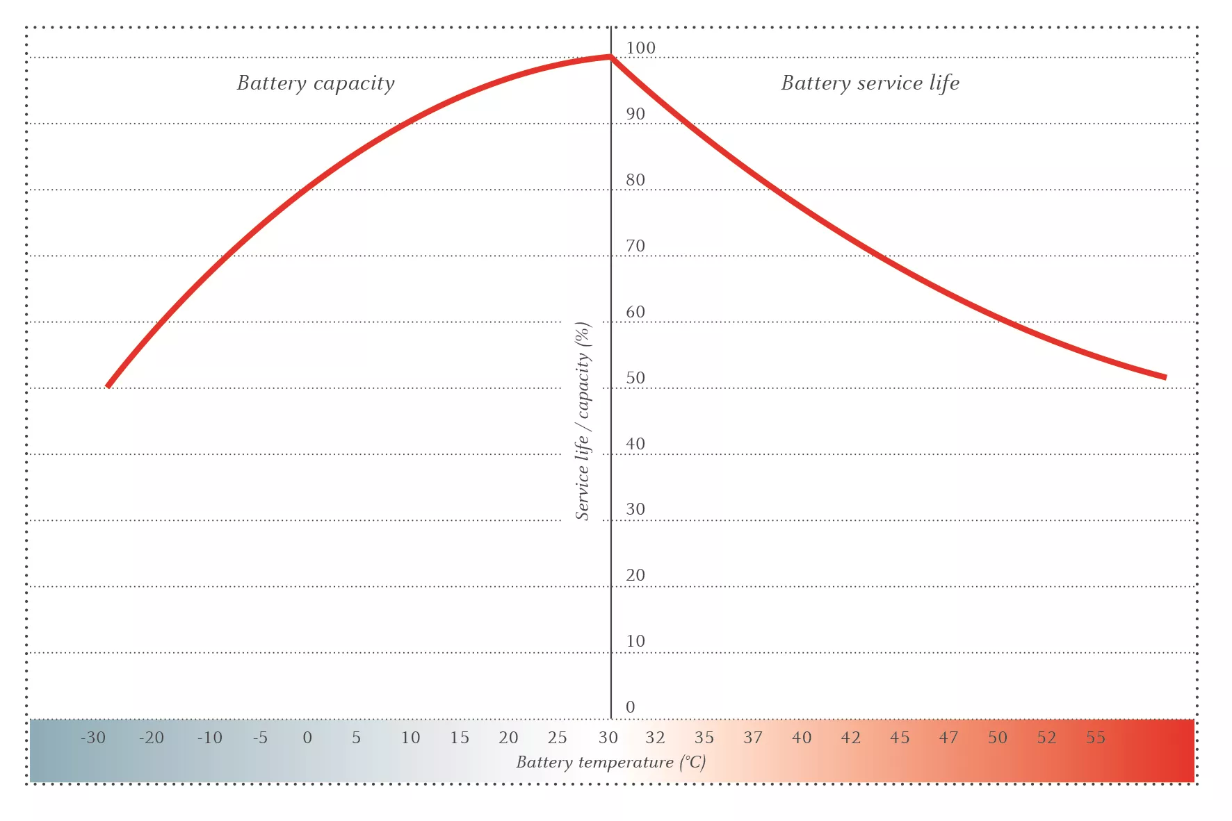

The batteries cool during use and heat up again during charging. The capacity available is largely based on the average battery temperature. The nominal capacity of a traction battery is the capacity that can be discharged at 30°C. At low temperatures this drops significantly.
Fronius can equip battery charging systems with the “temperature-controlled charging” feature on request. This means that a temperature sensor is installed between the cells in the cell case.
When charging begins, the innovative Ri charging process (insert link to Ri charging process) records the temperature of the battery and adapts the charging characteristic accordingly. The user also has the opportunity to set limit values for the maximum and minimum temperature of the battery. If the temperature is close to exceeding this limit value, the charger outputs a warning. If the critical temperature is exceeded, the device stops the charging process so that the battery does not become damaged. This increases the service life of the battery and makes the entire forklift truck system substantially more economical.
