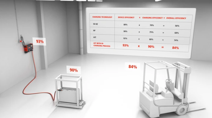

Energy efficiency of Fronius chargers in numbers
