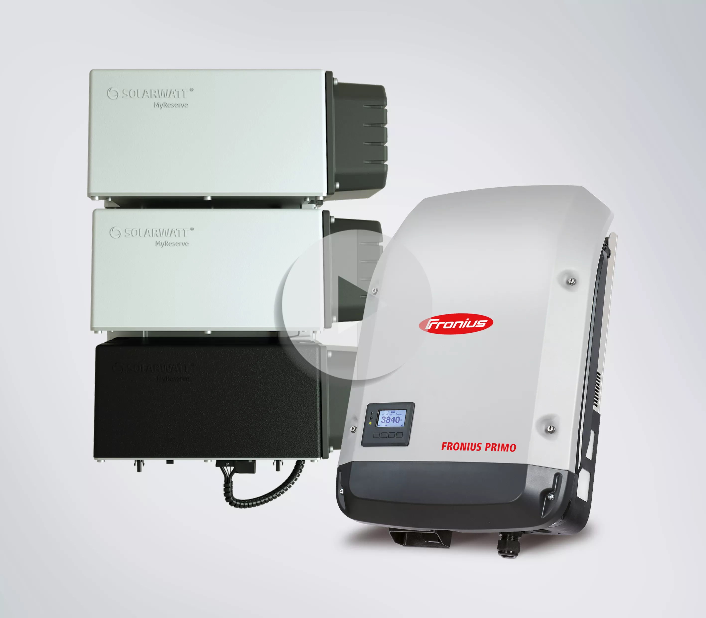

Storage solution for single-phase markets
The local installer opted for a device from Solarwatt with 4.8 kWh to store excessive PV energy.
Fronius Primo, Symo and Eco inverters can be used for systems with PV string-coupled batteries.
Modular design of the battery adapts to the energy demand
One of the advantages of the Solarwatt storage solution is its modular design. If the energy consumption of the family increases, additional storage modules can be installed. This may become necessary following the purchase of an electric car or the conversion of the heating system to a heat pump, for example.
