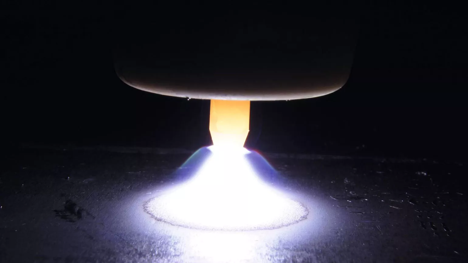

Tungsten inert gas welding, or TIG welding for short, was developed back in the 1940s. An arc burns between a non‑melting tungsten electrode and the metallic workpiece in an oxygen-free, reactionless gas atmosphere. The welder can introduce filler materials to the arc as necessary in the form of rods or wires, which then melt and guarantee the required filling of the weld seam.
OUTSTANDING MECHANICAL AND TECHNOLOGICAL PROPERTIES
Due to the inert protective gas shield, there are no chemical reactions with the liquid weld pool. From a metallurgical perspective, this brings certain advantages. For one, it allows ultrapure weld seams with exceptional mechanical and technological properties to be produced. For special materials or where there are specific weld-seam requirements, TIG welding is therefore the first choice. The process is also characterised by a concentrated and stable arc; a smooth, even and slag-free weld seam; and spatterfree welding behaviour in almost all positions – all essential prerequisites for maximum seam quality.

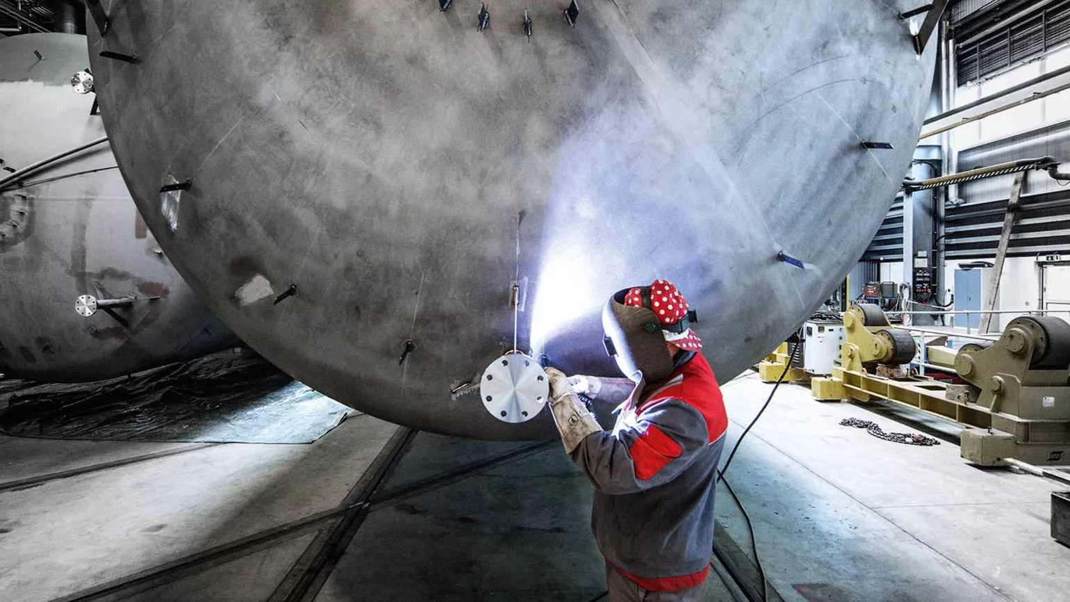

The TIG process is used in areas such as lightweight construction in the automotive industry, where aluminium alloys are commonplace. Manufacturers not only need to weld profiles of different thicknesses together, but also together with sheets to form self-supporting constructions. In railway carriage bodies in particular, profiles of different thicknesses and with numerous sudden changes in the profile thicknesses are often welded in one weld seam, depending on the design. In addition to these high-load weld seams, countless other short weld seams must be produced without start porosity and end-crater cracks: requirements that are best met manually using the TIG welding process.
