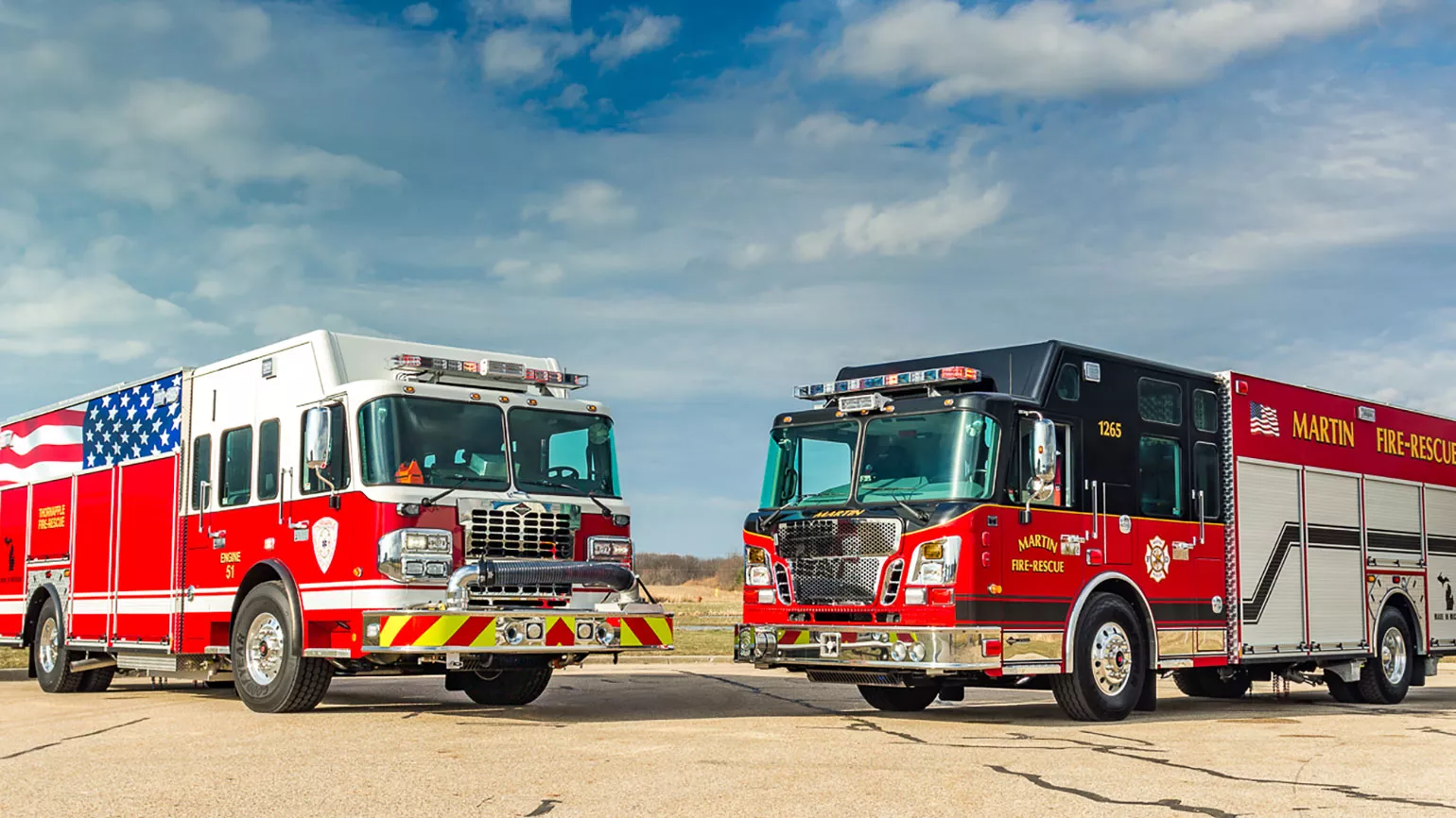

The US-based family business Spencer Manufacturing in South Haven, Michigan, has been building custom fire trucks for almost 30 years. Welding two aluminum sidewalls into position with a solid, paintable edge was taking 16 hours, due to the large amount of rework the material requires. Working with the Fronius TPS 320i Compact reduced the time on this application by 75 percent, allowing the Spencer family to build an extra one to two trucks each year – as well as the occasional blueberry harvester.
Aluminum has a reputation, in the welding industry, for being difficult to work with. Most times, to get a quality weld with solid penetration takes a lot of time in rework. Spencer Manufacturing can tell you a thing or two about this: The family-owned company designs and builds 20 to 25 customized fire trucks per year for municipalities across the US. It has clients as far away as Alaska and as close as their backyard in southwestern Michigan. Every vehicle is designed to fit the customer’s individual specifications. On a fire truck, nearly every square inch has to be functional, by housing firefighting gear and controls. Spencer has customized items as small as tool brackets up to changing the configuration of access so that no one has to step up onto the truck in order to reach for ladders and gear.
Beginning with a 3-D digital model, the frame is configured to the proper specification. Each piece of extruded aluminum tubing is cut and welded in-house. Next, the sidewalls are attached. This step presents the weld radius that has caused so much time in rework: where the sidewalls attach to the frame. On a flat surface, any pits in the weld could be filled in and painted over but, here, any type of filler would flake off with usage and weather. This edge has to be solid metal.
With the MIG equipment Spencer previously used, the actual welding took only minutes compared to the hours of grinding, routering and sanding to get a solid, paintable corner. “One truck, two walls, used to take 16 hours,” said Grant Spencer, head of the company.
Even with all this work, the company wasn’t highly confident about each of those welds. With the Fronius TPS 320i Compact welding system, however, Spencer has been able to reduce the time on this one application by 75 percent.
