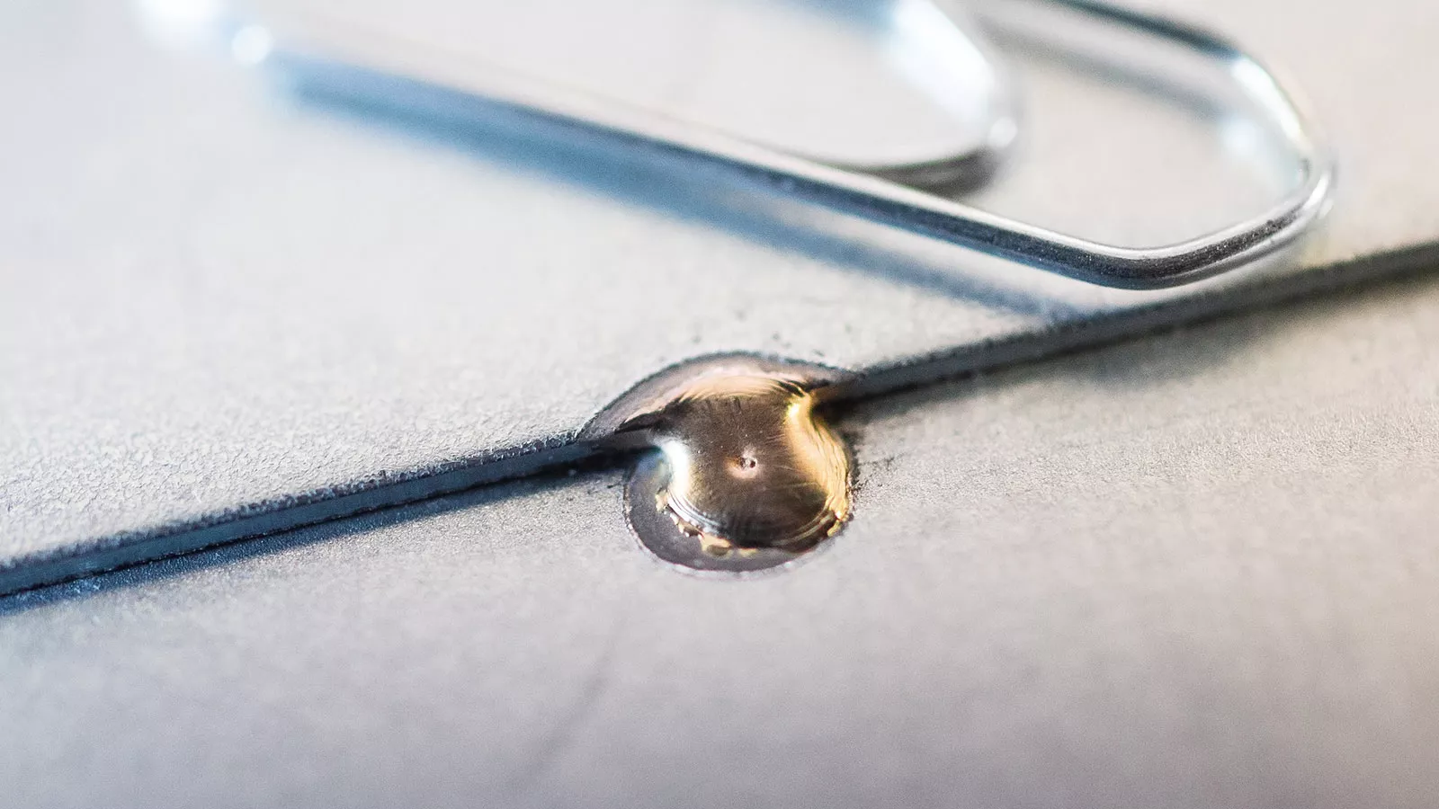

With Cycle Step, users now have the opportunity to control these cycles in detail. Both the exact number of droplets per welding spot and the pause time between the individual cycles can be precisely defined. The welder can therefore produce spots of any size and reproduce them precisely – a totally new level of control over the welding process.

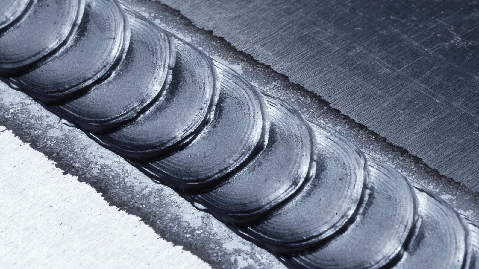

IDEAL FOR HIGH-QUALITY VISIBLE SEAMS
Heat input is also minimal with Cycle Step, and can be effectively controlled. This allows even the thinnest of metal sheets to be joined and is particularly useful for position welding with gap tolerances. The defined welding cycles also ensure visually perfect seams with clear rippling, without reinforcement or spatter, making Cycle Step ideal for high-quality visible seams. The process variant also enables the smallest fixation points to be welded and is therefore an alternative to spot welding guns. Even fine overlay welding and applications in additive manufacturing can be implemented with Cycle Step.

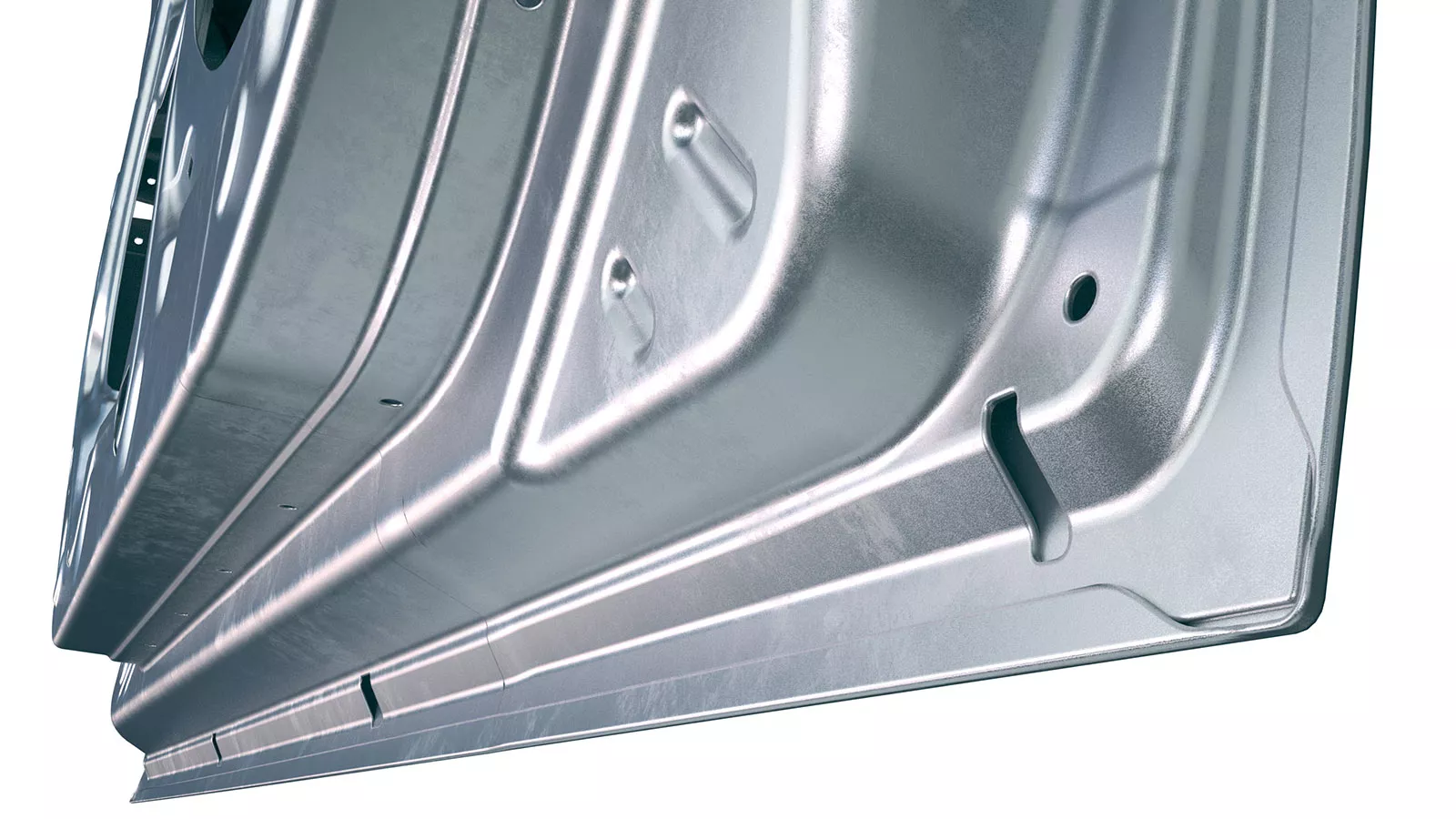

In the automotive industry, Cycle Step is already being successfully used in body construction, namely for fixing the so-called folding flanges of front hoods and tailgates, as well as doors. Galvanized sheet steel parts that used to be bonded together are connected by individual fixation points. This saves time during production, as the components can then be painted immediately, without first waiting for the adhesive to cure. Strictly speaking, this process is not a welding operation, but is instead a form of brazing. The spots consist of a copper silicon alloy, which is applied to the joint using Cycle Step. Before being painted, they are usually covered in PVC, so that they are no longer visible later on.
COST-EFFECTIVE, SPACE-SAVING AND VERSATILE
Manufacturers have strict demands: the fixation points must be as small as possible and extremely flat, but the sheet metal parts must nevertheless be firmly and securely connected. As hoods, tailgates, and side doors are visible bodywork components, the process must also be as spatter-free as possible. With the new Cycle Step process variant, the perfectly coordinated brazed joints ensure durable and visually perfect metal sheet fixation until the adhesive has cured in the paint oven. The investment costs are far lower than for the welding process previously used, and because the welding system does not require much space, users can operate far smaller production cells. The welding process is suitable both for steel and aluminum sheets, and is therefore highly versatile.
