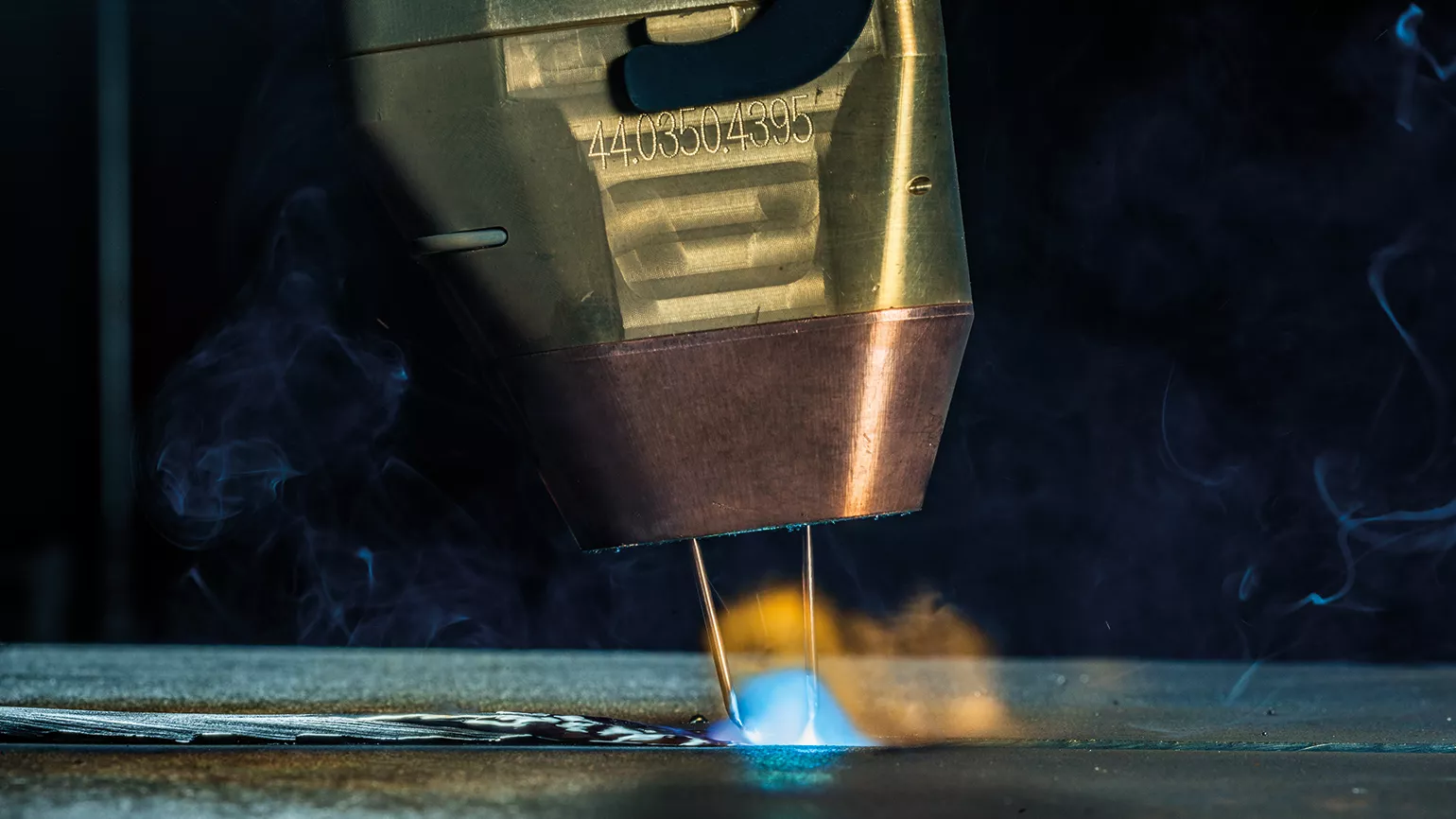

The TWIN process is based on tandem welding and features two wire electrodes that are fed into a welding torch with a single gas nozzle but that remain electrically isolated from one another. As a result, the arcs can be controlled independently and, despite differing outputs, can be precisely synchronised and coordinated. In addition to two TPS/i power sources, the TWIN Push system requires a TWIN Controller. The controller synchronises the welding process and acts as an interface that is compatible with all robot makes. The compact wirefeeder, cooling system, hosepack, and TWIN welding torch complete the welding system.
