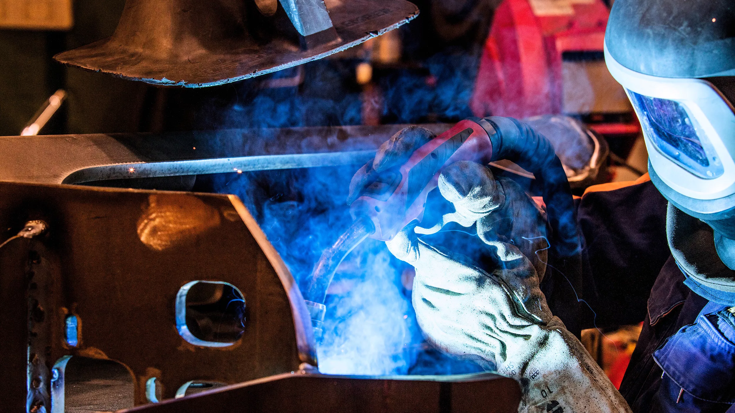

Challenge
Long weld seams, several weld layers and a high deposition rate - at a high welding speeds
Joining heavy components in the Yellow Goods industry represents a particular challenge. Huge components and extremely thick materials are an everyday occurrence – take, for example, a one-and-a-half-meter long heavyduty axle made from steel up to 50 millimeters thick.
The weld seams must withstand high forces and meet stringent quality criteria. The weld seam appearance also plays an important role. Compared to other welding sectors, greater component tolerances and gap-bridging ability are required in the Yellow Goods sector.

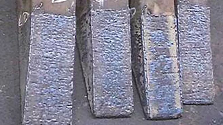

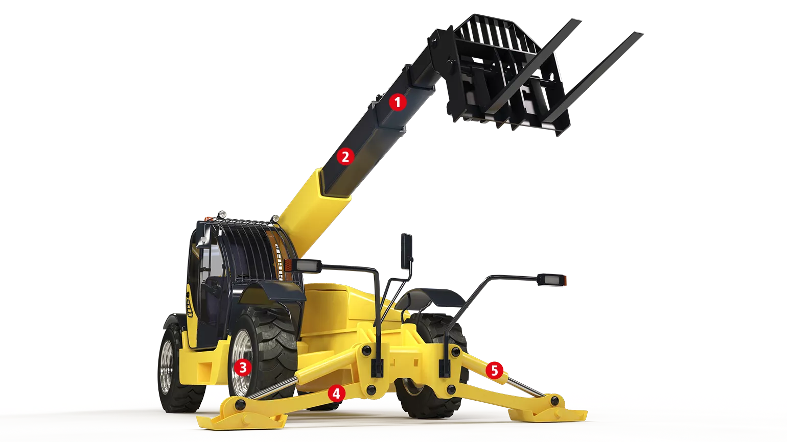

Excavator
Overlay welding
Challenges
- High deposition rate
- Robust equipment
Solution
TPS 600i single wire
- Welding speed: 60 cm/min
- Deposition rate: 8 kg/h

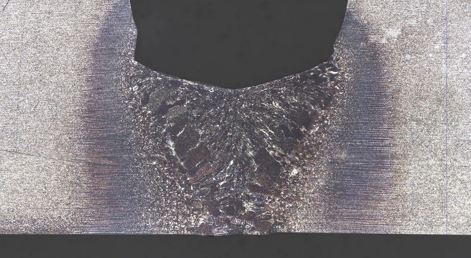

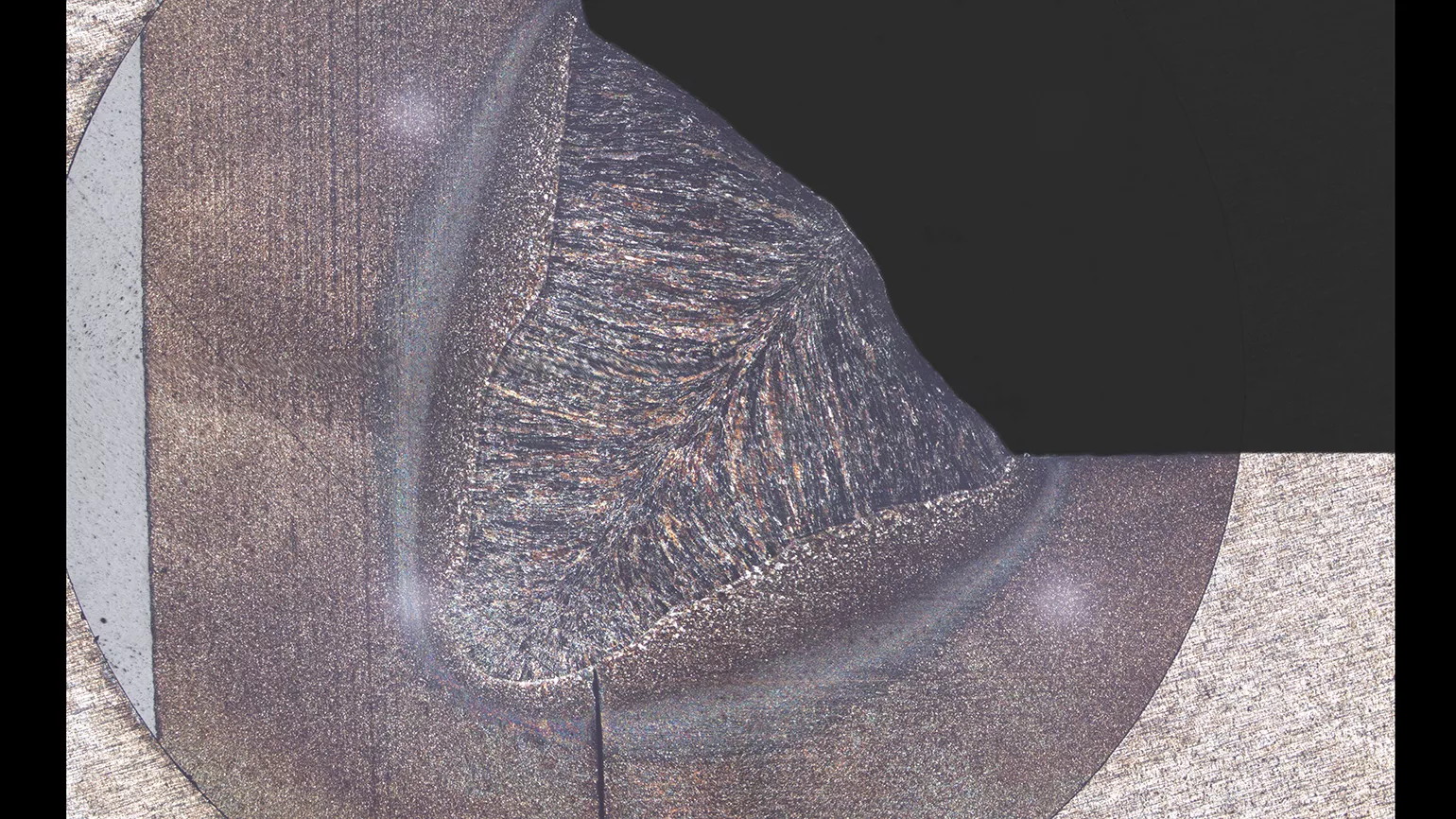

Circumferential weld
Challenges
- Deep penetration
- Low heat input
- Little welding spatter
Solution
TPS TWIN CMT
- Material thickness: 10 mm
- Deposition rate: 12 kg/h

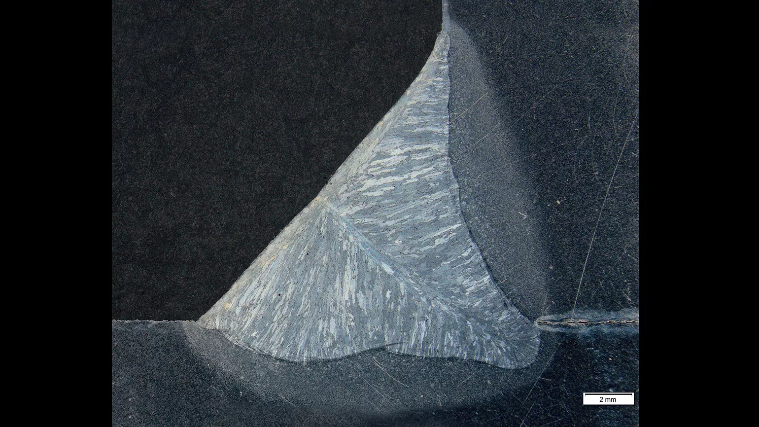

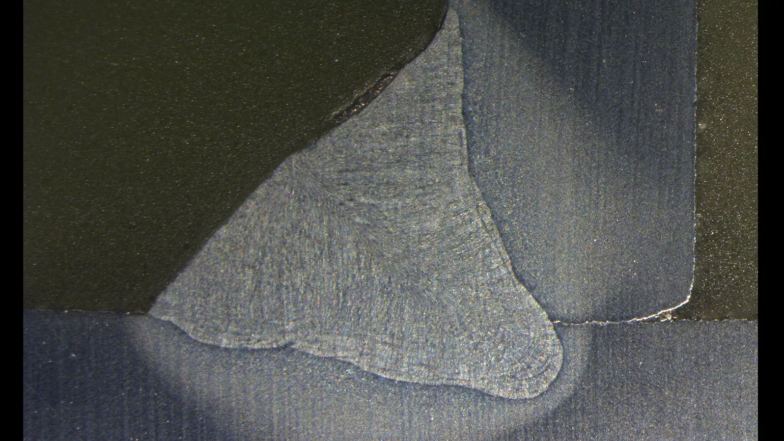

Fillet weld
Challenges
- Welding speed
- Low-spatter
Solution
- Welding speed: 25 cm/min
- Deposition rate: 11 kg/h

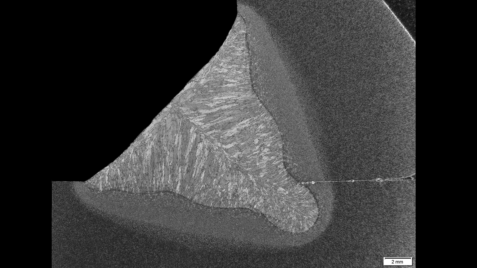

Fillet weld
Challenges
- Deposition rate
- Welding speed
- Gap-bridging ability
Solution
TPS/i TWIN Push
- Material thickness: 15 mm
- Deposition rate: 18 kg/h

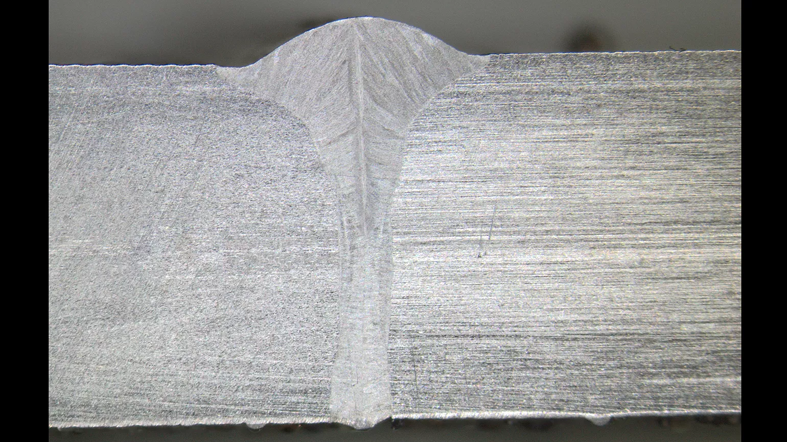

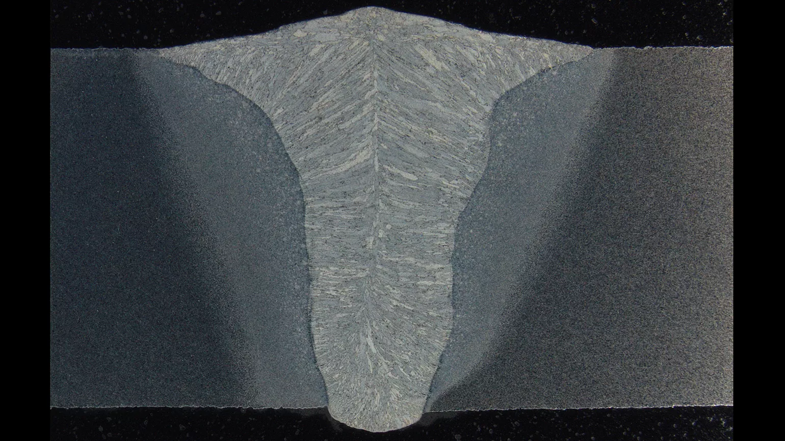

Butt weld
Challenges
- Deep penetration
- Single-pass welding
Solution
TPS/i TWIN Push
- Deposition rate: 20 kg/h
Challenges
- Stable ignition
- Robust welding torch
- Interval welding
Solution
TransSteel 3500
Telescopic Handler
Fillet weld
Challenges
- High welding speed
- Low heat input
Solution
TPS TWIN CMT
- Material thickness: 8 mm
- Welding speed: 150 cm/min
- Deposition rate: 13 kg/h
Butt weld
Challenges
- Horizontal position
- Single-layer welding
- No backing
Solution
LaserHybrid
- Material thickness: 6 mm
- Welding speed: 180 cm/min
- Deposition rate: 4 kg/h

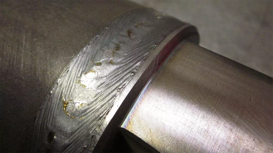

Challenges
- Low-spatter
- High-quality weld seam appearance
- Excellent gap-bridging ability
Solution
TPS/i TWIN Push
- Welding speed: 100 cm/min
- Deposition rate: 22 kg/h
Fillet weld
Challenges
- Stable ignition
- Robust equipment
Solution
TransSteel 5000
Root pass
Challenges
- Optimum weld seam quality
- No pores
- Start-stop overlap
- Root pass
Solution
ArcTig
- Material thickness: 10 mm / 5 mm root face

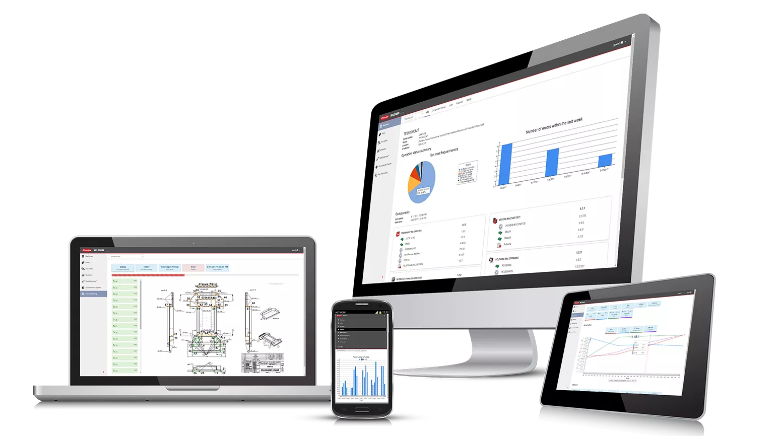

Production Monitoring with WeldCube.
One piece of software - all power sources at a glance.
Process and cost optimization are of central importance for the automotive and supplier industry, and the documentation of production data is an important key to achieving this. With WeldCube from Fronius, you can continuously record and analyze the welding data of all power sources on all production lines.
The result: greater transparency, safety and verifiable weld quality for your series production.
How data analysis improves the world of welding!
Fronius has developed the WeldCube documentation and data analysis system. As a result, welding processes can be optimized and errors avoided.Global sales and service network
