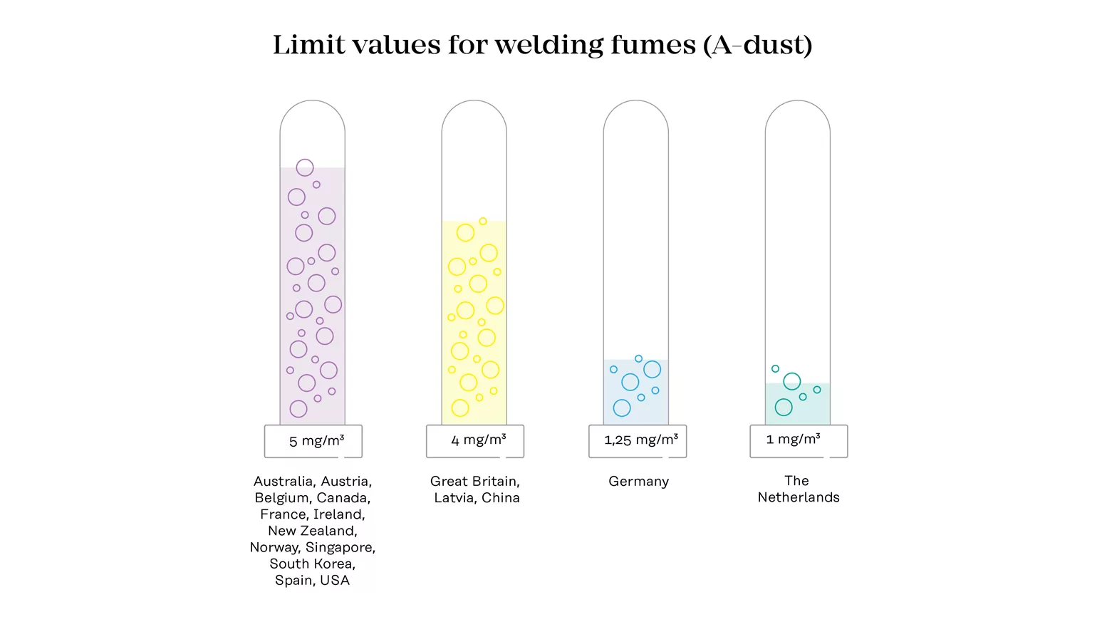

Limit values
Some countries have introduced limit values for A particles. These values vary from one country to another. The Netherlands have set a limit value of 1 mg/m3, which is the strictest limit. In countries such as Australia, Austria, or the USA, the limit value is 5 mg/m3.

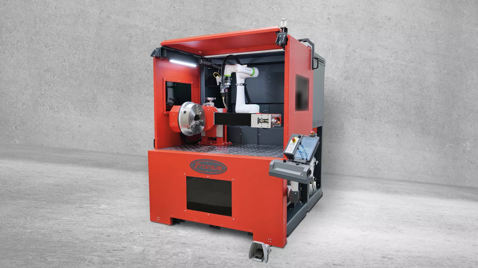

Automated welding
The latest developments make automated welding cost effective even from batch sizes of 1. Examples include cobot welding cells with glare protection and extraction. They are intuitive to operate, do not require any programming knowledge, and, on top of this, enable rapid clamping and changeover of components. This type of closed welding cell provides effective protection against UV radiation and welding fume.
