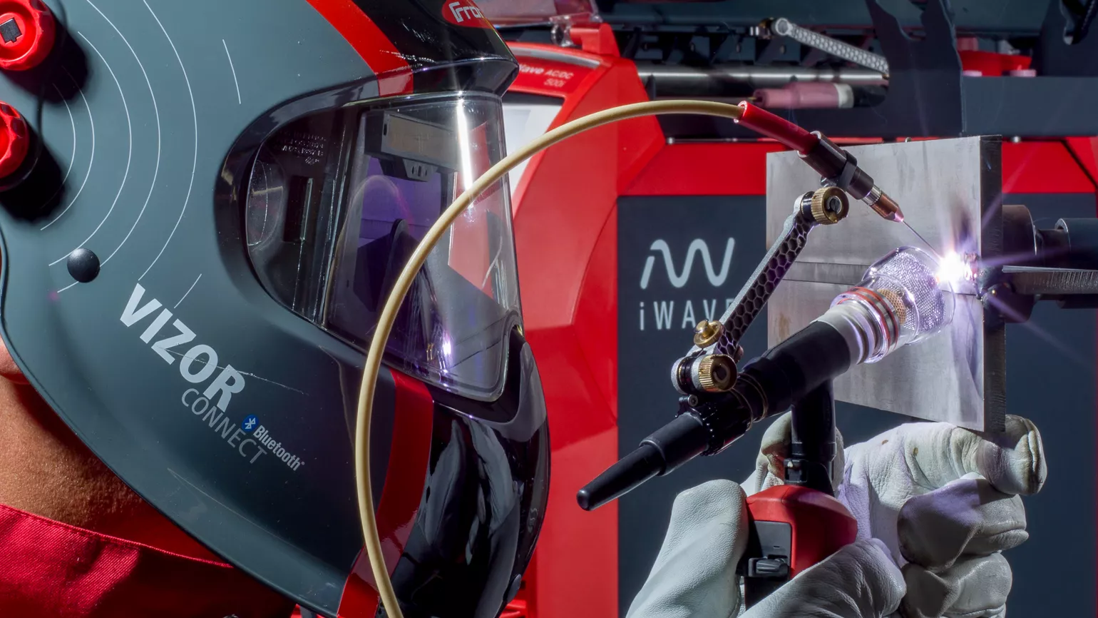

The innovative advantage of Fronius DynamicWire compared to a conventional continuous wirefeed lies in its automatic self-regulation. The welding system actively adjusts the wire speed to the welding behavior, torch position, and current conditions, even compensating automatically for component tolerances of up to 30 %.
The result? Perfect welds every time.
It is now easy even for amateurs to create perfect TIG welded seams, thanks to the intelligent, dynamic wire control, which is a groundbreaking innovation in cold wire TIG welding. This maintains the right travel speed and thus adapts the welding process to the operator, rather than the other way around!

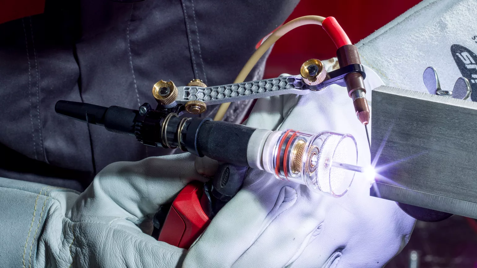

During development of the cold wire system, no detail was too small for us when it came to ensuring that welders could work optimally with minimal steps and adjustments. The wirefeeder only has to be set once, after which it remains in a stable position. The ergonomic and flexible holder is particularly lightweight as it is produced using material-saving aluminum 3D printing. There are also no disturbing vibrations at the torch handle, as (unlike with comparable solutions) the mechanical forward and backward motion of the wire has been dispensed with entirely with the new TIG DynamicWire.

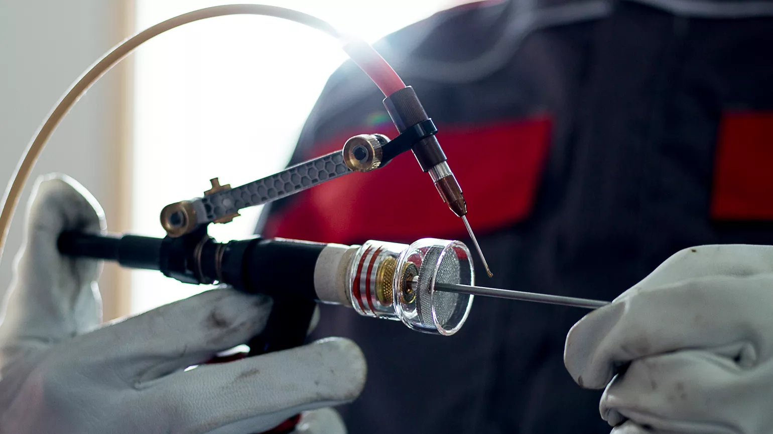

With the Tungsten Fast Clamp System (TFC), all it takes is a single push of a button to loosen and clamp the tungsten electrode in the spring-loaded clamping sleeve. Similar to a mechanical pencil, the electrodes can be changed in a few seconds. Plus, you can also now install this system on existing torch bodies.

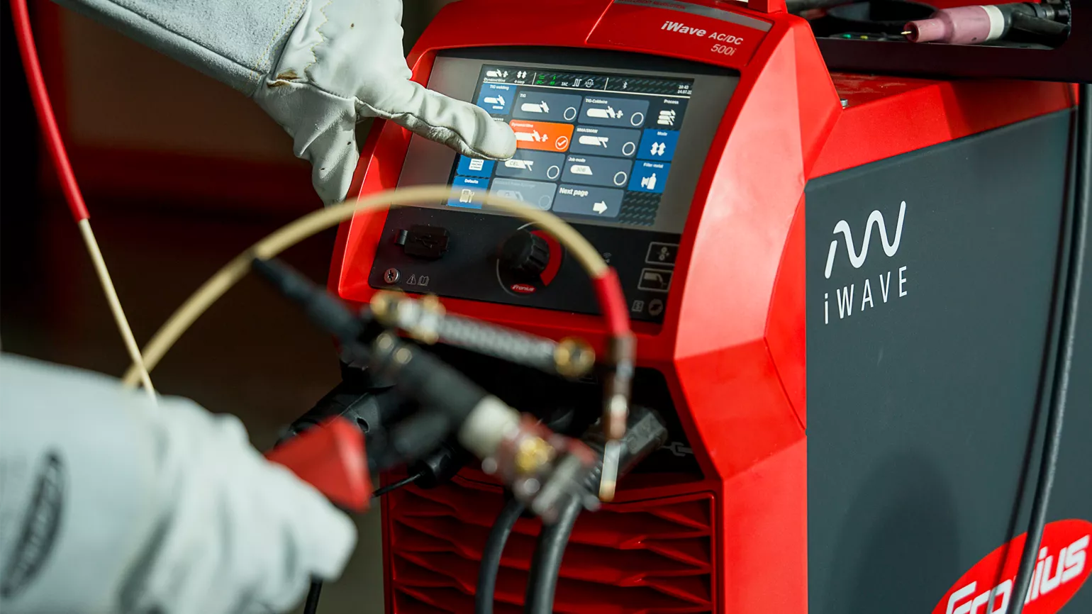

The iWave power categories from 300i to 500i can be upgraded to the cold wire TIG system. The Welding Package TIG DynamicWire is ready for use immediately by means of software activation and can also be retrofitted to existing iWave systems at any time.
