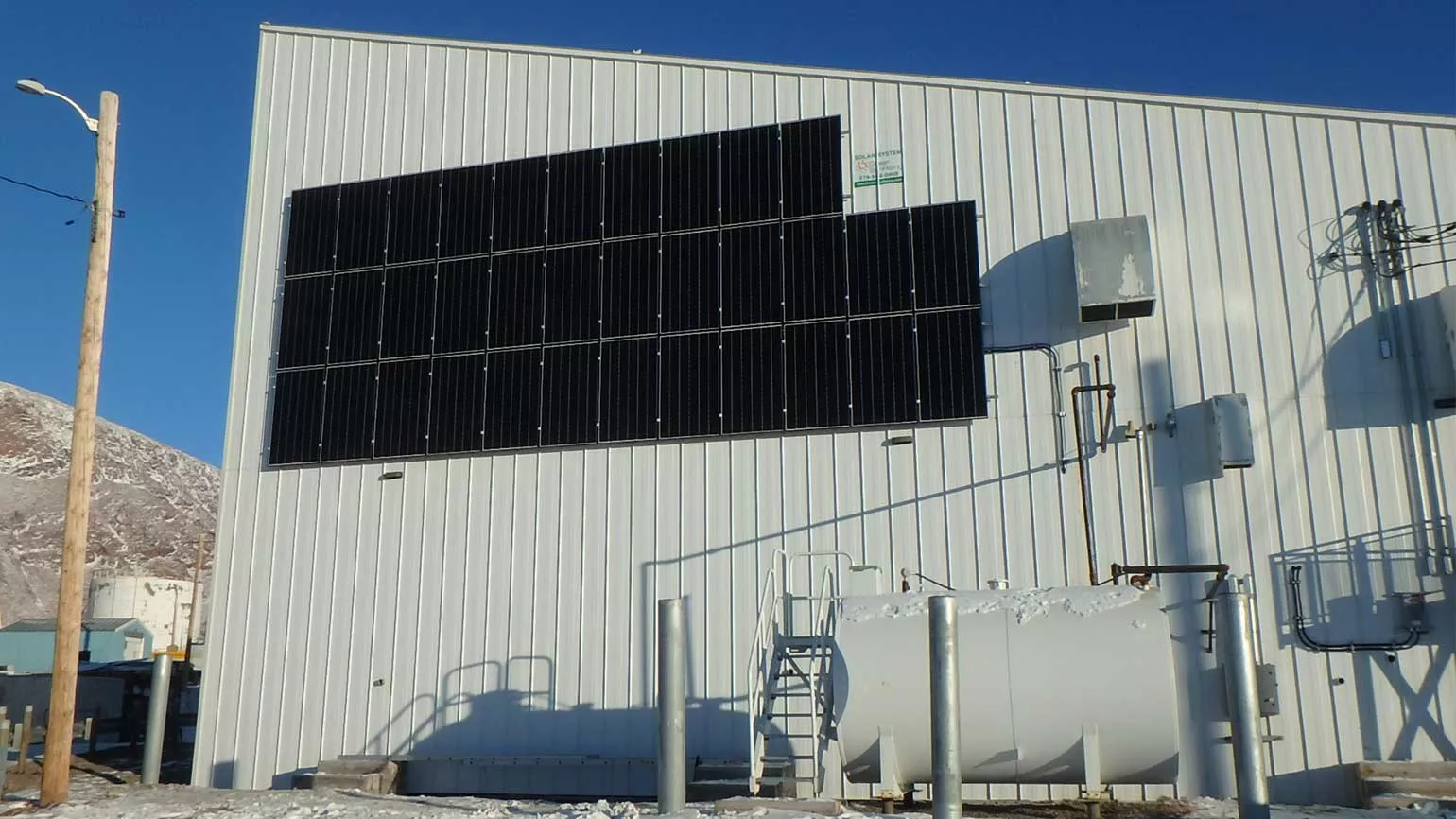

The logistics of coordinating the arrival of both personnel and materials on site were quite involved. Even in good weather, it takes at least three days and six flights to reach Grise Fiord. The township therefore entrusted the solar power project to Green Sun Rising, a Canadian installer with experience in these latitudes. The installer was able to master the challenge by bringing all the system components, including a Fronius Symo 10.0 inverter, to the installation site without a hitch.
Non-stop solar power production
Once on site, the PV system was punctually brought online.  The installation withstands the extreme weather conditions and generates almost 10,000 kWh per year. Although transport costs at least doubled the overall cost of the PV system, the amortisation period is only six years. This is achieved by the impressive system efficiency during the summer months: the sun does not set in Grise Fiord for around two months. The PV system therefore continuously generates solar power and achieves a particularly high level of productivity.

Size of system  10 kW DC
Fronius components  Fronius Symo 10 208 - 240
Annual yield  9,800 kWh
CO2 savings /year  2,665 KG
