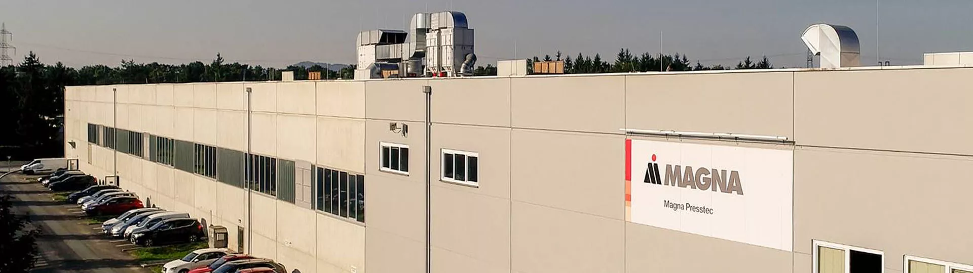

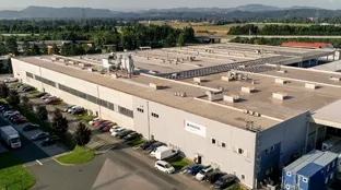

The Austrian company Magna Presstec GmbH is part of the COSMA (Body and Chassis) group of companies within the Magna concern. With a total of 1200 employees, Presstec is pressing ahead to shape the future of the automotive sector: The main focus of this tier 1 supplier is the production of high-quality chassis and structural components made from aluminum and steel. One of its prestige projects is the production of the frame for the legendary Mercedes G at its site in Lebring in southern Austria.
