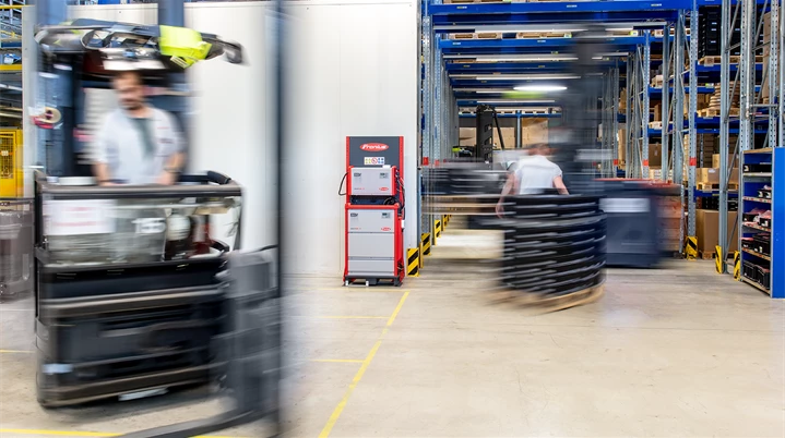

The charging infrastructure is centrally located at the site.  The charging infrastructure is placed in decentralized locations along the flow of goods.

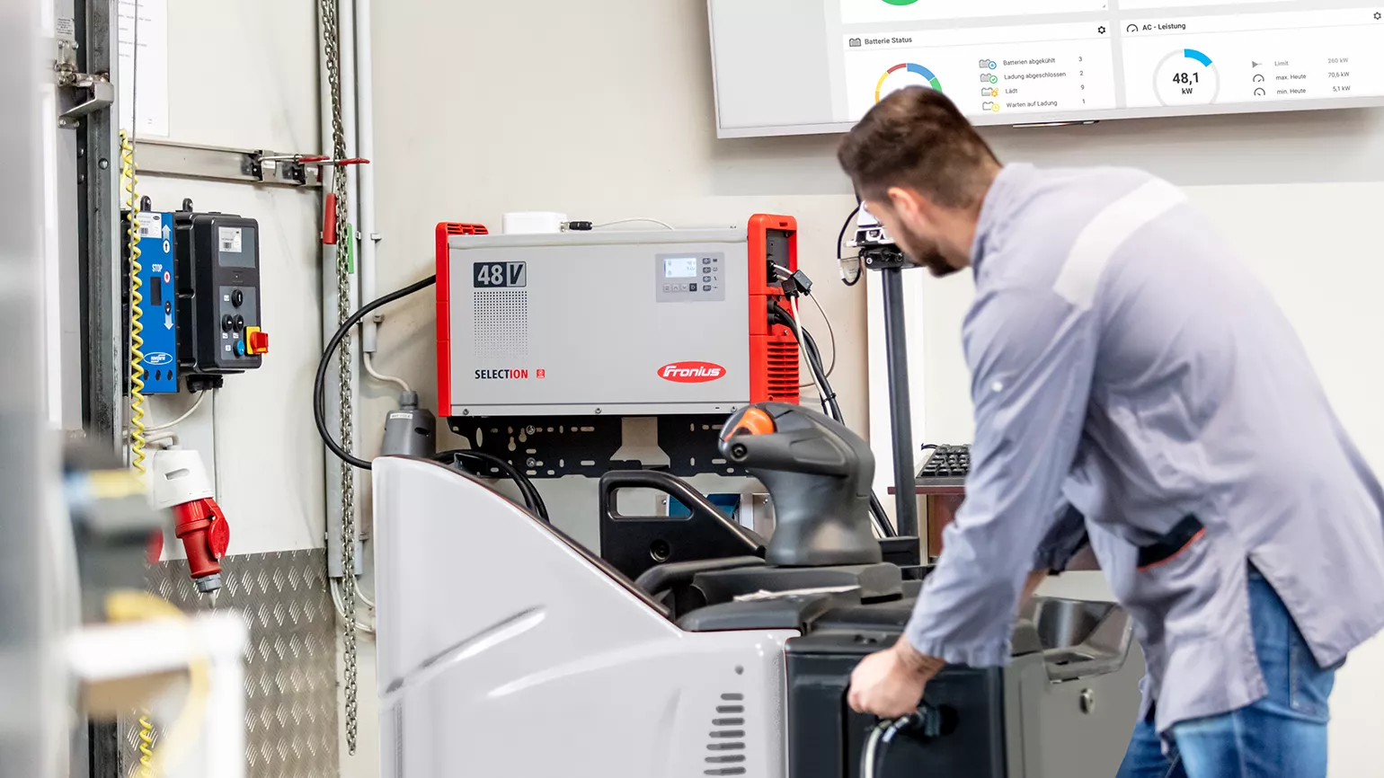

A man is connecting a forklift truck to a SelectION lithium-ion battery charger for charging.
Forklift truck getting connected to the SelectION lithium-ion battery charger.
Keep charging, stop changing. Unlike lead-acid batteries, lithium-ion batteries remain directly in the forklift truck during the charging process and are charged via a plug connection. The charging process in multi-shift operation is characterized by frequent fast and opportunity charging of the lithium-ion battery - for example during the lunch break. Removal of the battery from the forklift truck - as is the case with lead-acid batteries - is not necessary. The required charging infrastructure for lithium-ion batteries can therefore be placed flexibly and in a space-saving manner along the flow of goods. In combination with our flexible EnergyHub, you can also relocate the charging process to the outside area, thus providing additional space and safety.
