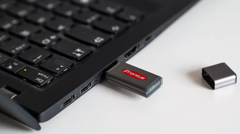

  1. Simply plug the USB flash drive into the back of the welding system (included with the Easy Documentation option)
  2. Check the time and date
  3. "doc | on" is displayed on the control panel

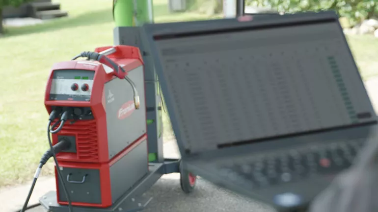

  4. From now on, your welding data will be saved as a CSV file with a Fronius signature
  5. Simply transfer data via USB flash drive, generate a PDF report and check the authenticity of the data using the Fronius signature
