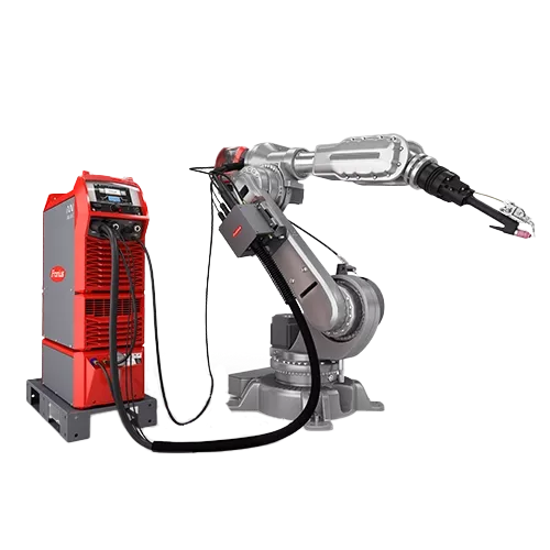

iWave for automated welding solutions
iWave—The all-rounder in automated welding

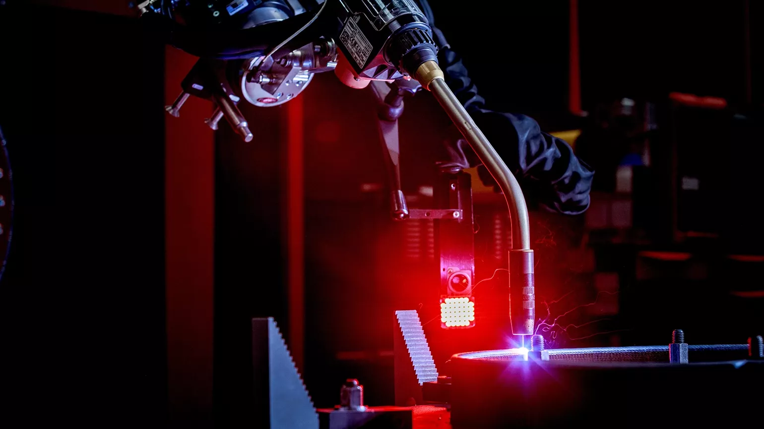

DynamicWire
iWave Automated Torch
Active wire control—automated TIG cold-wire welding made easy
Despite its advantages, automated TIG cold-wire welding presents various difficulties. Finding the right welding parameters is a key challenge. With DynamicWire, you only have to set one parameter: the rest are stored using material-specific characteristics.
The innovative advantage of Fronius TIG DynamicWire compared to conventional continuous wirefeeding in cold wire systems lies in its automatic self-regulation. The welding machine actively adjusts the wire speed to the current conditions. Air gaps of up to 30%* can be welded with DynamicWire—previously almost impossible with cold wire TIG welding.
More about TIG DynamicWire
iWave Automated DynamicWire
The TIG DynamicWire Welding Package can be quickly added to automated iWave systems with a cold-wire feed from 300i-500i. Simply activate the software and get welding!
The result? Perfect welds every time. Existing iWave cold-wire systems can be easily upgraded with the patented TIG DynamicWire Welding Package through software activation.

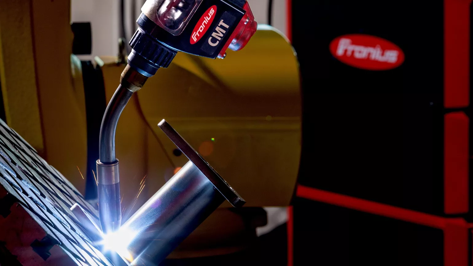

Fronius Additive
CMT Additive Pro
Thanks to its revolutionary reversing wire movement, the CMT process is extremely stable, making it a perfect solution for additive manufacturing. This means that the layers can be built up spatter-free, consistently, and evenly.
We developed the CMT Additive Pro welding characteristics specifically for additive manufacturing. They make it easy to achieve a reproducible uniform layer structure, as well as deal with other challenges.
With the iWave 300i-500i series, the Multiprocess PRO option, and the CMT Welding Package, we offer a complete solution for additive manufacturing. The perfectly tuned equipment is compatible with all conventional robot systems thanks to suitable interfaces.
Find out more
CMT AC
Our solution for even lower heat input during MIG/MAG welding
The CMT AC process achieves a remarkably low heat input with the same deposition rate by reversing the wire movement and the polarity of the wire electrode. With this technology, you can easily adjust the positive and negative components with the help of correction parameters and thus achieve extremely precise control over the heat input.

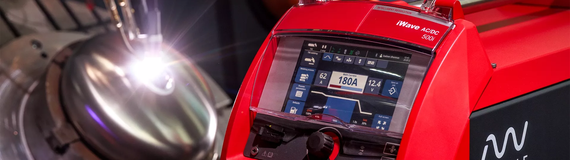

Ignition
Ignitions
Stable and reproducible
iWave takes TIG welding ignition behavior to a whole new level. The high frequency ignition process has been optimized and the ignition behavior adapted to the different electrode diameters.
RPI auto*—ignition delays reduced by up to 71%**
Are you looking for a faster ignition process that is fully reproducible—regardless of the material characteristics involved? If so, iWave offers an off-the-shelf solution in the form of RPI auto. The new ignition mode is the next logical step in the development of the proven “RPI on” function. The welding machine now makes changes to the ignition settings automatically, including when it’s necessary to counter deteriorations in ignition—and without any need for manual intervention.
