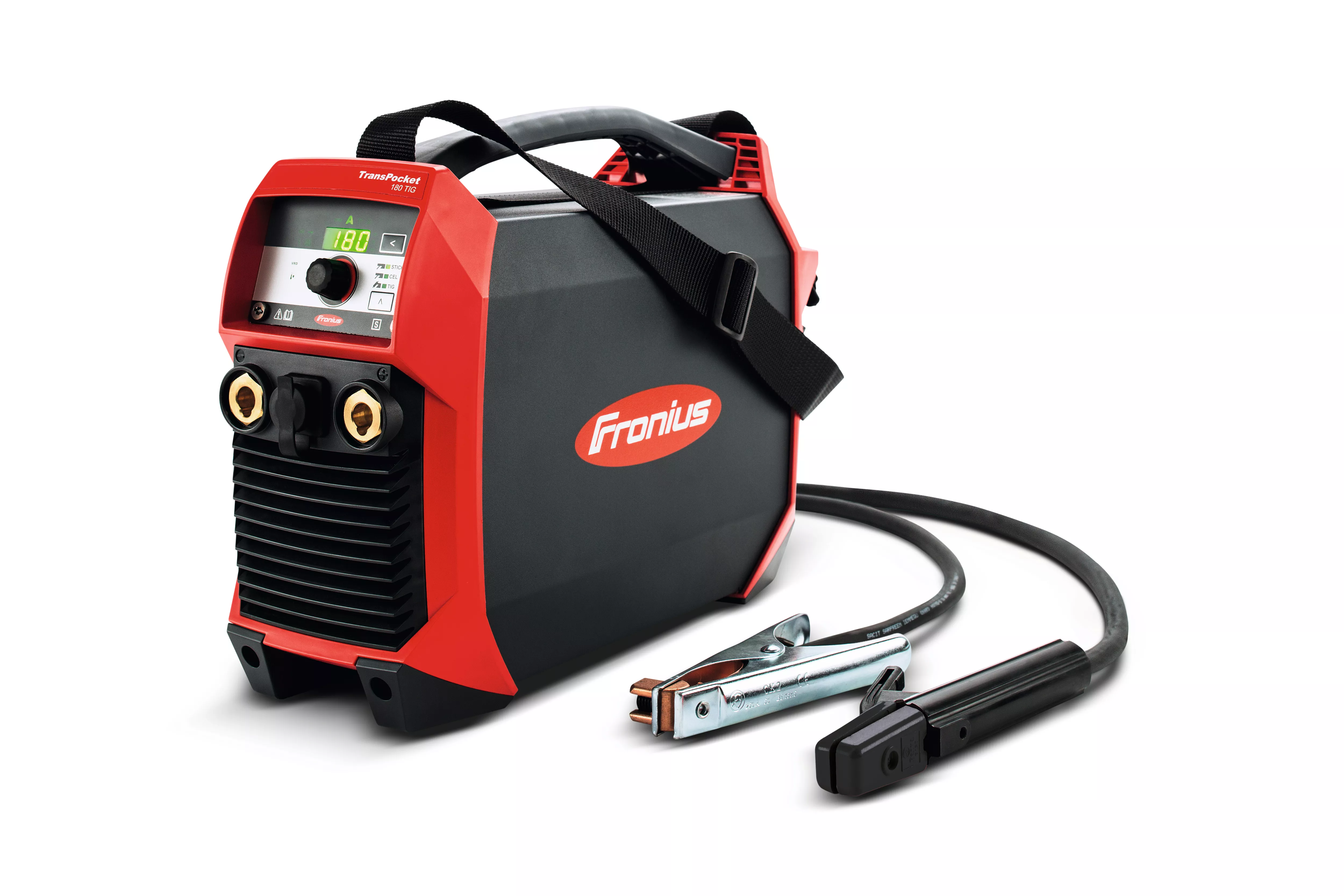

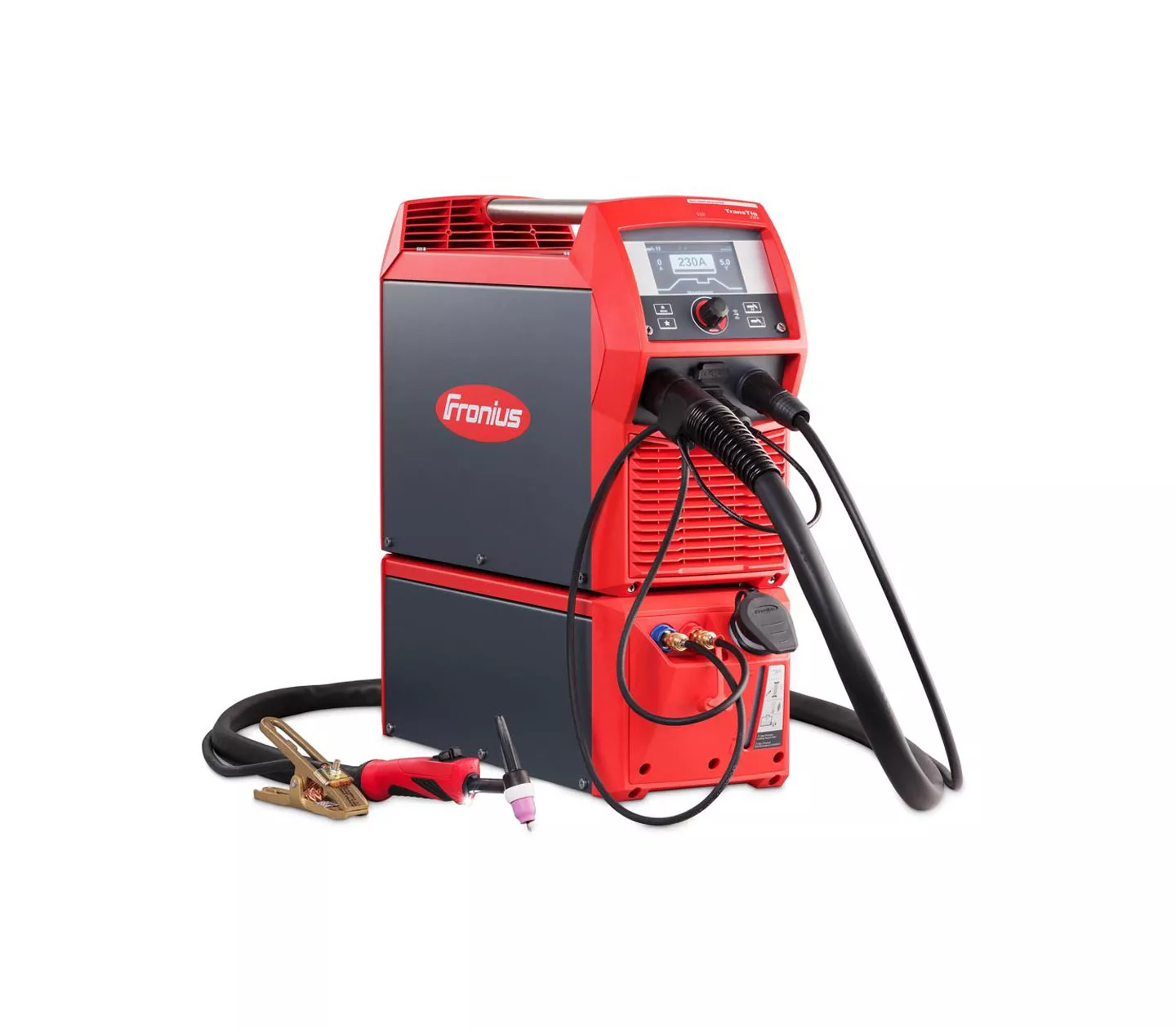

AccuPocket
AccuPocket is a grid-independent, portable electrode welding system that can also be used for TIG welding tasks.

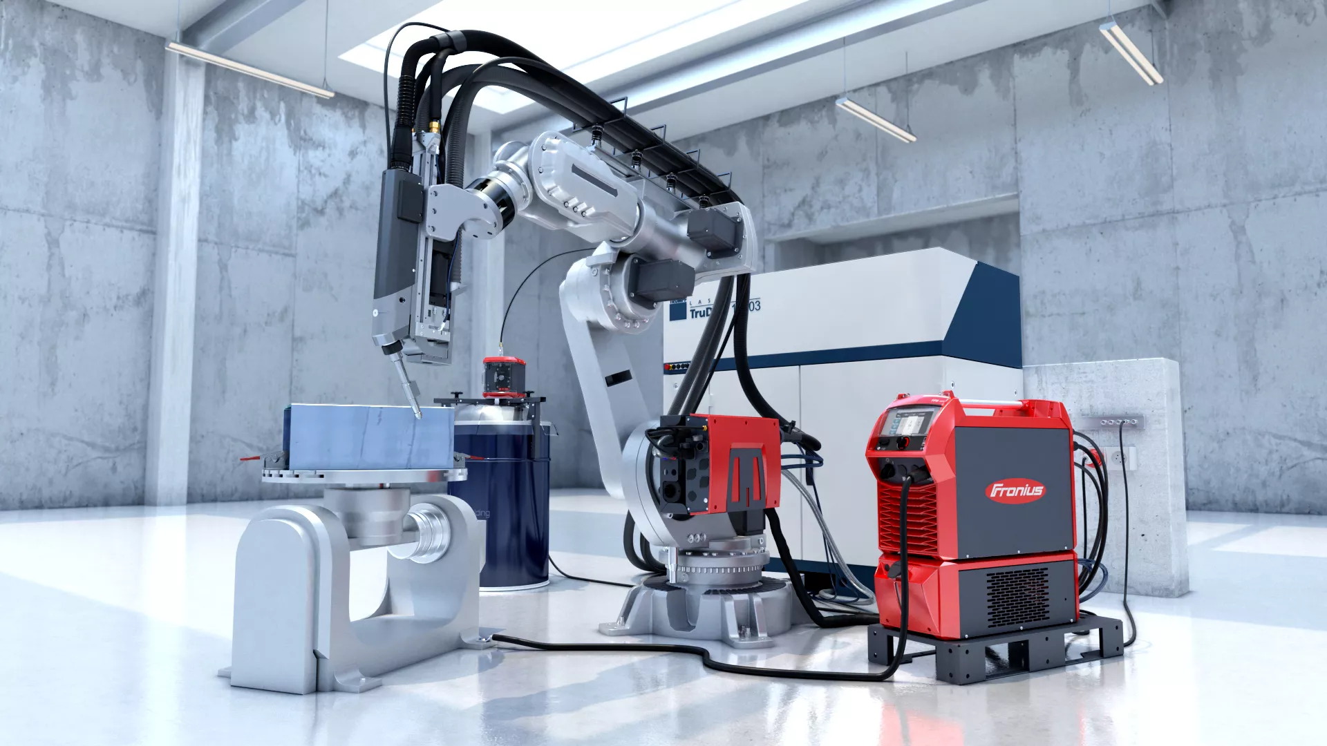

Additive manufacturing
Additive manufacturing processes are all based on the same basic principle: a component is created by joining volume elements on top of one another or together in layers (filler metal). The parent material, which can either be in powder form, a fluid, or also a solid material (wire), is hardened by introducing energy. Complex geometries and components can therefore be manufactured without the need for tools. Conventional production would otherwise not be possible or would be very costly.
More information on Fronius Additive

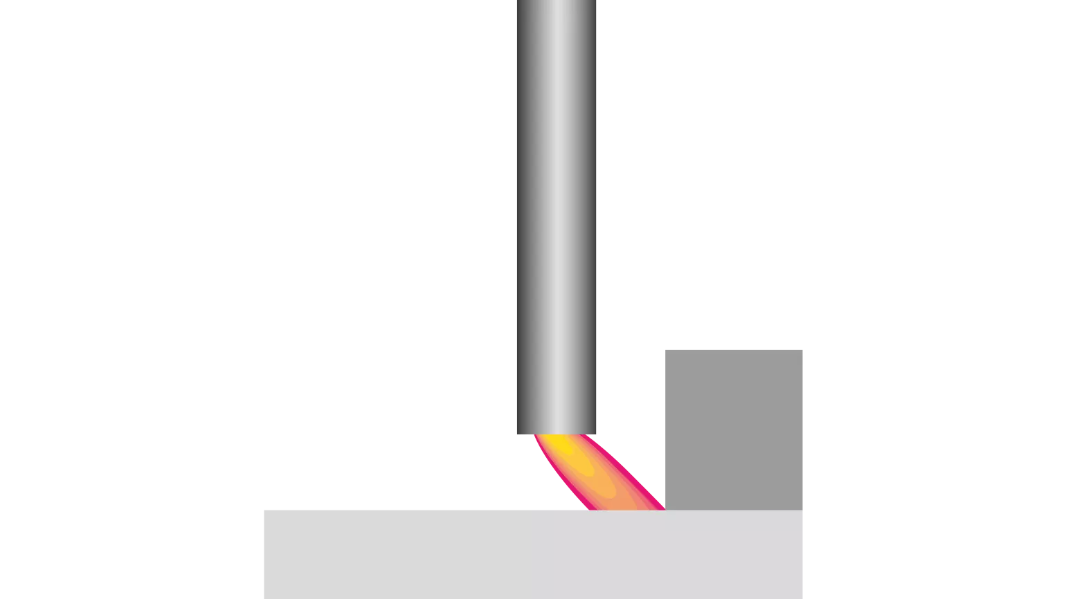

Arc blow
The arc blow describes the irregular fluttering of the electric arc in an undesirable direction.

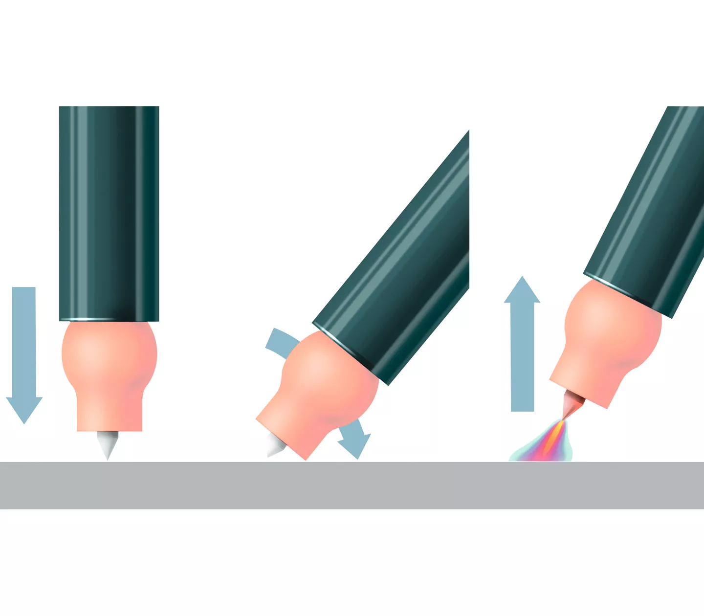

Arc break voltage
Refers to TIG welding torches without a torch trigger and stick electrodes: In both processes, the welding process is ended by lifting the welding torch or electrode off the workpiece. The required distance to the workpiece is defined in volts in advance by the arc break voltage.

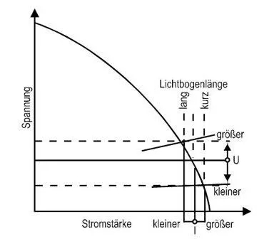

Arc characteristic
The arc characteristic indicates the relationship between the arc voltage and the arc current.
Arc length
The arc length refers to the distance between the point where the arc touches the wire electrode until the point of reaching the workpiece. The voltage is a characteristic dimension for the arc length.

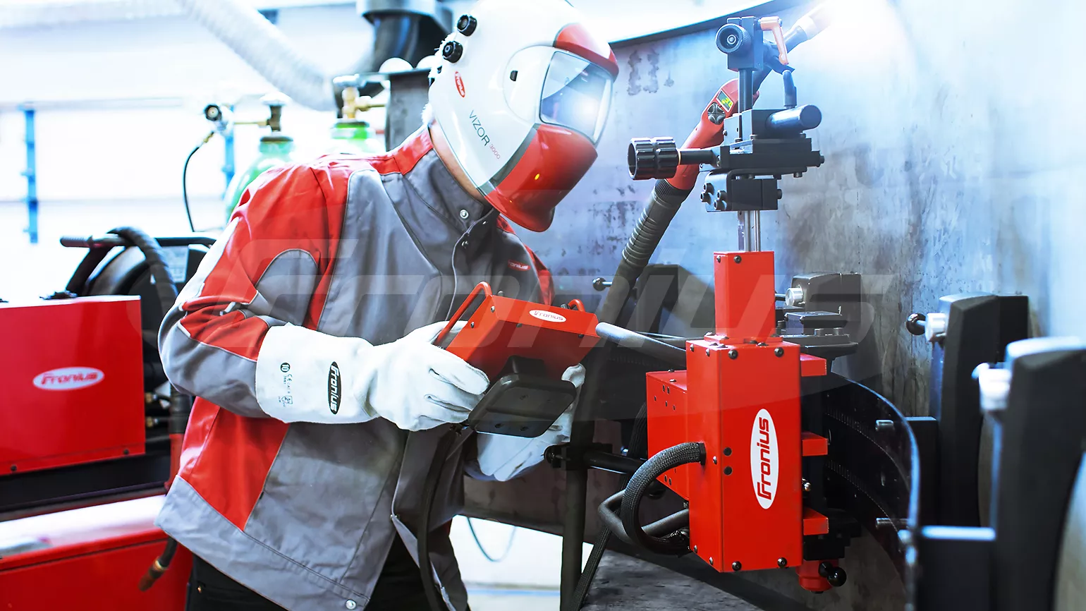

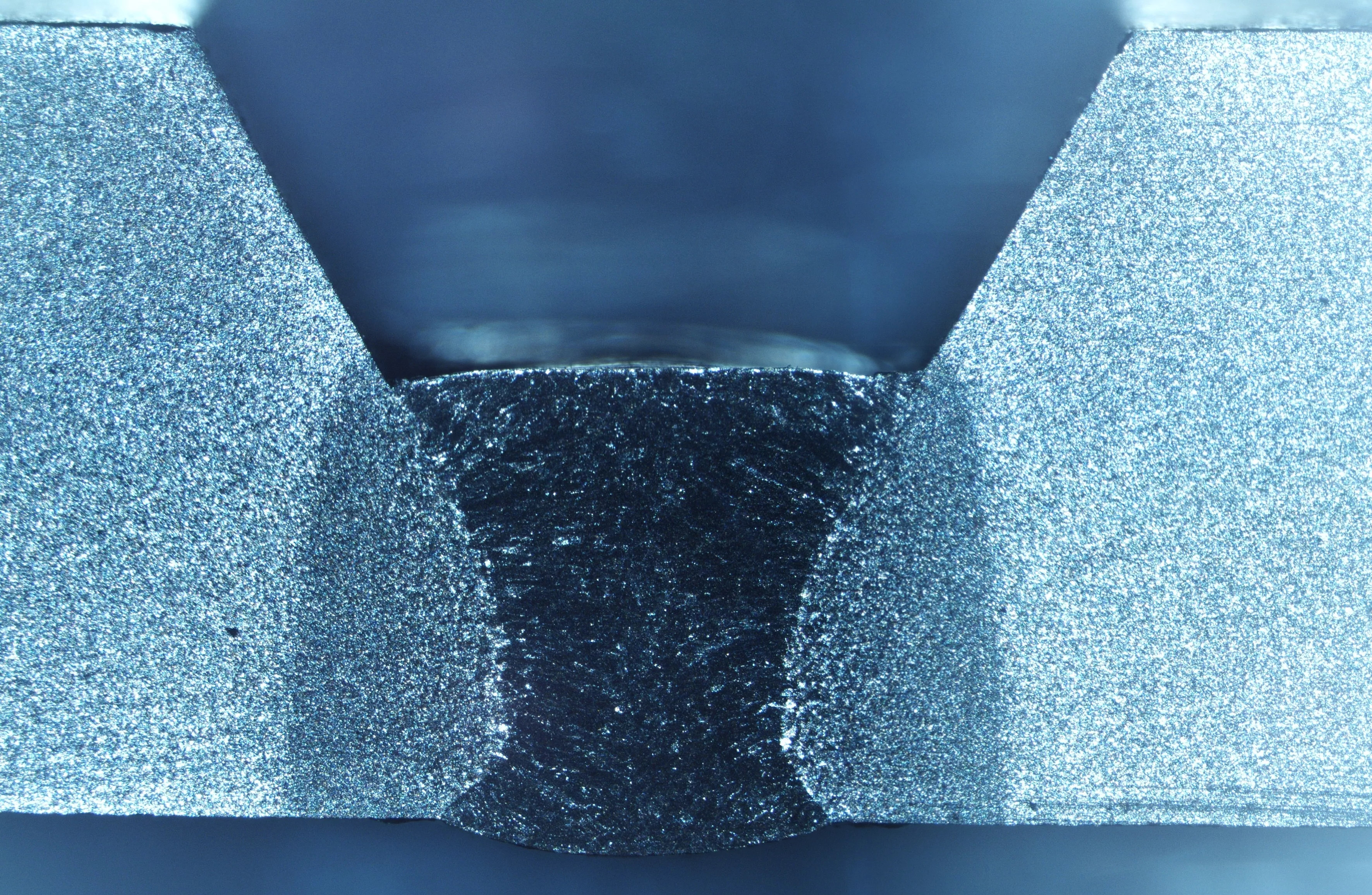

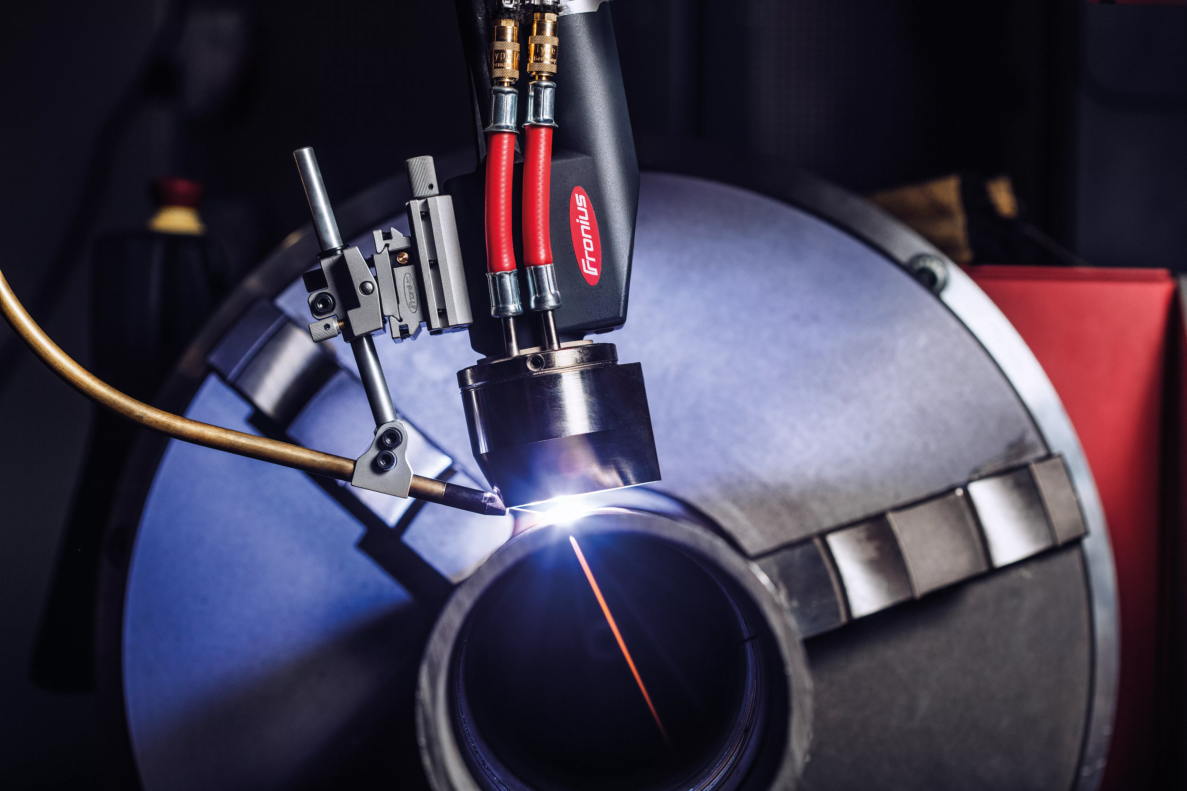

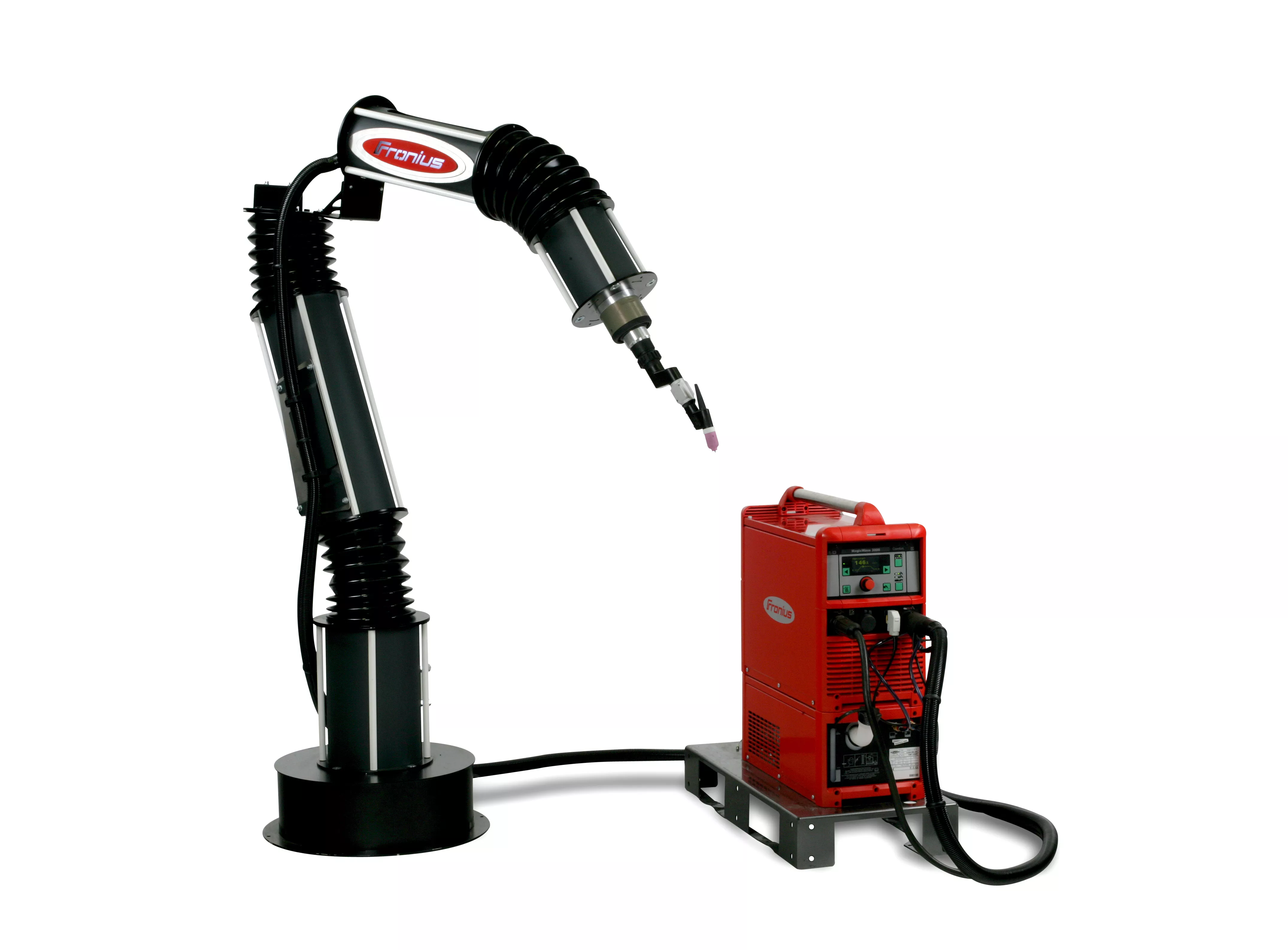

ArcTig
ArcTig is a TIG keyhole welding process. The tungsten electrode is water-cooled, whereby significantly higher welding speeds can be achieved than in conventional TIG and plasma welding.
More on the ArcTig welding process

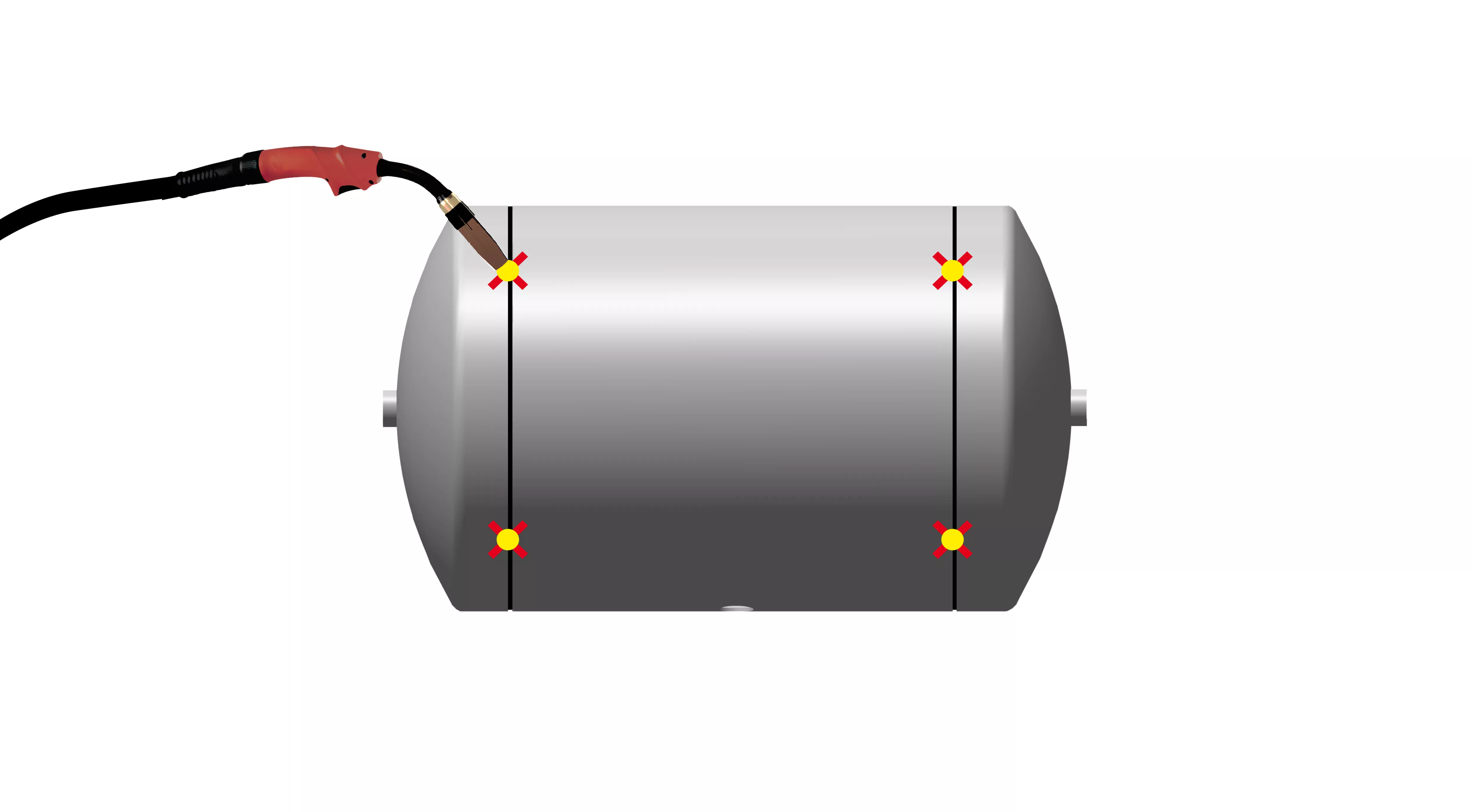

Back-step welding
This is a welding technique where short weld seam lengths are welded in the opposite direction to the main welding direction so that the end of a weld seam length overlaps the start of the previous seam.

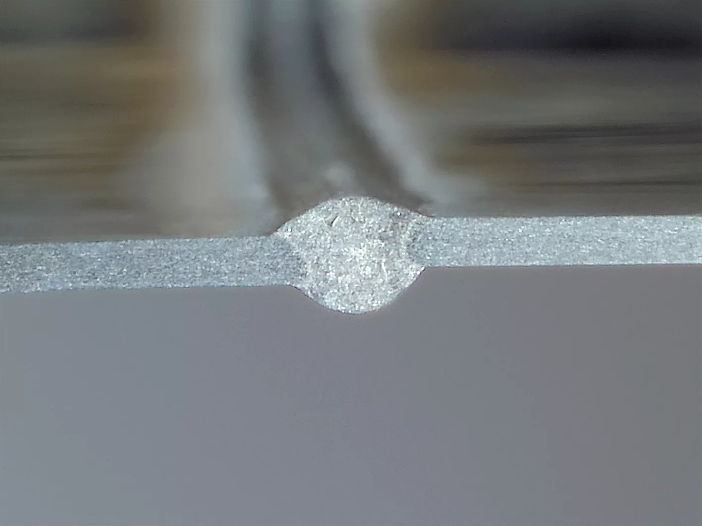

Butt joint
Butt joints are used to join workpieces positioned on the same plane, that is, at an angle of 180 degrees to one another.

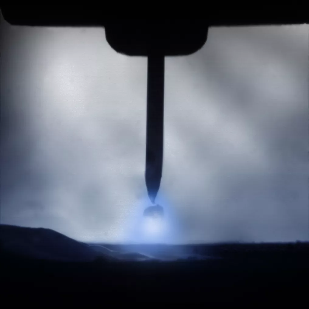

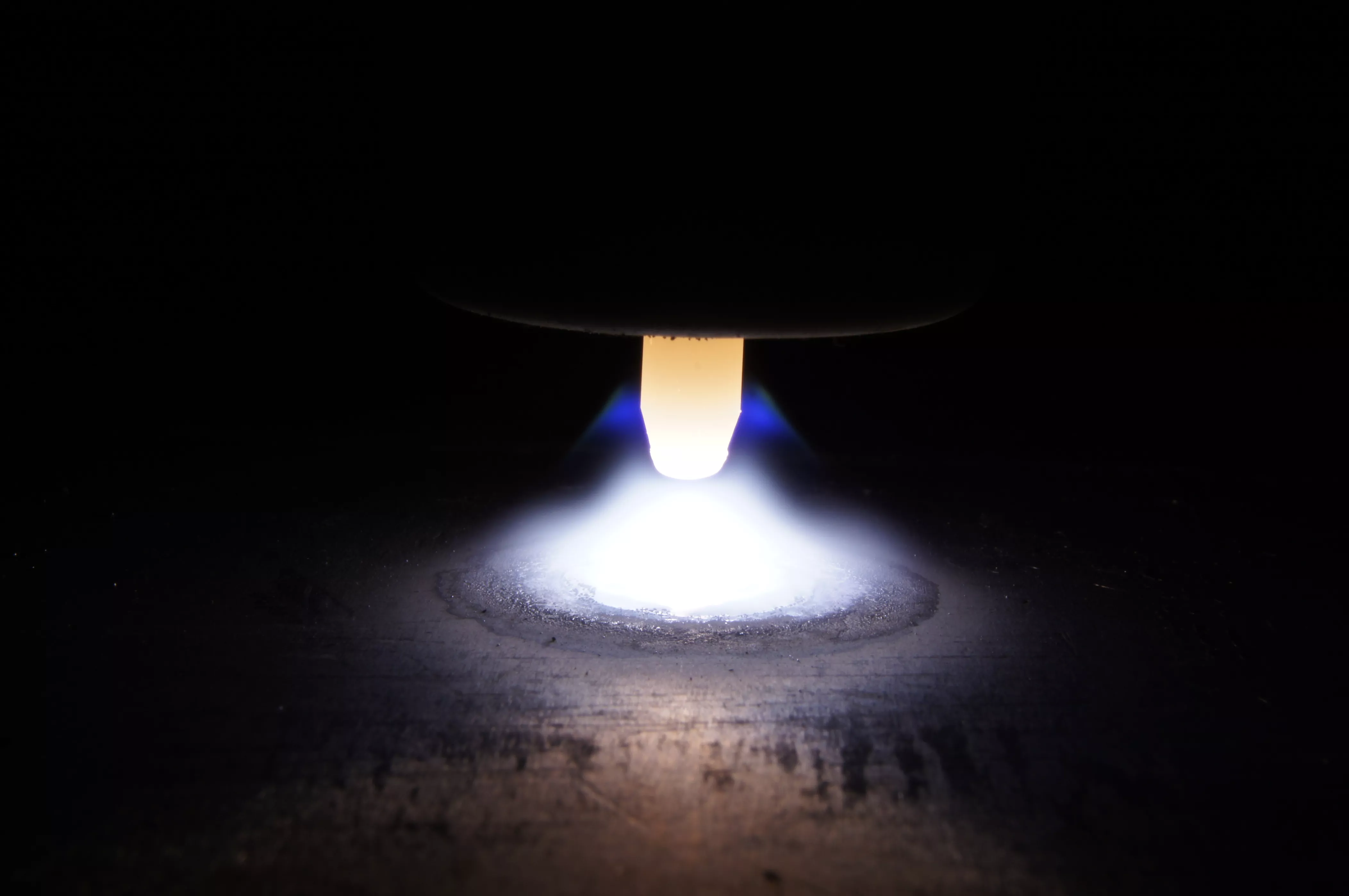

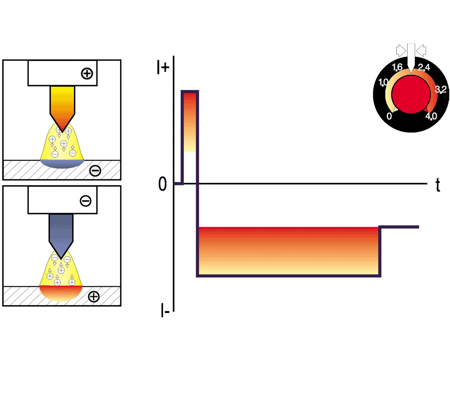

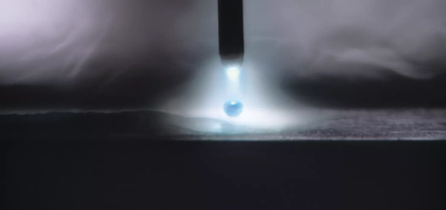

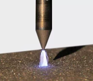

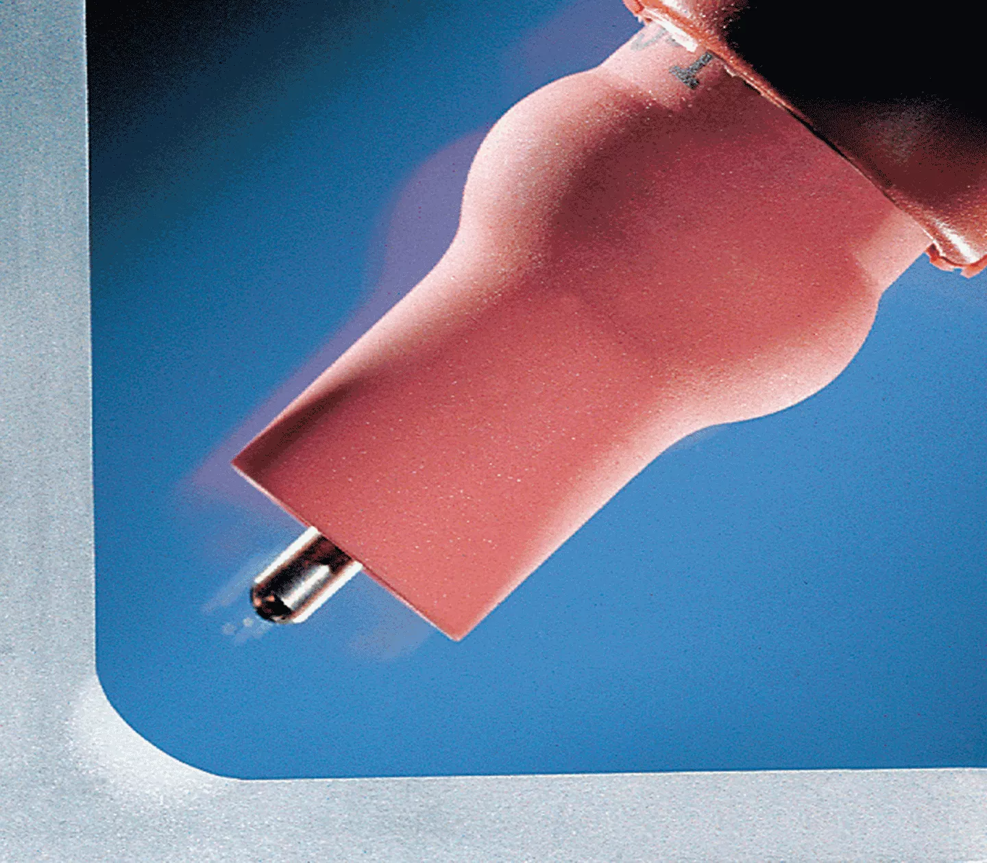

Cap-shaping/cap
A cap refers to the rounded/molten end of a tungsten electrode, required for aluminum welding with alternating current. Modern welding systems have the function of automatic cap-shaping.
What is a cap?
Cap-shaping mode
Cap-shaping mode is the function on the welding system that prepares the tungsten electrode for AC welding. Instead of the usual tip, the electrode is melted into a hemispherical cap.

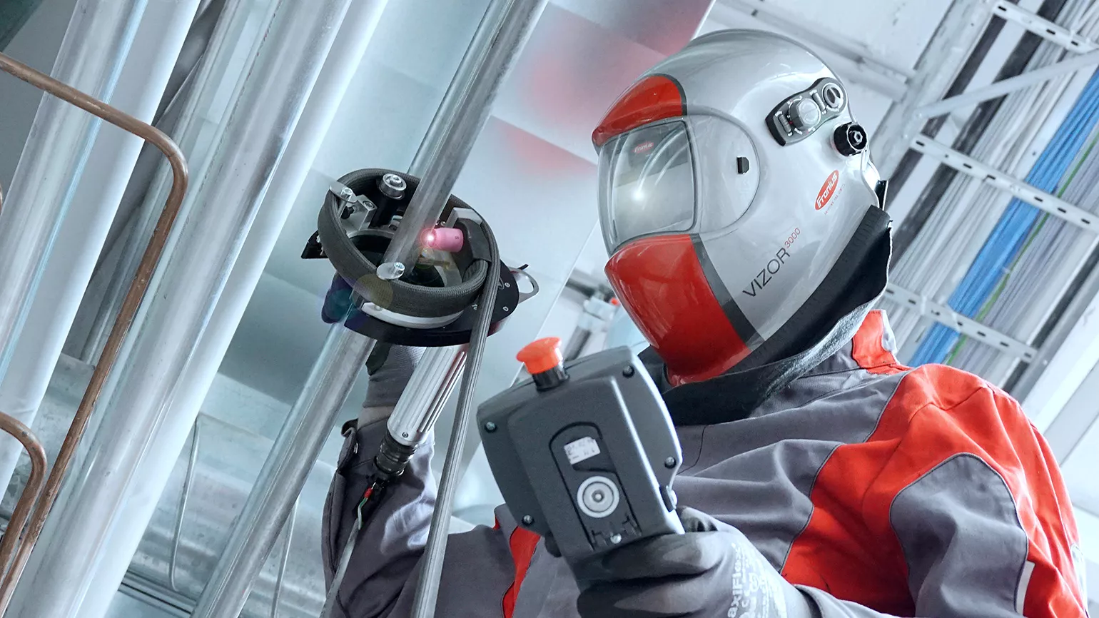

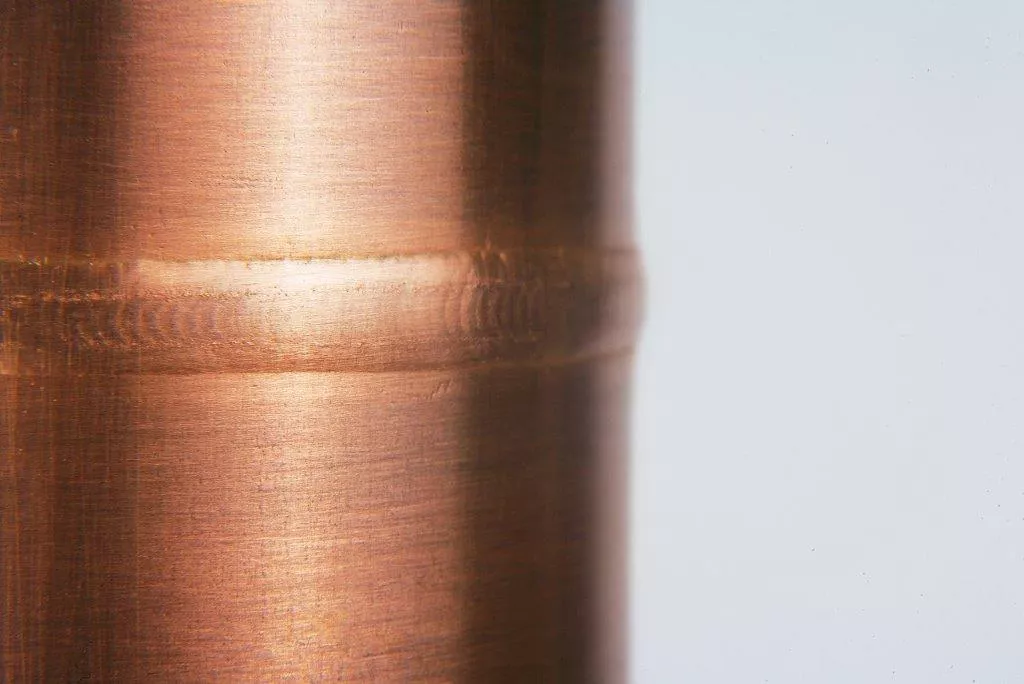

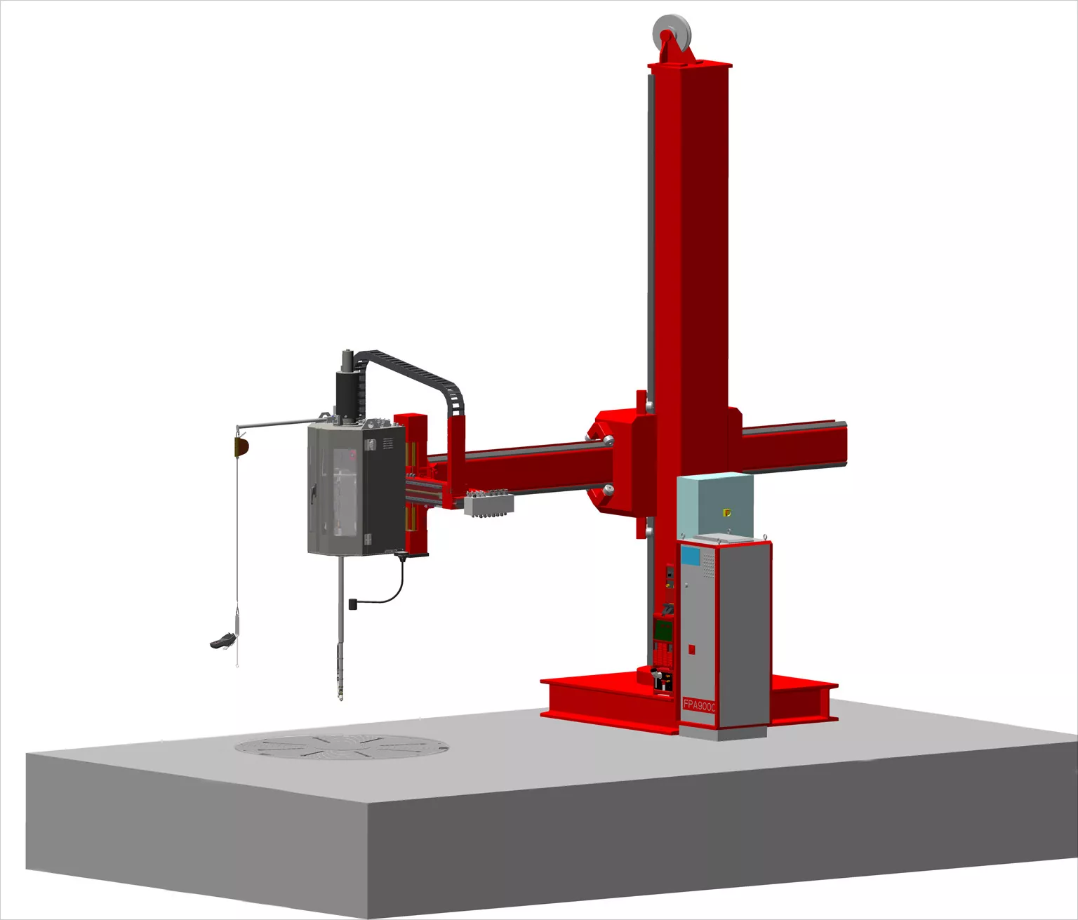

Circumferential welding
In circumferential welding, two cylindrical components are fully joined together.
Overlay welding, also called cladding, is a type of coating using welding processes. A filler metal in wire or powder form is applied – usually as a covering layer – to build up volume. The processes used here are TIG overlay welding, GMAW overlay welding, and CMT overlay welding.
Additional information on cladding

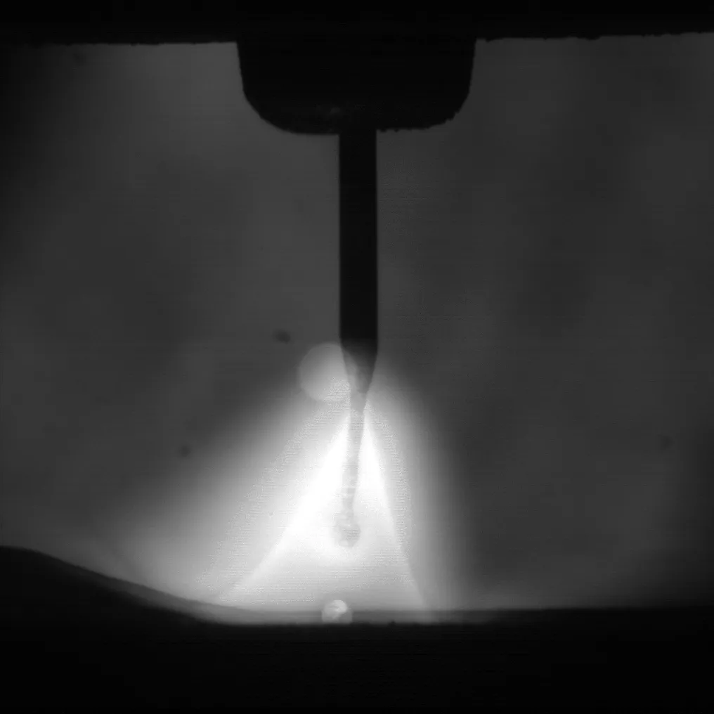

CMT – Cold Metal Transfer
Cold Metal Transfer (CMT) is a dip transfer welding process where the heat input is kept very low. Due to the reversing wire movement, the CMT process has a completely new type of droplet detachment. This leads to significantly improved dip transfer arc characteristics.

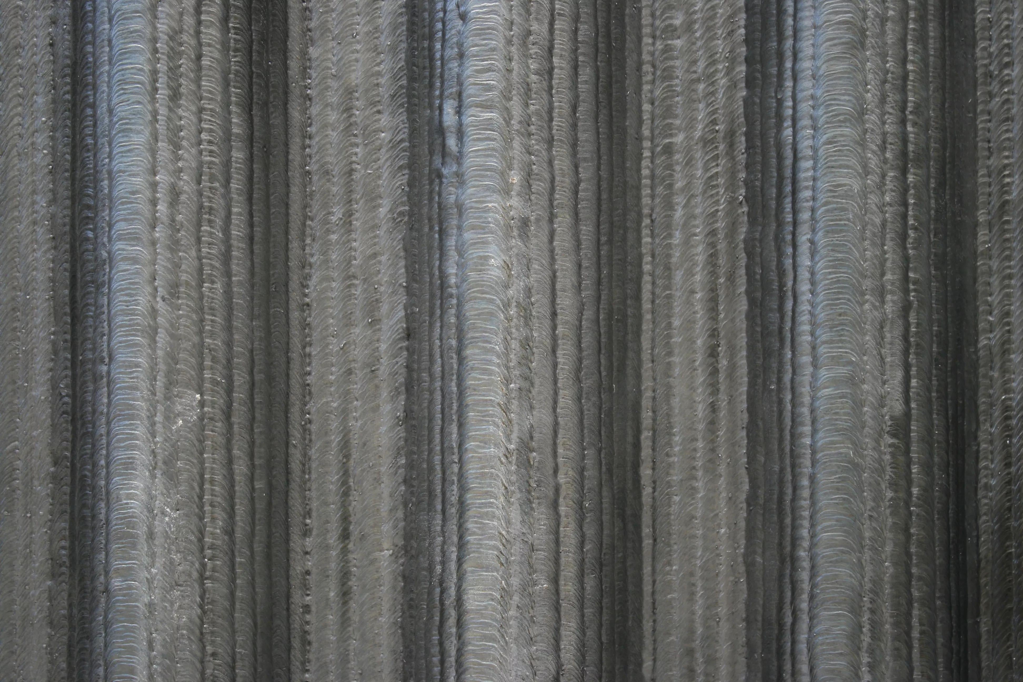

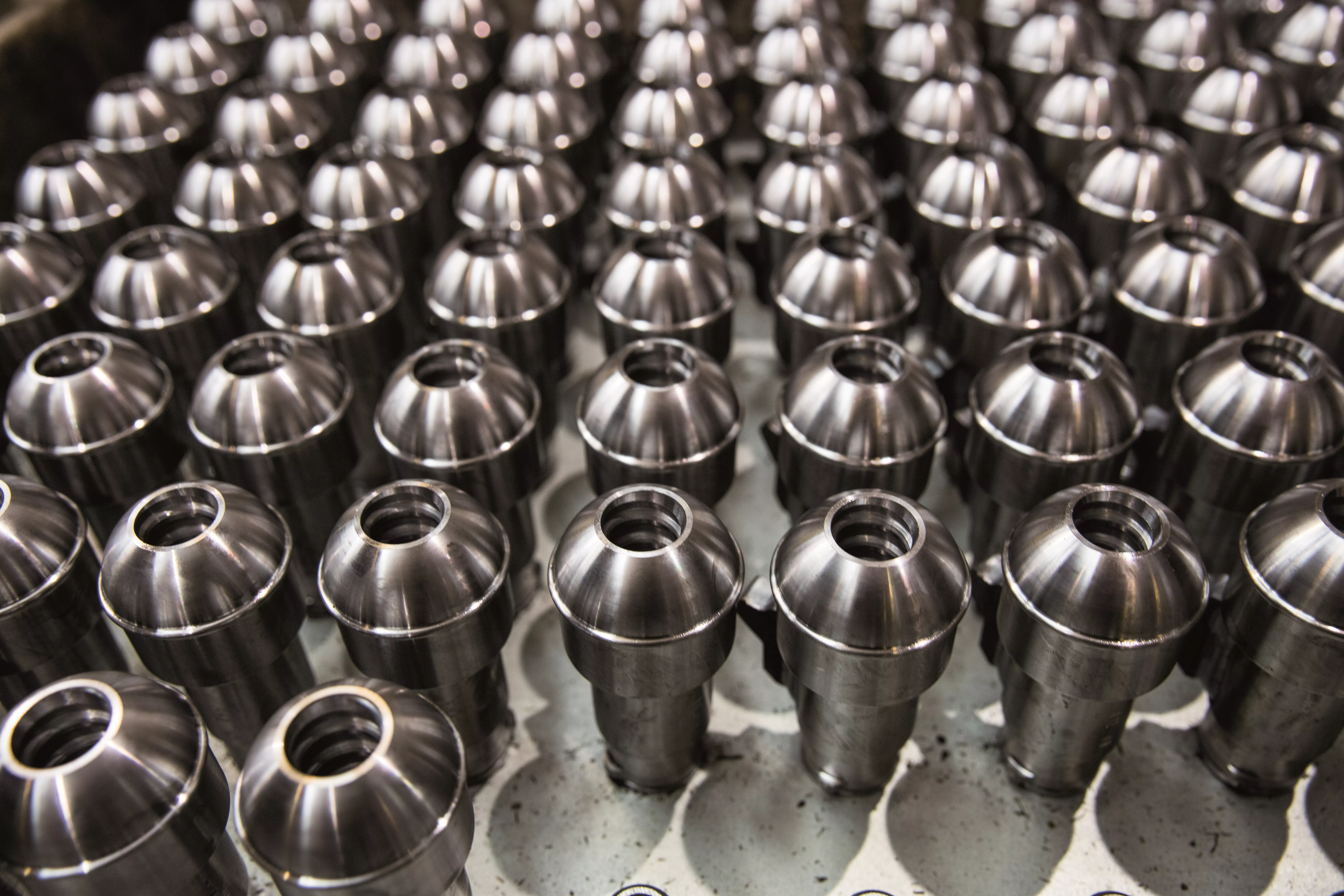

CMT overlay welding (CMT cladding)
Overlay welding with CMT offers advantages due to the reduced heat input and high process stability. CMT allows for low fusion where there is a metallurgically perfect bond between the parent material and filler metal.
Additional information on CMT Cladding

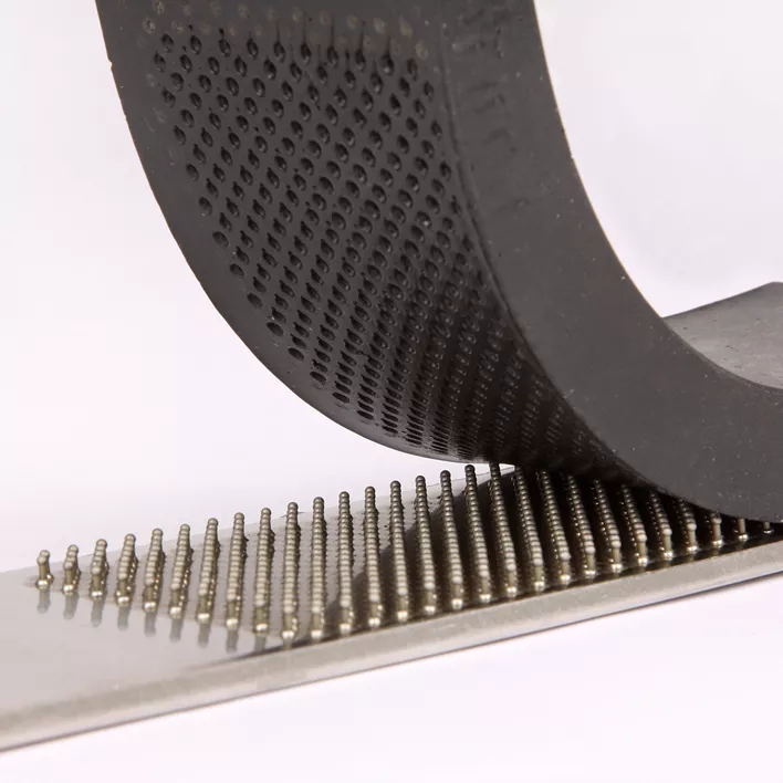

CMT Pin, Fronius
CMT Pin
With CMT Pin, small wire pins are welded onto the metal surface. Depending on the level of current and force applied during wire retraction, the different forms "Ball", "Cylindrical", and "Pike" are created.

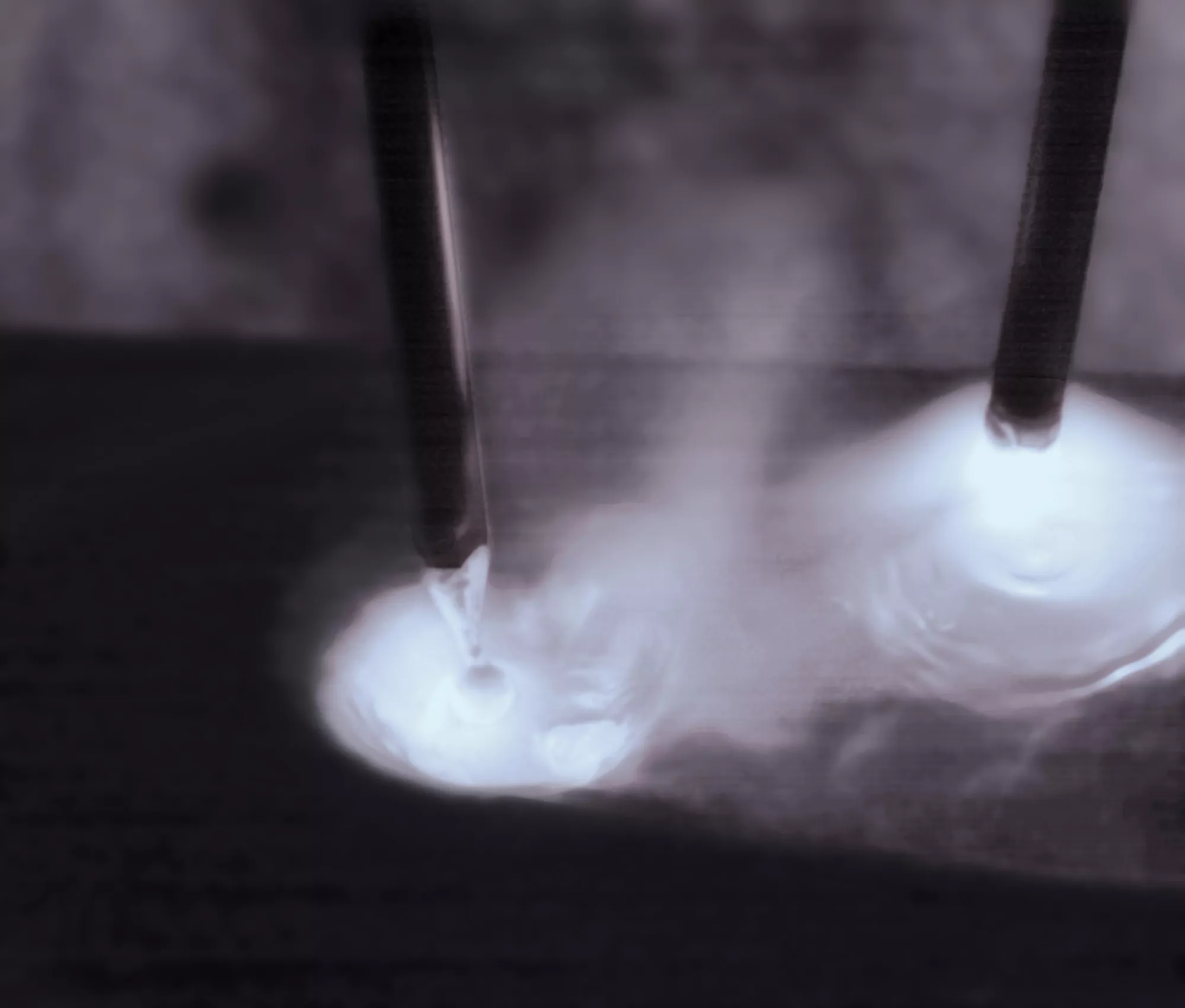

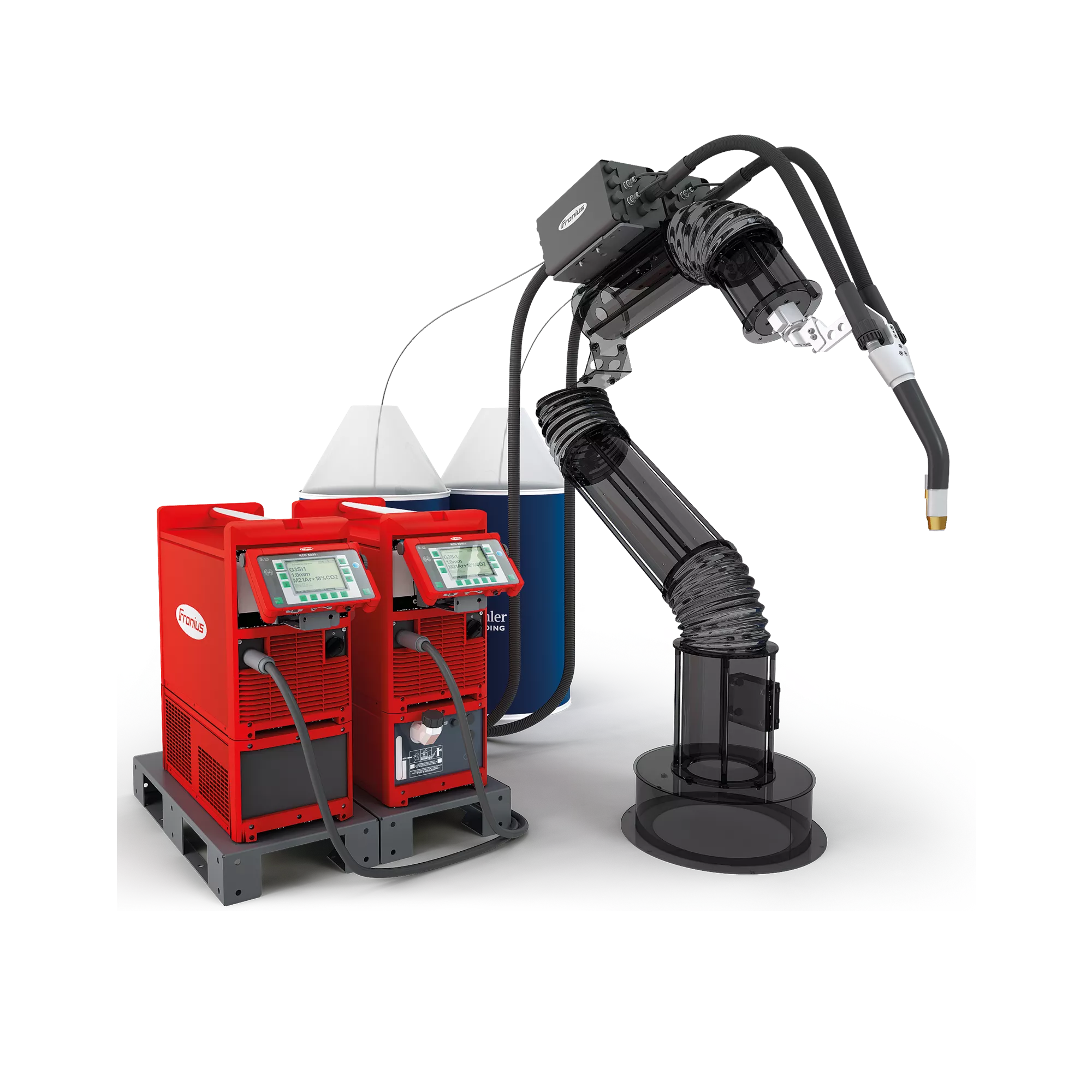

CMT Twin Aluminum

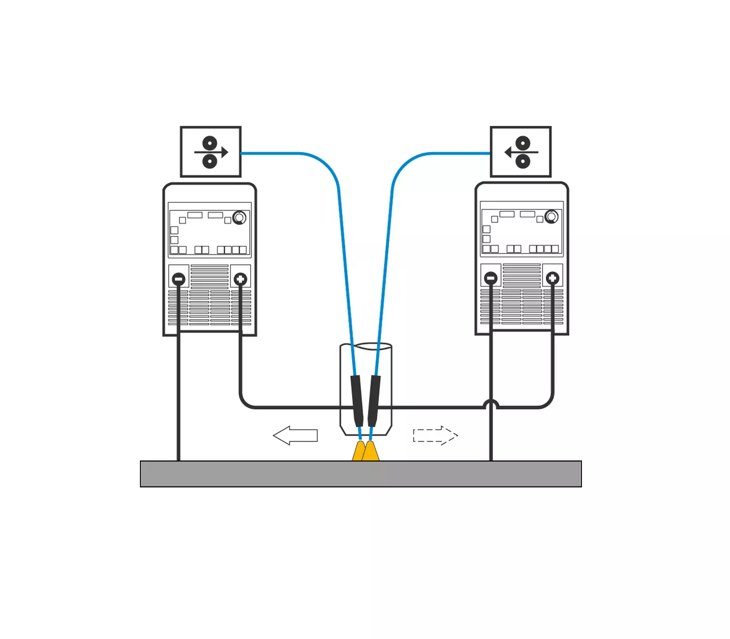

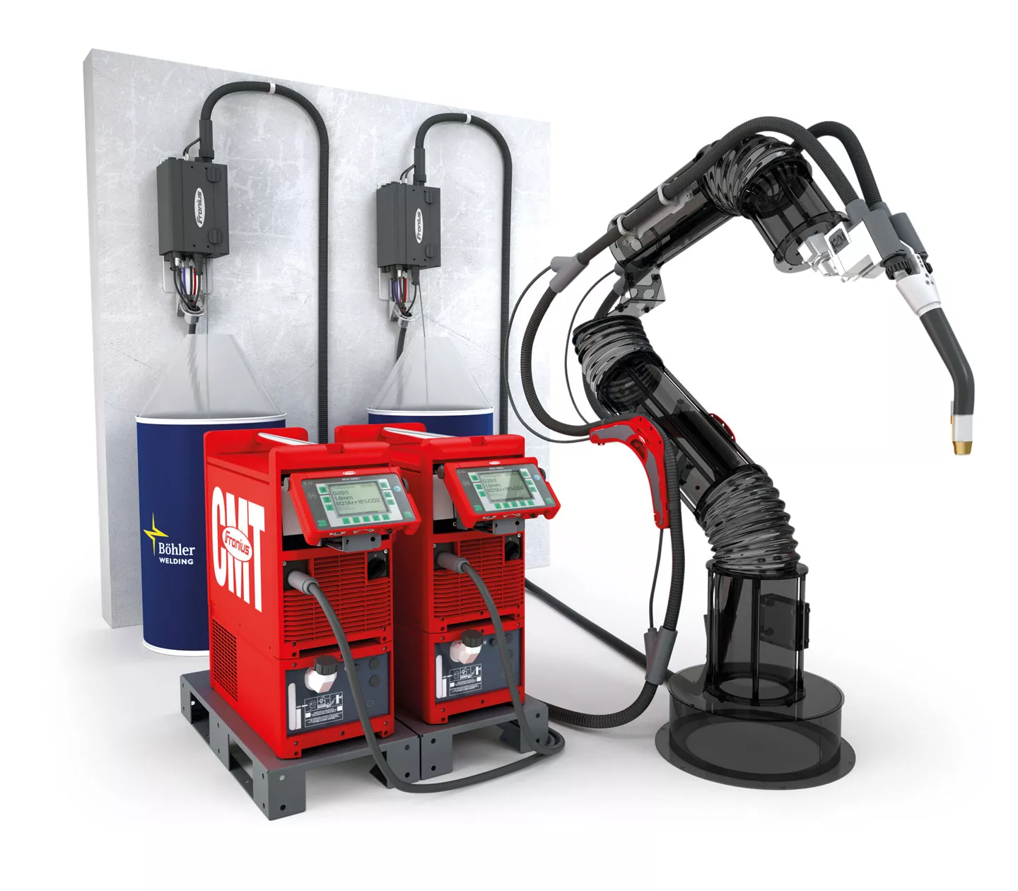

CMT Twin
CMT Twin is a MIG/MAG tandem welding process based on the CMT process where two completely isolated wire electrodes come together in a common weld pool. The combination of a short pulsed arc for the "lead electrode" and a stable CMT dip transfer arc for the "trailing electrode" is advantageous here.
Additional information on CMT Twin

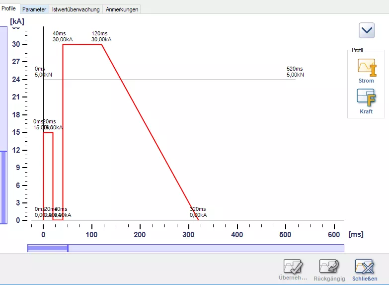

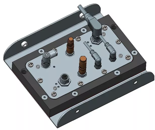

Device ID
The device ID can be considered as a safety feature of DeltaSpot and DeltaCon. It is located on the sensor PC board directly on the gun. All gun-related data is stored on it for identification purposes. This is, amongst other things, to prevent damage to the system or component.

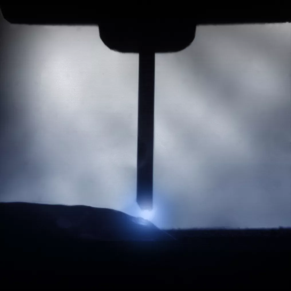

Dip transfer arc
The dip transfer arc is a short-circuited arc with low power. It is suitable for ultra-light gage sheet, root pass, and position welding.
LSC arc

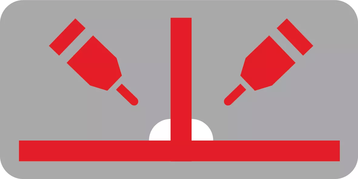

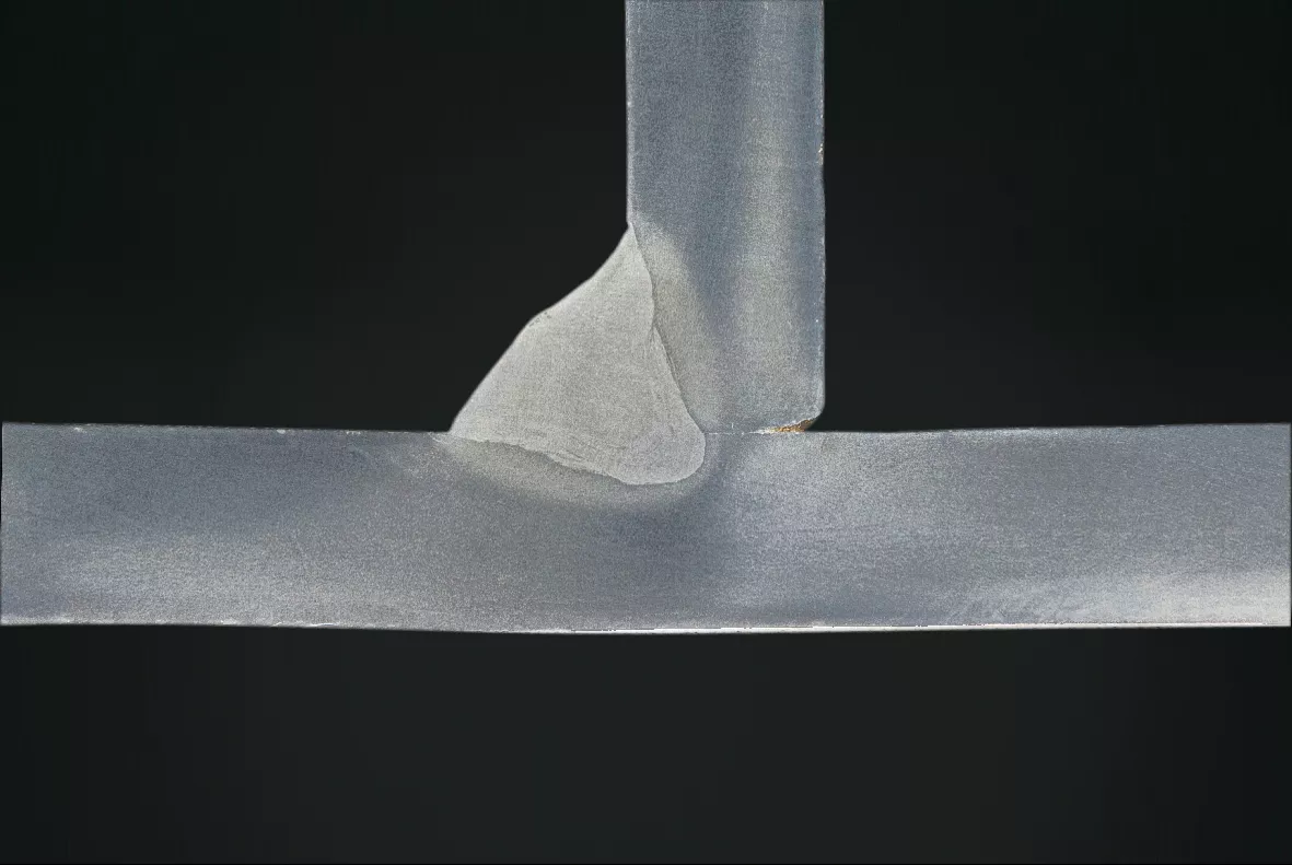

Double fillet weld
A double fillet weld is a T-shaped weld seam, welded on both sides.

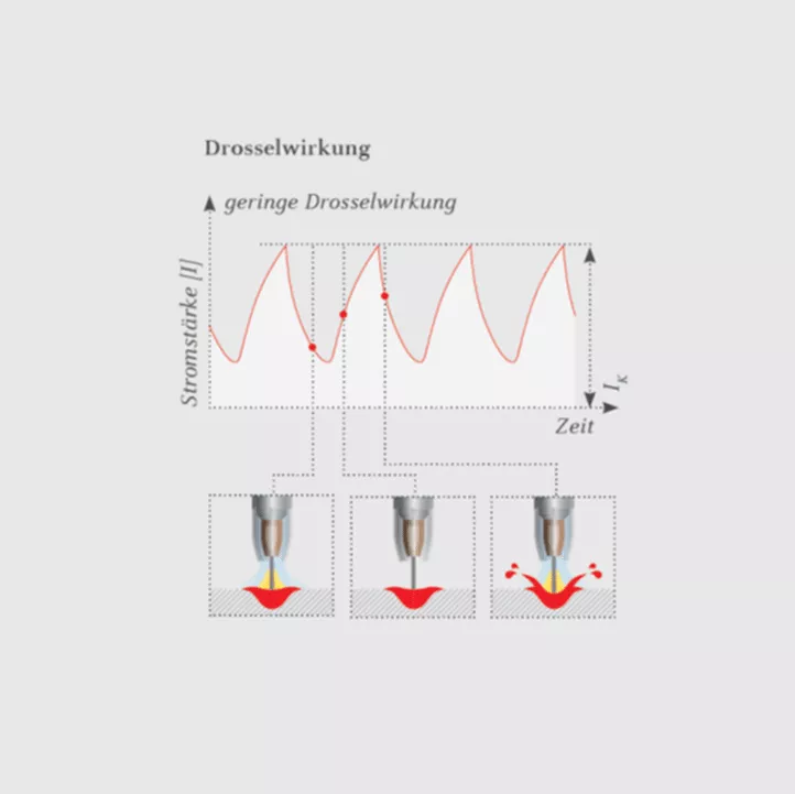

Dynamic correction
Dynamic correction can be used to control the current increase behavior.

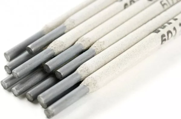

Electrodes

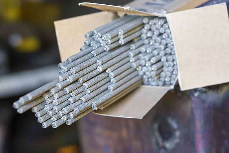

Electrode / Rod electrode
The rod electrode is a coated metal rod that is used for electrode welding. It acts both as a conductor for the arc and the filler metal at the same time. A distinction is made between basic (B), rutile (R), and cellulose (Cel) coating types.
Find out more about electrodes

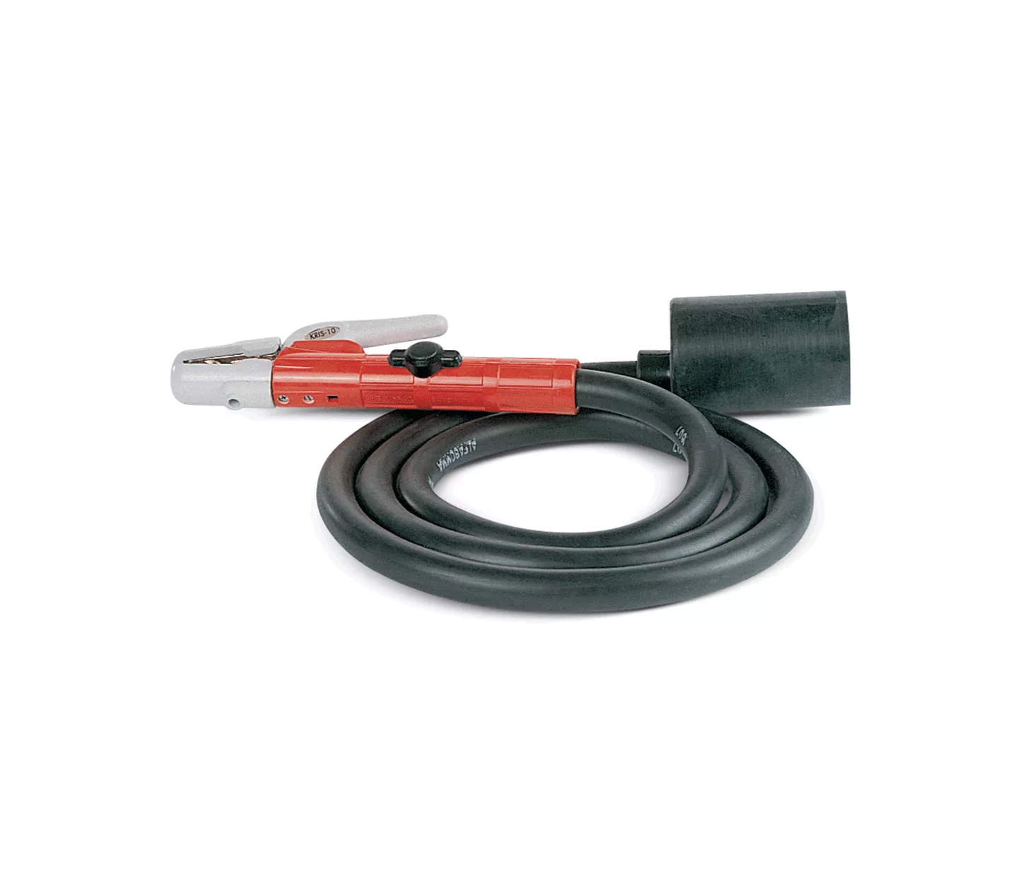

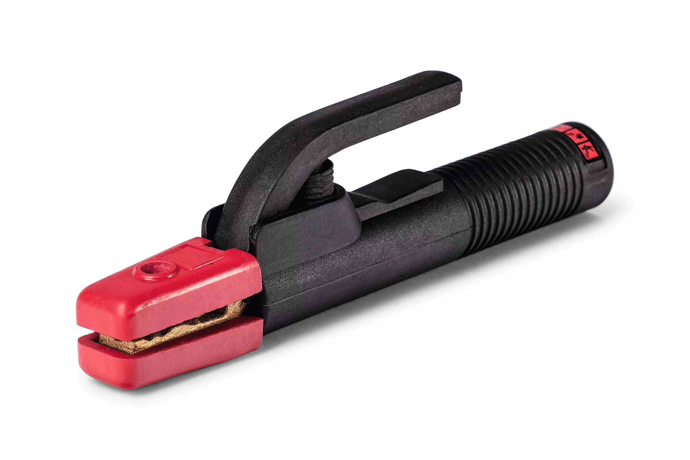

Electrode holder
Secures the rod electrode during manual welding and allows the current to be transferred to the electrode.
Electrode types
Rod electrodes for welding are made in numerous materials and with different coatings. The most common are rutile (R), basic (B), and cellulose (Cel) covered electrodes.
Find out more about electrode types

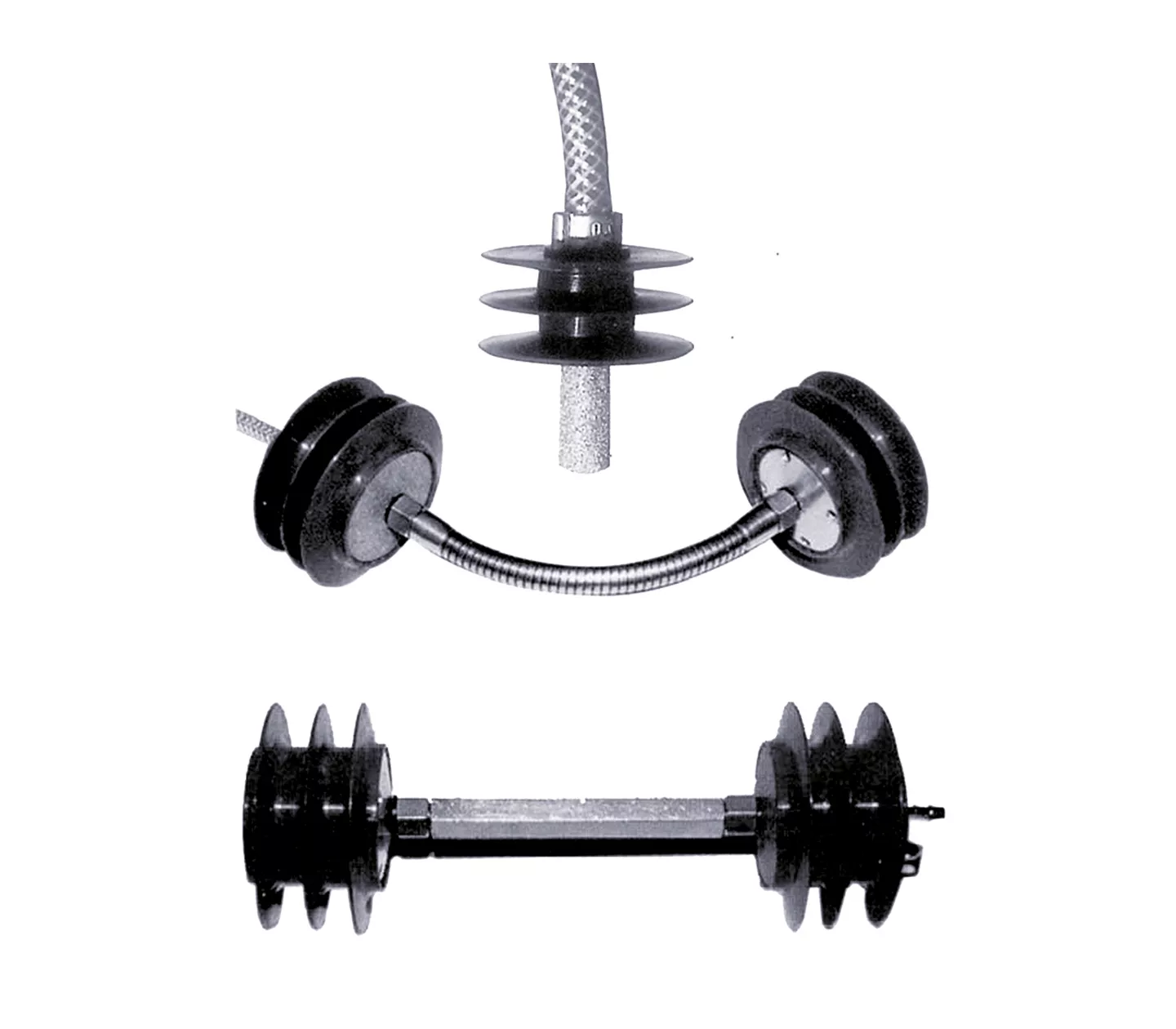

Forming
Forming primarily refers to a method used in TIG welding to protect the part of the weld seam facing away from the tungsten electrode from oxidation/temper colors. When welding pipes, these are flushed internally with gas (see figure: forming gas cylinder). When welding sheets, the underside is flushed with gas.

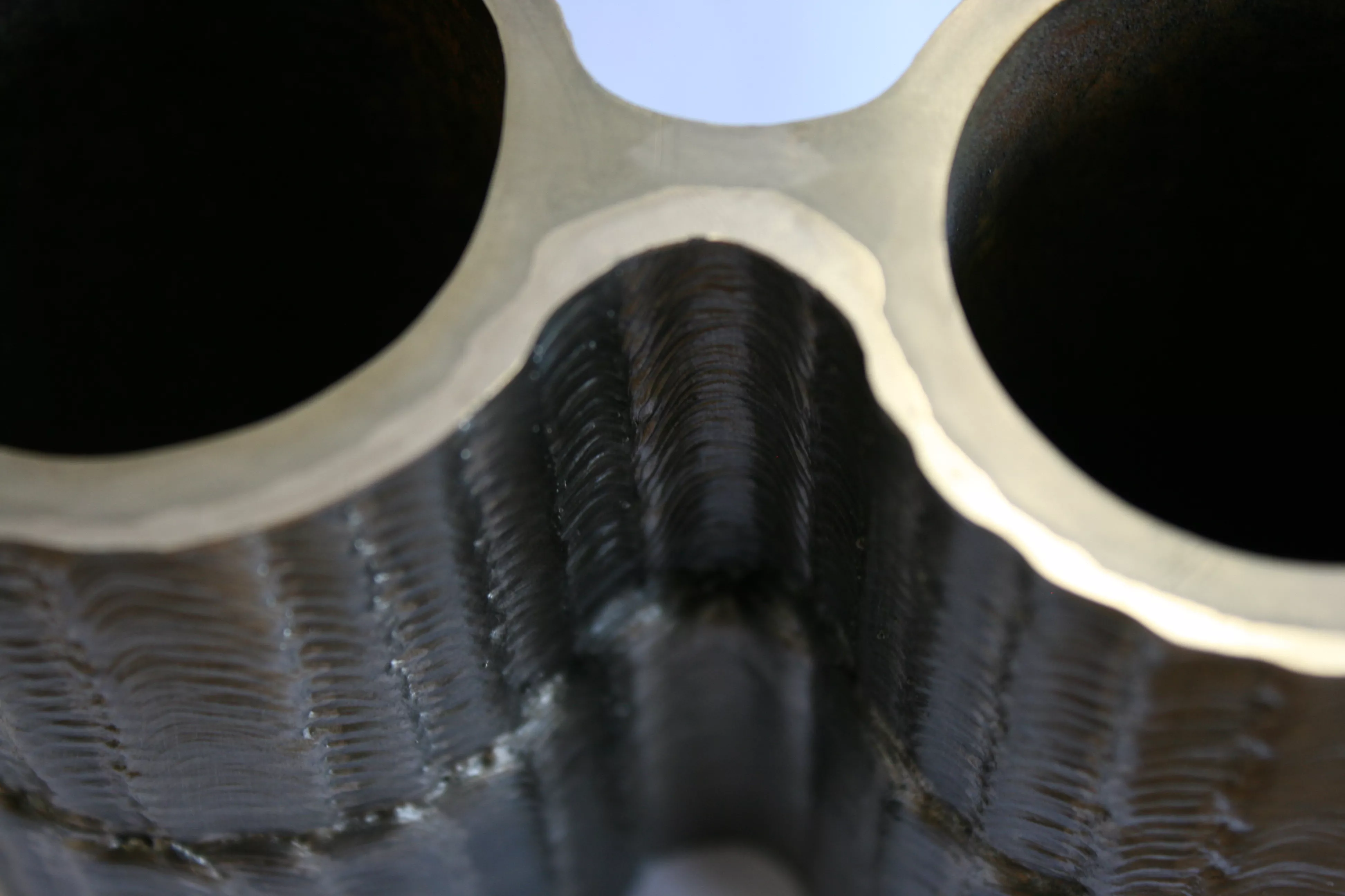

Gas metal arc overlay welding is used for cladding. A wear protection layer is applied over the base body using the MIG welding process. A characteristic of this is low penetration, low fusion, and a low ferrite content in the first weld layer.

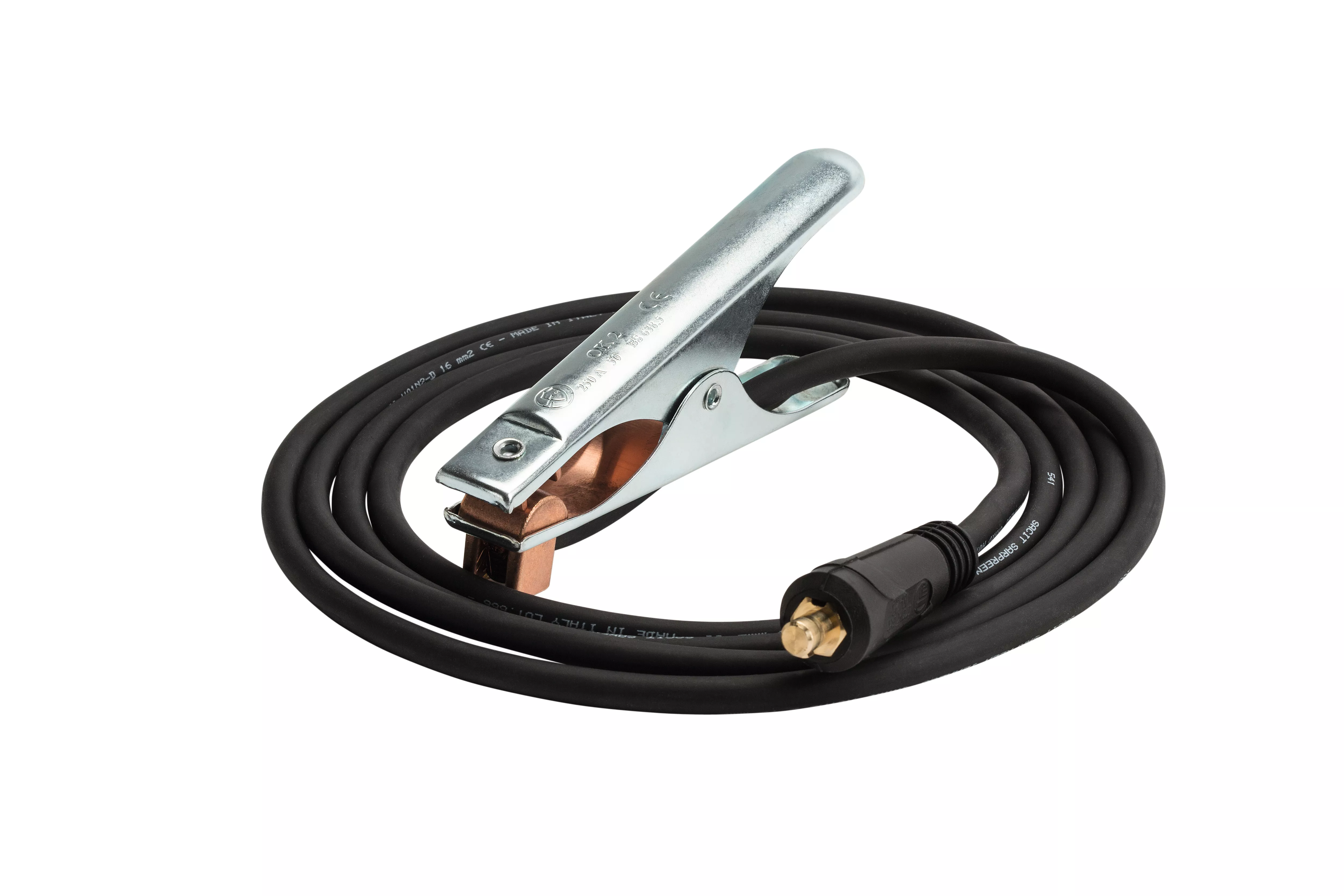

Grounding cable
The grounding cable is the current return cable in the welding circuit. It is secured to the component.

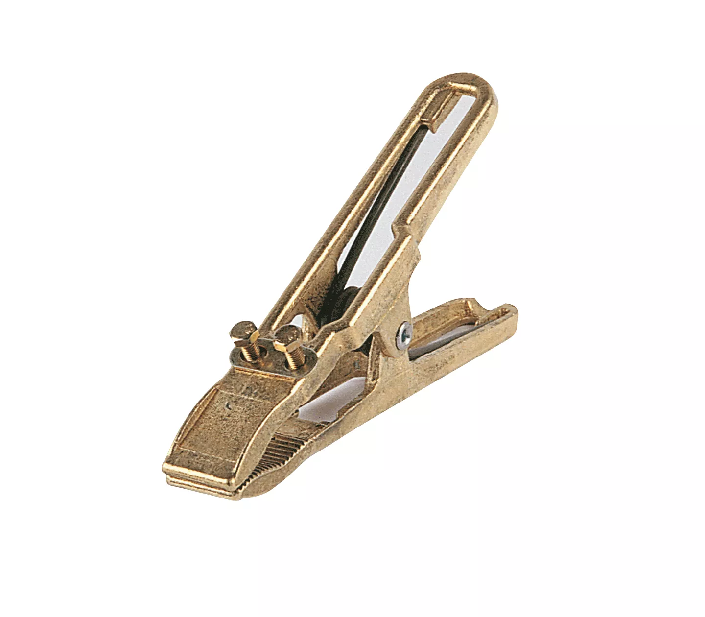

Grounding clamp
The grounding clamp is a quick-release mechanical connection between the workpiece and the current-return cable in the welding circuit.

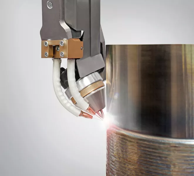

Hot wire
The hot wire welding process can increase the productivity and quality of overlay welding (cladding).

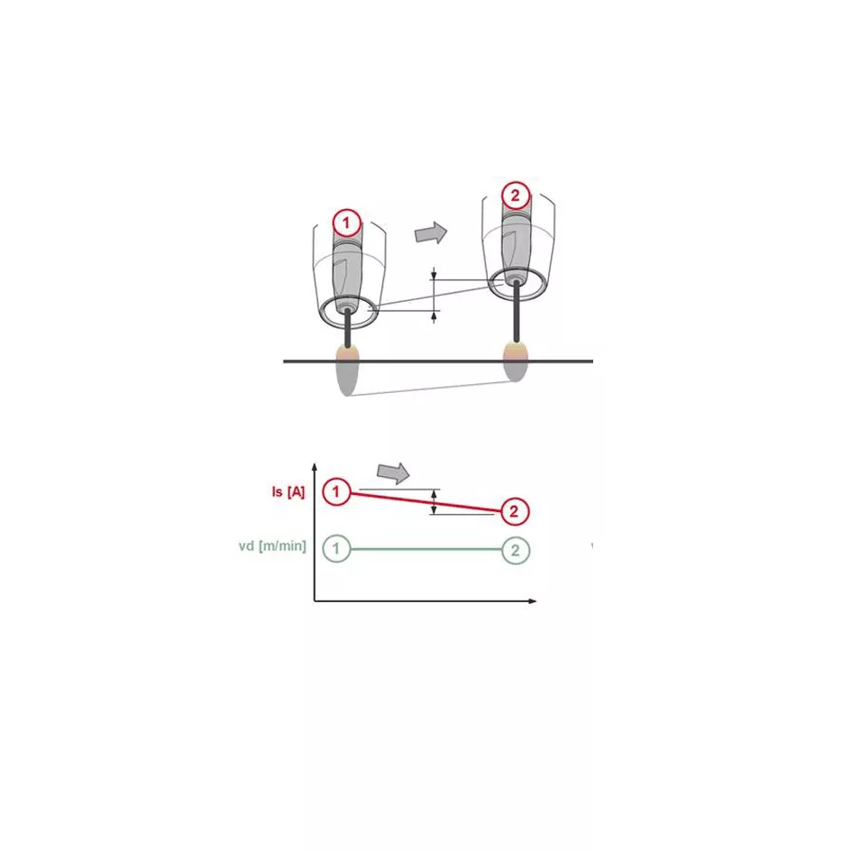

Inner control
For the inner control, constant-voltage characteristics or slightly drooping characteristics are used. The result is that when the welding amperage is changed, the voltage barely changes or does not change at all. Inner control improves process stability, even if the distance between the welding torch and the workpiece changes.

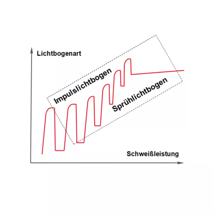

Intermediate arc
The intermediate arc is characterized by a coarse droplet, short-circuited droplet transfer. The advantages include positional freedom and relatively deep penetration. In contrast, however, is the increased spattering.

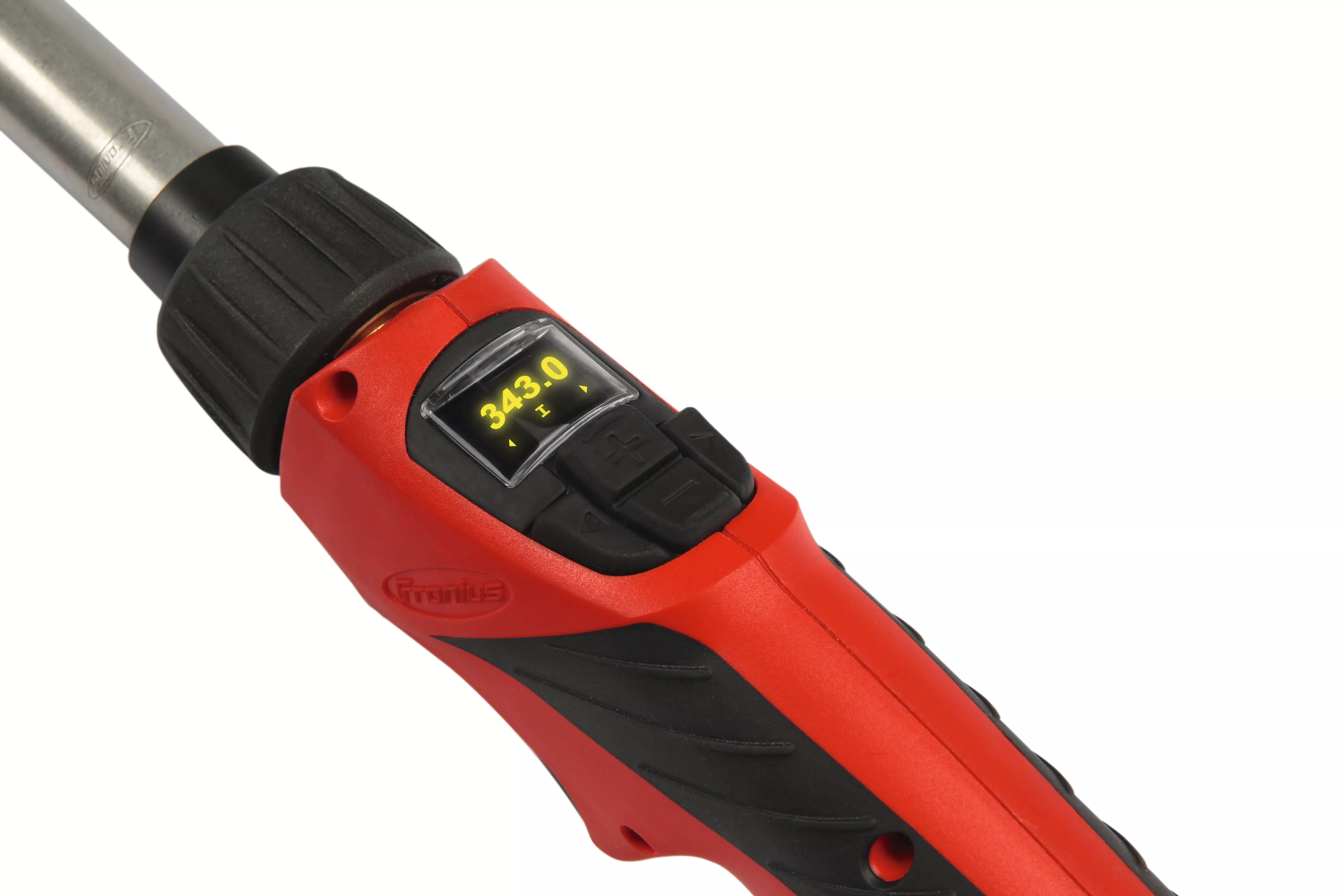

Interval mode
In interval mode, both the arc time and pause time can be set.

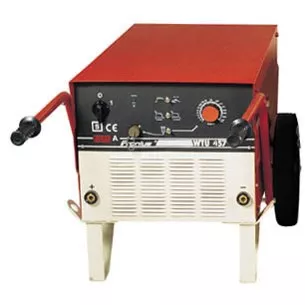

Inverter
Inverting means transforming. This concerns converting DC into AC current and vice versa. In the case of the inverter power source, the transformer is driven by a very high frequency, whereby the volume of the transformer can be kept extremely low. This reduces the weight and the power source is mobile. In addition to direct current, inverters can also generate sinusoidal and square wave alternating current for special requirements.

Longitudinal seam welding
In longitudinal seam welding, components are joined together lengthwise.

MagicWave
The MagicWave is a fully digitized TIG series and can be used with both alternating current (AC) and direct current (DC). The operator can adapt the waveforms to various conditions.
Magnetic arc blow
Every metallic object that has current flowing through it builds up an electromagnetic field. This magnetic field can deflect the electric arc and cause weld seam faults. Larger masses of steel attract the electric arc.

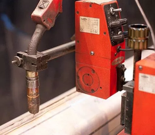

Mechanical welding
Mechanical welding is a mechanized joining process. Among other things, this involves using trolleys or robots.
More on mechanical welding

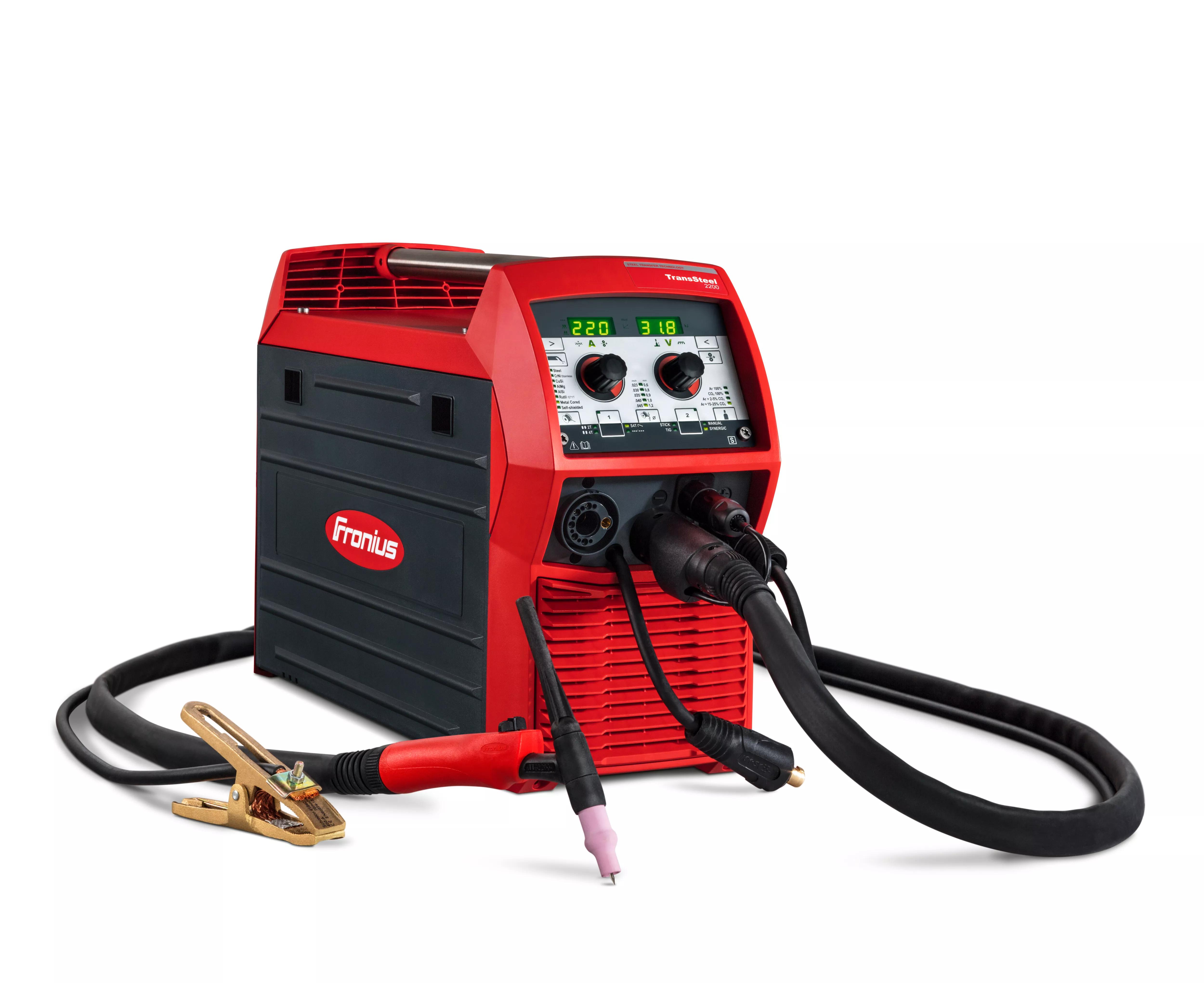

Multiprocess welding systems
Multiprocess welding systems refer to welding power sources where the common welding processes, such as MIG/MAG, SMAW, and TIG, are available.
Multi-weld welding system TransSteel 2200

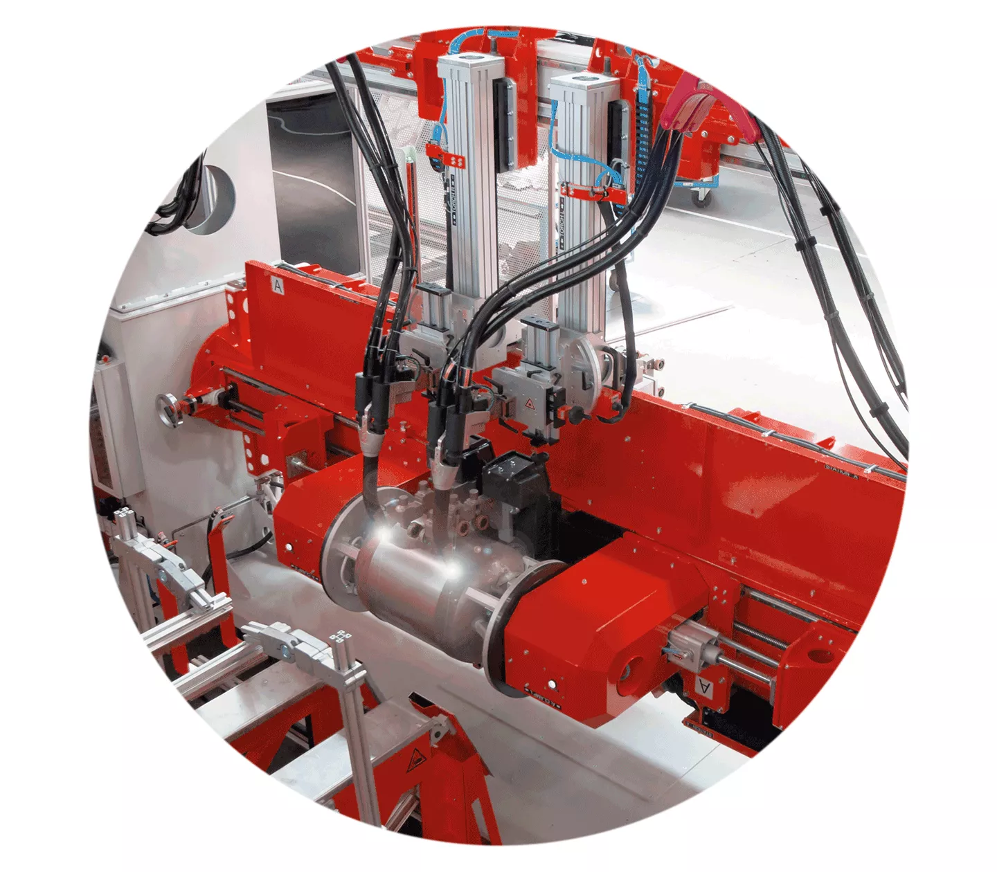

open weld head FOH, mechanized TIG orbital welding
Orbital welding
Orbital welding is a mechanized welding process in which the arc is guided by machine and without interruption around pipes or other round objects.

Penetration
Penetration refers to the depth of the melted zone in the parent material.

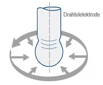

Pinch effect
In welding technology, the term pinch effect refers to the detachment of the droplet at the wire end caused by the effect of the magnetic constriction due to high currents.

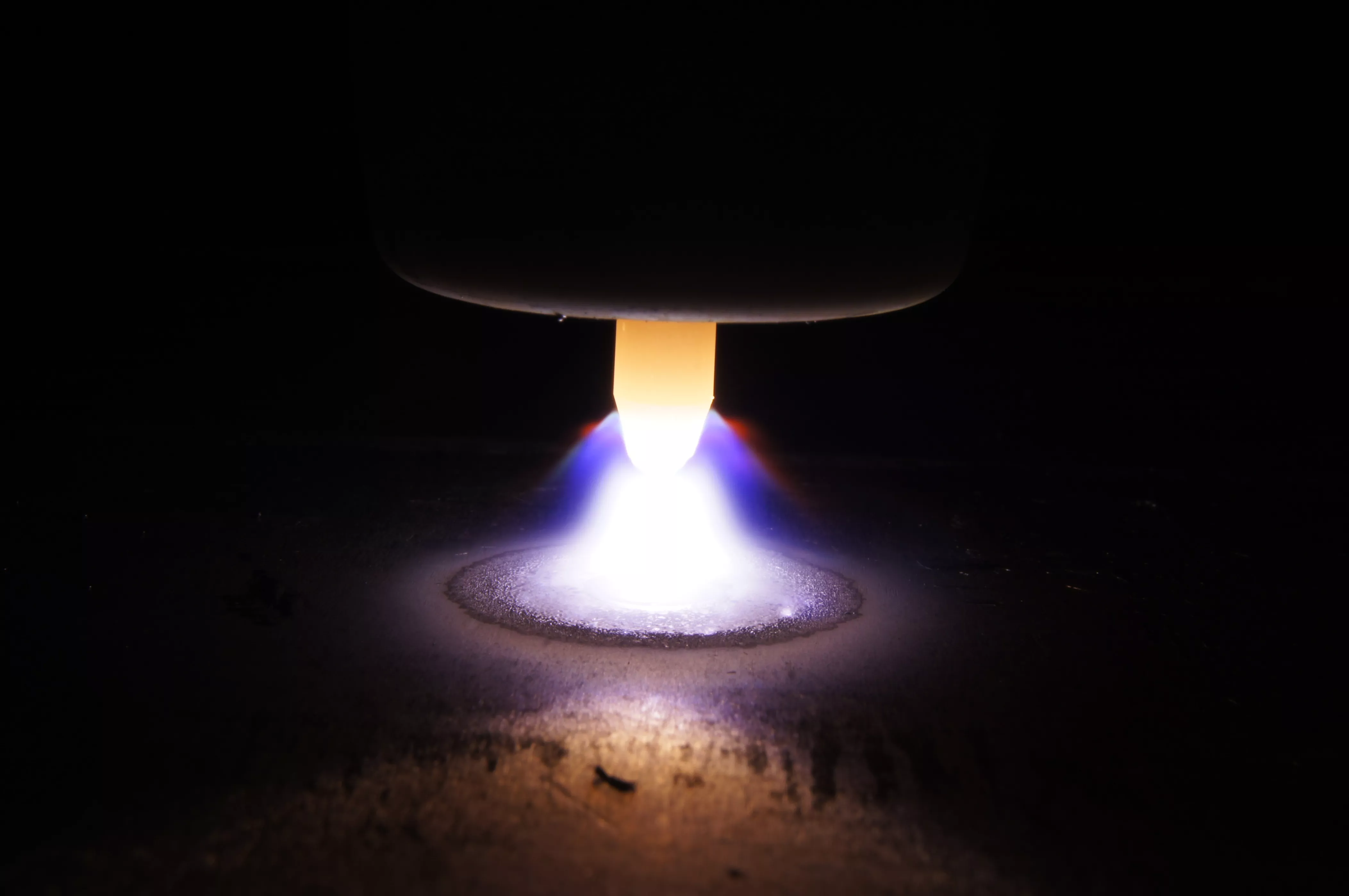

Plasma welding, Fronius
Plasma welding
In plasma welding, the welding or main arc burns between a tungsten electrode and the workpiece, just as in TIG welding. In addition, the constricted plasma gas acts as a process-determining factor. It is determined by the nozzle diameter, plasma gas quantity, and plasma flow. A distinction can be made between micro plasma, soft plasma, and plasma keyhole. In comparison with the TIG process, a higher welding speed, narrower weld seam appearance, and deeper penetration can be achieved.

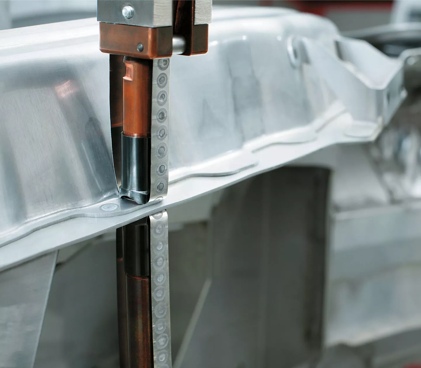

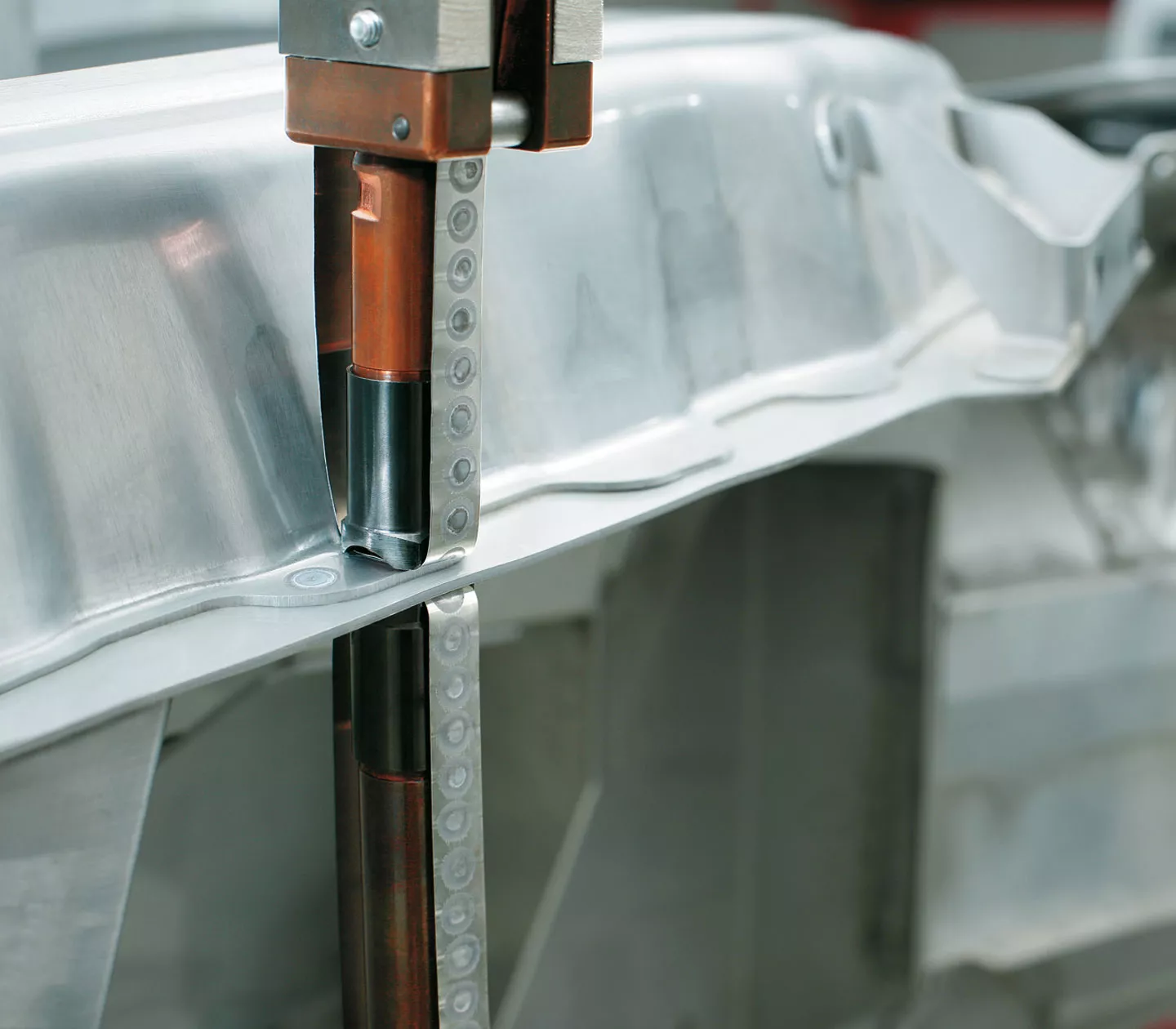

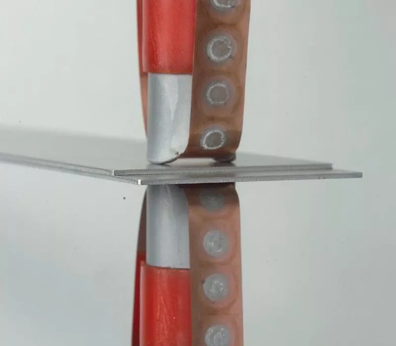

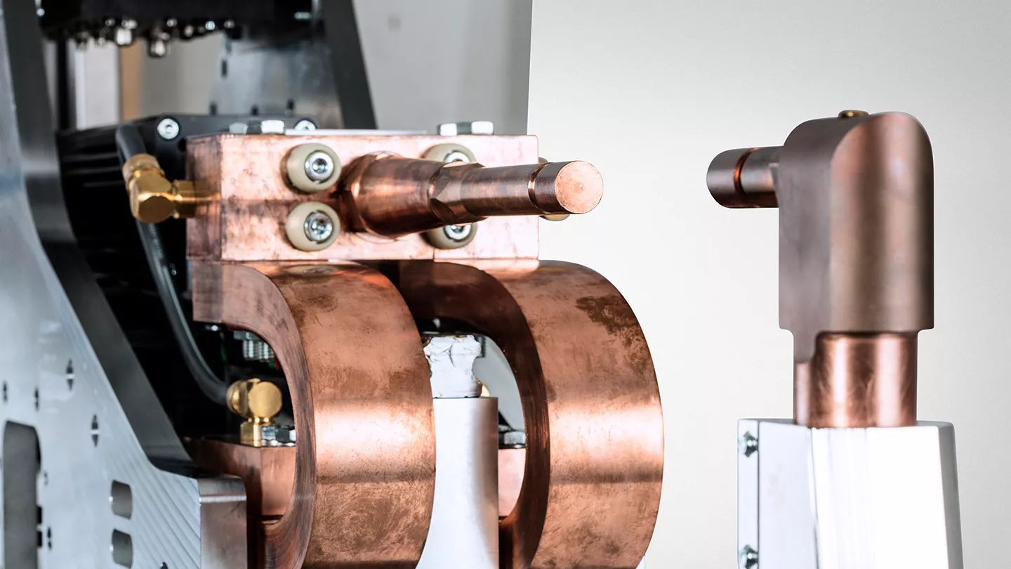

Resistance spot welding
The principle of resistance spot welding is based on current, resistance, and time. When maximum resistance is applied, the material fuses. Due to the high contact pressure, exerted by the effect of the electrode force, the components are welded together at their points of contact.
More on the topic of resistance spot welding
Reversed polarity ignition (RPI)
A reversed polarity ignition is a polarity reversal of the tungsten electrode to the positive pole in the ignition phase, in order to achieve a more accurate and stable ignition.

Robotic welding
In robotic welding, an industrial robot guides the welding torch within a preprogrammed track.
More on the topic of robotic welding
Electrodes
Rod electrode / electrode
Root pass
The root pass refers to the first bead that is introduced into the join during multirun welding. Fronius offers special characteristics with the ROOT characteristic for this purpose.

Smoothing choke
The smoothing choke slows down the current rise rate. For stepped welding systems, this is a coil with different choke draw-offs. The weld properties such as the ignition of the arc, handling of short-circuit incidents and faults are affected directly here.

Steeply drooping characteristics
When welding with rod electrodes and TIG, it is important to keep the welding current as constant as possible, even when the distance between the electrode and the workpiece changes. This is achieved by what are known as the drooping characteristics of the power source, whereby the amperage (ampere) does not change and the voltage (volt) rises/falls due to a change in distance.

Synchronized welding
This is a technical term from the discipline of TIG welding. Two welders join the workpiece in sync on both sides of the required joint. This practice is primarily used in pipeline construction, i.e., for circumferential welding.

Tandem welding
In tandem welding, two completely isolated wire electrodes are melted in a welding torch and a common weld pool. The process allows a particularly high deposition rate, which can be converted to welding speed or volume filling. This welding process is known at Fronius under the brand name TWIN.

TIG contact ignition
With conventional TIG contact ignition, the tungsten electrode is lifted off the workpiece. The preset welding start sequence then takes place.

TIG overlay welding
Tungsten inert gas overlay welding is universally applicable and is ideal for surfacing high-alloy metals and steels. The welding process provides high-quality surfaces that are clean and exact, with little spatter.

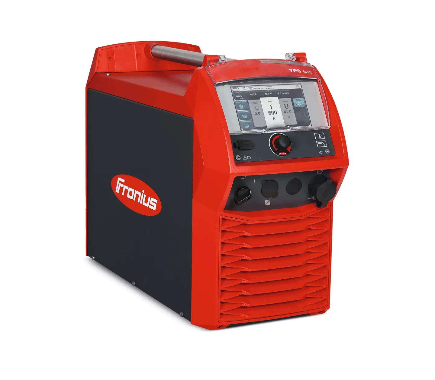

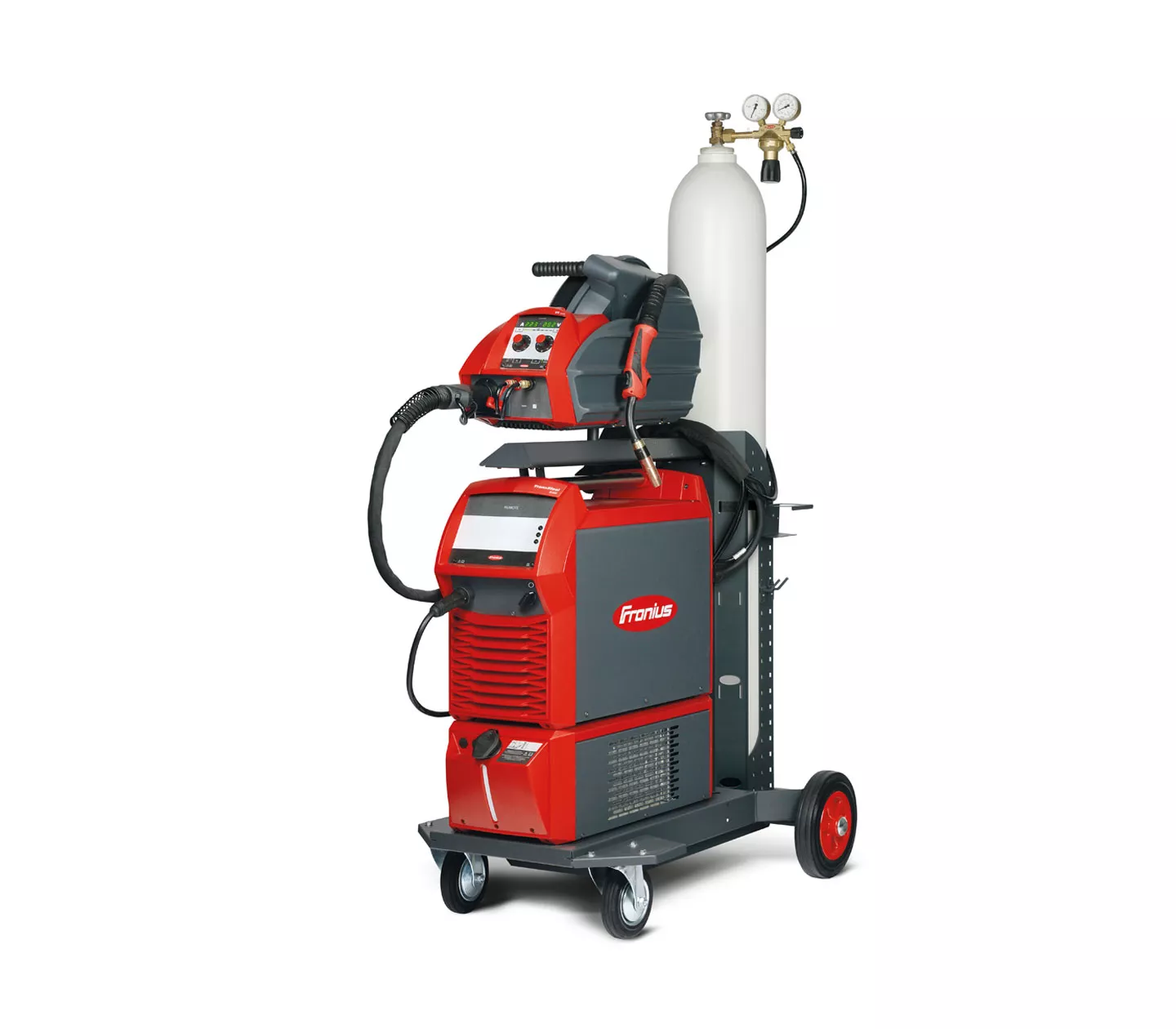

TPS/i, Revolución Inteligente
TPS/i
The devices are fully digitized, microprocessor-controlled inverter power sources. A universal controller controls the entire welding process. The actual data is measured continuously and the device responds immediately to any changes. Special rule algorithms ensure that the desired target state is maintained. The software system is the decisive factor for the weld properties of the power sources, not a rigid hardware system that can barely be changed. This results in high accuracy in the welding process, exact reproducibility of the welding results, and excellent operating characteristics.
More on TPS/i

Tungsten electrode
The tungsten electrode is a non-consumable electrode for TIG welding.
Additional information on tungsten electrodes

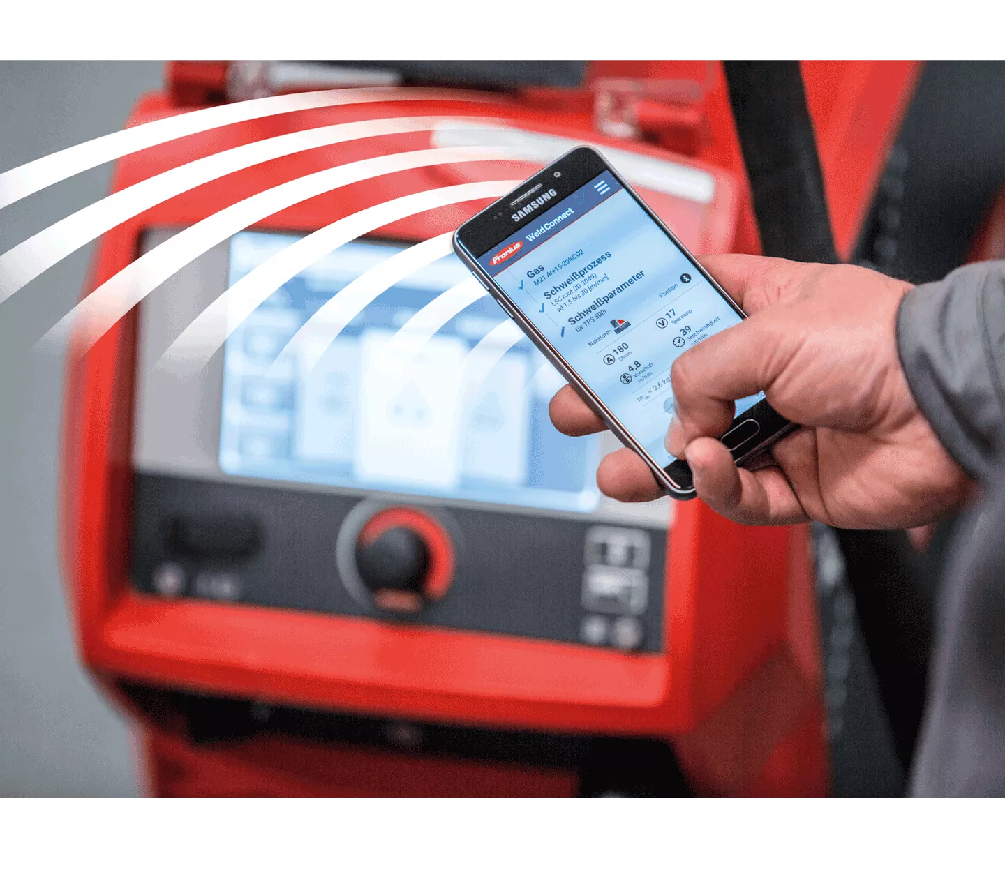

WeldConnect
WeldConnect is a platform for smartphones with integrated applications (apps) for the exchange of data. This is realized with the TPS/i series and to find parameters for MIG/MAG and TIG processes.
More on WeldConnect

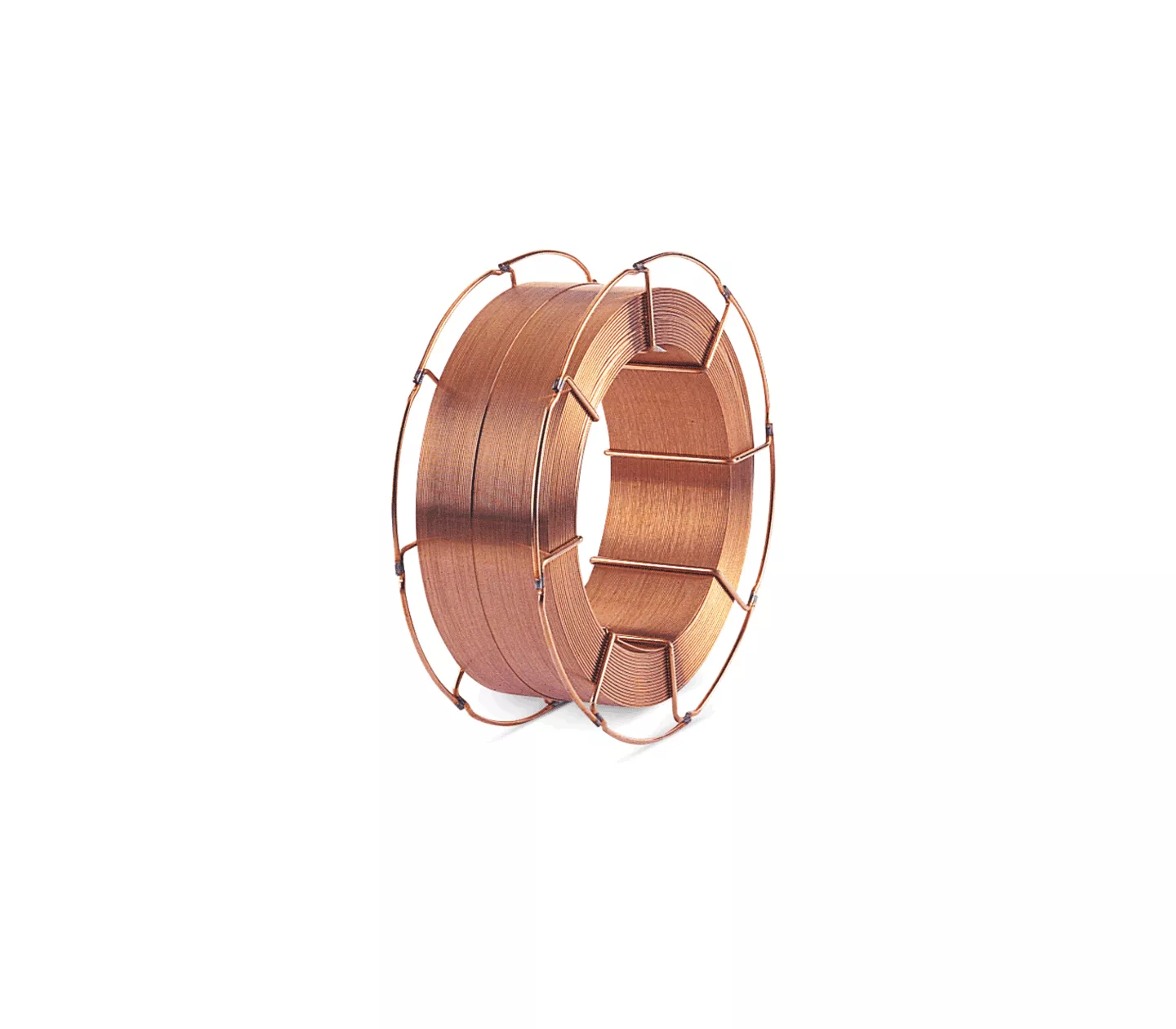

Welding filler metals
The welding filler metals melt during the welding process and form the weld seam. The selection of welding filler metals is primarily dependent on the parent material and use of the component. The corresponding characteristic must be selected in a material-specific and diameter-dependent way in MIG/MAG welding.

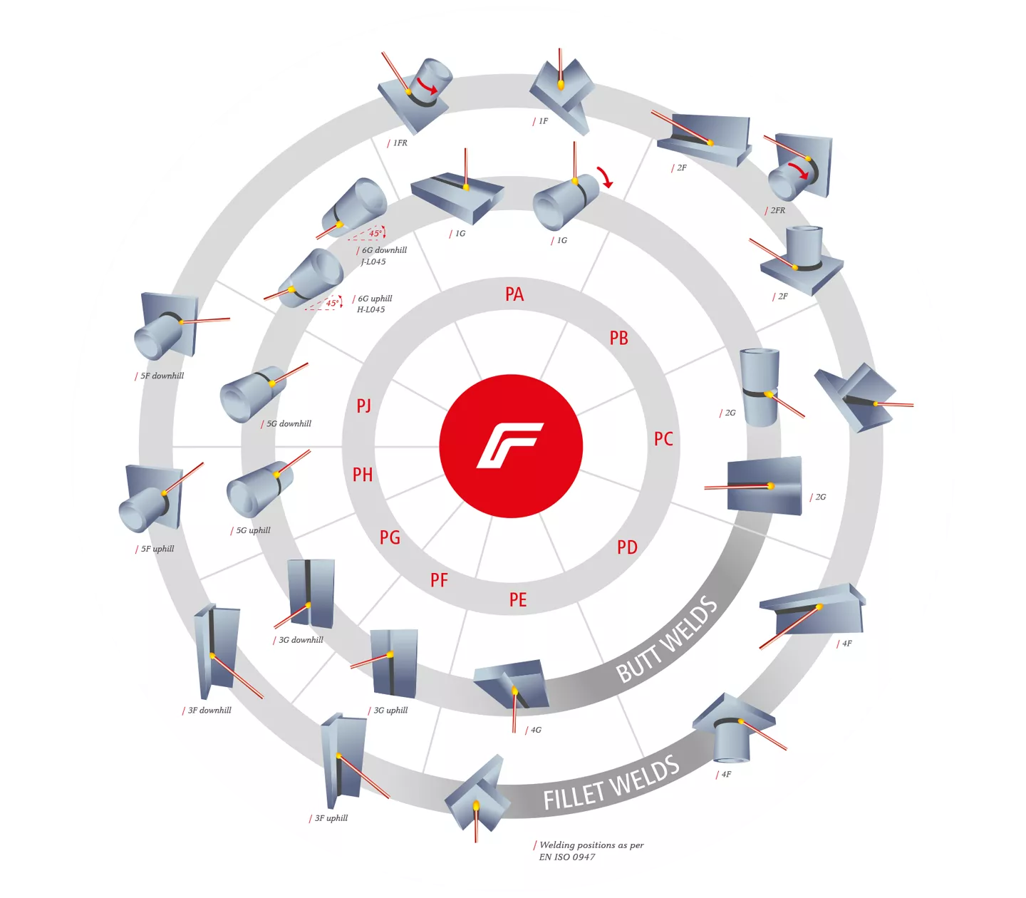

Showing different basic welding positions
Welding positions
In the discipline of welding there are different welding positions (PA – PJ) that indicate the position of the weld seam.

Welding rectifier
A welding rectifier converts alternating current (three-phase current) into direct current for welding. In general, older welding power sources with no power electronics are called welding rectifiers. (see figure)

Torch
Welding torch
The welding torch consists of a handle with connections, controls, valves, and replaceable gas nozzles. It is connected to the power source by a hose. The welding torch is used to transfer the welding current, and to transport the gas and the filler metal to the workpiece.

Weld pool backing
This is an aid made of suitable material that prevents the weld pool from dropping through during welding. It can also be used to form the root pass. The weld pool backing may consist of a ceramic material for manual welding, and stainless steel or copper for mechanized processes, depending on the application.
