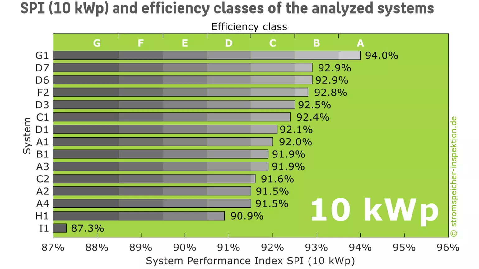

In the study, independent testing authorities
tested the overall efficiency of 21 home storage systems and analysed how the
PV systems and battery storage systems from the 14 participating manufacturers
perform in combination. The study underlines the importance of the energy
efficiency of the solar power storage units and notes: “In a less efficient system that was tested, nearly 1,100 kilowatt
hours are lost annually due to high conversion losses - 600 kilowatt hours more
than the winner from Fronius.”
The study calculates overall efficiency using the System Performance Index, or SPI. Two different reference cases were used for the assessment: One reference system combined a 10 kWp PV system with heat pump and electric car and assumes an average annual household consumption of 5,010 kWh/a. The second, more streamlined reference case analysed the SPI for a 5 kWp PV system with the same annual household consumption as in the 10 kWp scenario.
In the 10 kWp category, the combination of the Fronius GEN24 10.0 Plus hybrid inverter and the BYD Battery Box H11.5 performed extremely well and achieved a never before seen SPI value of 94%. It was the only combination in energy efficiency class A to secure first place and left the other systems trailing by a country mile. This duo also achieved excellent results in the 5 kWp class, scoring 92.3% - close behind the winner in second place. These two systems were the only ones to achieve energy efficiency class A in this category.
