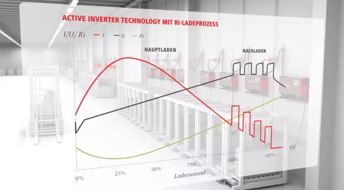

The savings potential for large traction batteries by harnessing the power of perfect charging technology is especially high. Fronius battery charging systems with the Ri charging process help the user in two ways. Firstly, the cool and ultra-gentle charging dramatically increases the service life of the expensive traction batteries. The user benefits from longer driving times and has to purchase replacement batteries less frequently. Secondly, Fronius devices reduce overcharging to a minimum, making energy consumption substantially lower. This guarantees significant cost savings, especially for batteries with a high capacity.
Unique Ri charging process
Only Fronius battery charging systems have the innovative Ri charging process, which adapts perfectly to every battery condition, making charging especially energy-efficient. Find out more
