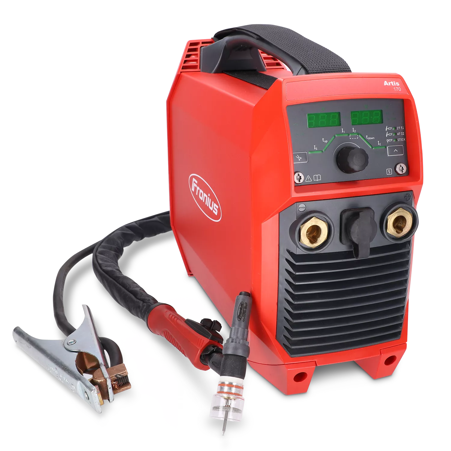

TECHNICAL DATA
Power Factor (pf)0,99
GENERAL DATA
Welding current min.3 A
Welding current max.210 A
Operating voltage min.10,1 V
Open-circuit voltage101 V
Degree of protectionIP23
Length
435 mm
Width
160 mm
Height
310 mm
Weight9,7 kg
Weight9,7 kg
Contact
Find out more about the features of the Artis welding machine.
Current firmware and software updates for the Artis.
Function overview
Functions
Artis 170/210 Artis 170/210 XT
TAC function x x
TIG Pulse x
Touch HF ignition x
HF ignition x
TIG Comfort Stop
Spot and stitch welding
MMA and Cel welding x
MMA Pulse x
Anti-stick function x
HotStart function
TrackingArc x
Generator-compatible x
Adjustable time shutdown/standby mode x
Multivoltage
