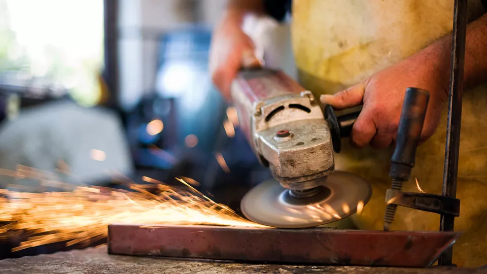

This is how to prepare steel for welding
  • Clean
    Before welding, remove coarse contamination from the steel in order to achieve good results.
  • Remove rust
    Remove rusty areas in the parent material before welding so that no bonding flaws occur in the weld metal.
  • Remove oil or grease
    Oily parent material makes the welding process more difficult and may, among other things, cause poor results. You should therefore remove the oil from the steel before welding.
  • Preheat
    In the case of higher material thicknesses, you should preheat the component before welding in order to slow down the cooling time. This protects the material and prevents cracking.

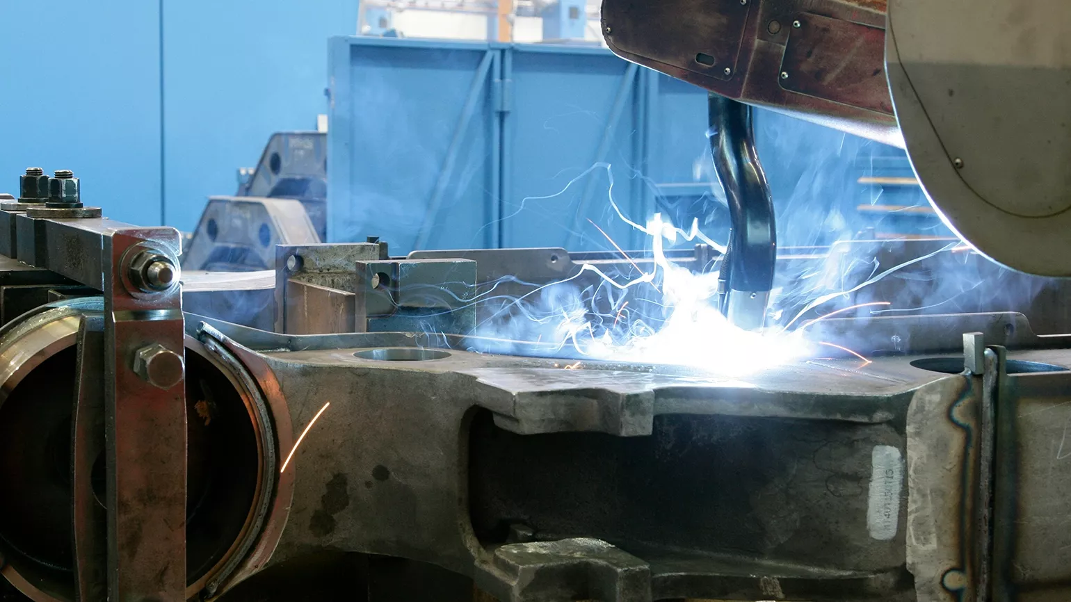

Welding process for steel
In principle, all welding processes are suitable for joining steel. However, the MIG/MAG process is primarily used because this allows for the highest welding speeds.
