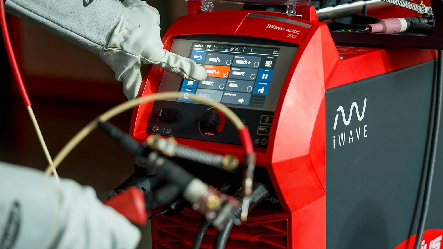

TIG cold-wire components are available now for Fronius iWave. The pioneering innovation lies in its intelligent control. With the patented new TIG DynamicWire welding package, even amateurs can achieve perfect TIG welds with ease. This is because the dynamic wire control always selects the right travel speed. The process adapts to the welder, not the other way around!
TIG welding represents the top tier of welding processes and demands skill as well as years of practice – or does it? “All the new features that we’ve packed into the iWave cold-wire components as well as the corresponding software solution make TIG welding significantly easier,” explains Manuel Rumpl, Head of Strategic Product Management Industrial Welding Solutions, Fronius International GmbH. “Thanks to TIG DynamicWire, welders can focus all their attention on the arc and the welding system regulates the optimal wire speed at all times.”
The iWave power categories from 300i to 500i can be upgraded to the TIG cold-wire system. The TIG DynamicWire welding package is ready for use immediately by means of software activation and can also be retrofitted to existing iWave systems at any time.
Market innovation: active wire control
The innovative advantage of Fronius DynamicWire compared to a conventional continuous wire feed lies in its automatic self-regulation. The welding system actively adjusts the wire speed to the welding behavior, torch position, and current conditions, even automatically compensating for component tolerances of up to 30%. The result? Perfect welds every time.
Precise and user-friendly
During development of the cold-wire system, no detail was too small for Fronius when it came to ensuring that welders could work optimally with minimal steps and adjustments. The wirefeeder is set once and then remains in a stable position. The ergonomic and flexible tungsten holder is particularly lightweight as it is produced using material-saving aluminum 3D printing. There are also no disturbing vibrations at the torch handle, as – unlike with comparable solutions – the mechanical forward and backward motion of the wire has been dispensed with entirely with the new TIG DynamicWire cold-wire welding process.
Change the tungsten electrode at the touch of a button
With the Tungsten Fast Clamp system (TFC), welding expert Fronius is bringing out another new patent. A single touch of the button releases and clamps the tungsten electrode in the spring-loaded clamping sleeve. Like the lead of a mechanical pencil, the electrode is changed in a matter of seconds. This system can now also be mounted on existing torch bodies.
Self-regulating, time-saving, and resource-conserving
In times of skills shortages, iWave complete with cold-wirefeeding and TIG DynamicWire can help all TIG novices and those with less experience achieve a great welding result and fast. Self-regulating parameter settings and characteristics as well as a compensatory active wirefeeder provide the necessary safety and ensure a high level of quality.
Since the wire does not continuously move back and forth during intelligent TIG cold-wire welding, even wear parts such as the torch body, torch cap, and clamping sleeve experience reduced abrasion and last longer than comparable solutions.
