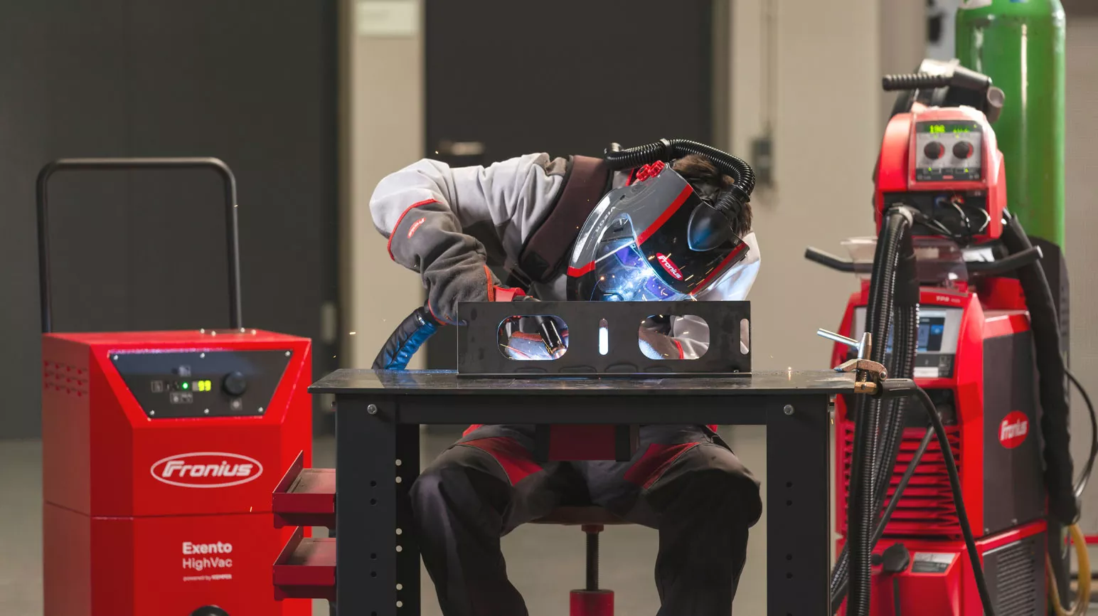

If, on the other hand, the welding process is optimized using arc length correction and a fume extraction torch, such as the Fronius MTW 500i Exento in combination with a Fronius Exento HighVac extraction system, then up to 99% of welding fumes can be extracted.
High-performance and precise extraction
Fume extraction torches prevent the welding fumes from dispersing at the point where they are generated – at the weld pool itself. They not only protect welding specialists when they are welding, but also anyone else who is in the vicinity of the workpiece.
Since it is important welders are not adversely affected by a complex design in terms of their health and productivity, Fronius has paid particular attention to ergonomics when developing its fume extraction torches. They sit perfectly in your hand when welding, while an LED lamp facilitates welding in dark environments and supports quality control.
Exento fume extraction torches meet the requirements of standard DIN EN ISO 21904-1 Health and safety in welding and allied processes.
