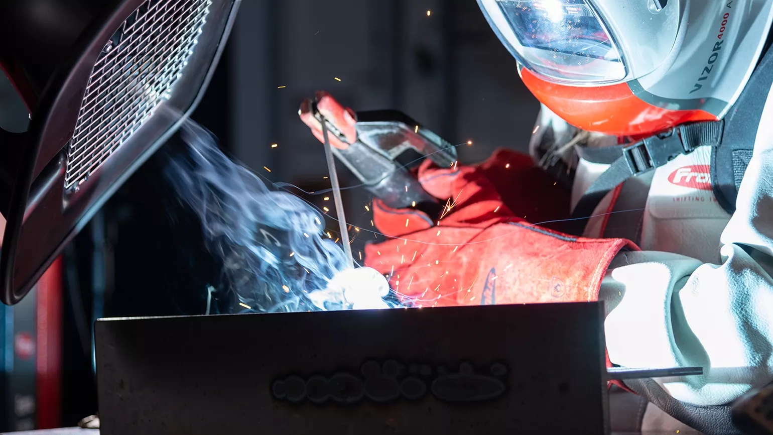

Stick welding
Electrical current and heat, UV radiation, and, above all, increased welding fume formation are everyday risks during manual arc welding. The type of hazardous materials in the welding fumes is crucially dependent on the material of the electrode and itscoating.

High vacuum extraction
Combining the fume extraction torch with the high vacuum extraction was particularly effective when using lower welding power and emissions. In these cases, the fumes spread directly around the welding point and can be extracted perfectly with the fume extraction torch.
Low vacuum extraction
In the comparison test, the low vacuum extraction system with flexibly adjustable extraction arm and extraction hood ensured a significant reduction in welding fumes. However, the extraction arm must always be in the correct position. In contrast to the PAPR system, all welding personnel are protected.
