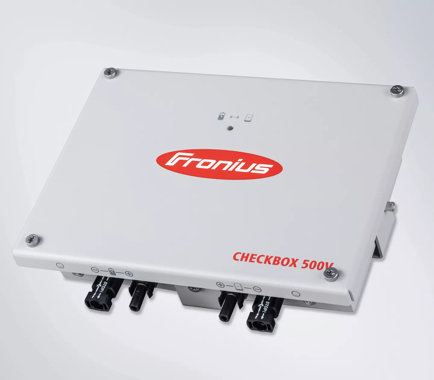

Fronius Checkbox 500V
The Fronius Checkbox 500V guarantees the operational reliability of the storage solution together with the Fronius Symo Hybrid and the compatible LG Chem RESU battery.
