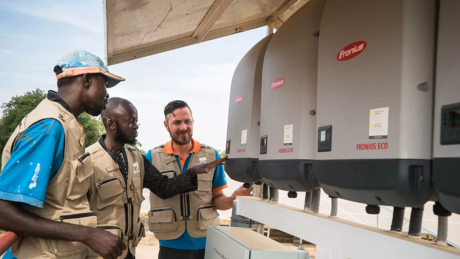

Fronius inverters are known for how easy they are to install, with the Fronius Eco inverters being commissioned by local installers. Should servicing or maintenance be necessary, the local installers can repair the device without delay thanks to the PC board replacement technology. With Fronius inverters, you do not need to replace the entire device, but only one PC board. This saves on ongoing operating costs, as a single service technician only needs to be called out once to perform the necessary work.
Active cooling increases service life
The Fronius inverters were installed at the fish farm in an outdoor location. With an IP 65 protection class, this is no problem. Yet the real showstopper is the active cooling technology, which means the inverters can produce maximum yields even at high outside temperatures, as the derating process is not activated until much later.
Furthermore, active cooling extends the service life of the inverter by keeping the temperature of the power electronics constantly low. Unlike inverters with passive cooling technology, Fronius devices do not have to be regularly serviced. This has a positive effect on the long-term operating costs and results in the PV system paying back its installation costs more quickly.

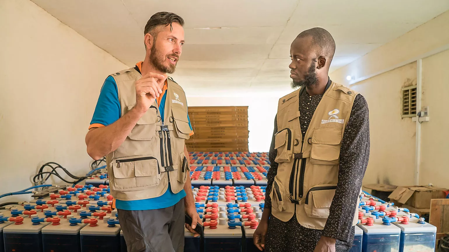

  • 120x 2 V/3000 AH OpzS Batteries
