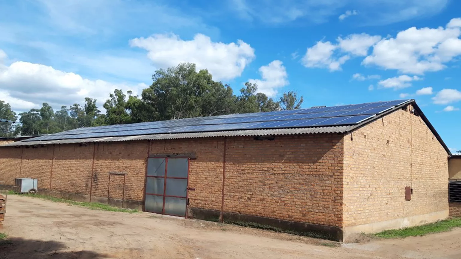

A tobacco factory in Zimbabwe has been using a PV system coupled with a 150 kVA diesel generator for several years. Following the completion of a capacity upgrade project, the system will ultimately be able to save up to 60 % in their previous daily fuel usage, which could work out to as much as 100 litres of fuel a day or more. The system was installed and commissioned by local Fronius System Partner James Davy, supported by OneStopSolar.
Easy installation, easy expansion of a solar/diesel hybrid system
“The aim is to gradually expand the energy system at the tobacco factory,” says James Davy, who heads up the solar company that installed the system “First, we added a 45 kWp PV system to a 64 kVA Genset. A 150 kVA Genset followed and we hope that an additional 35 kWp of PV output will be installed.”

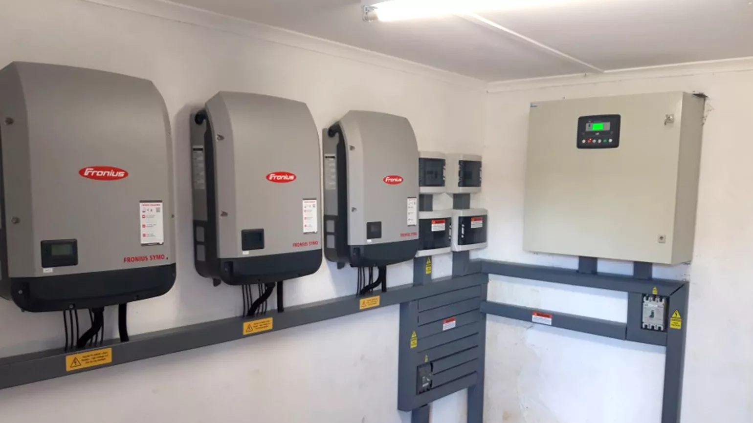

The solar/diesel hybrid system consists of Fronius inverters, Fronius PV System Controllers, a diesel generator and current sensors.
“It’s important for us to be able to install the system ourselves. The success of the installation stands and falls with the communication between the individual components. As a trained Fronius System Partner, we can set up the system to deliver its optimum potential. And if we still need assistance, we can contact the Fronius technical support team both at Fronius and OneStopSolar,” says James Davy.

Type of system Fronius PV-Genset Easy
System size
45 kWp PV system, additional 35 kWp will be added, 150 kVA Genset
Components used  3x Symo 15.0-3-M in combination with a Fronius PV System Controller
Commissioned  March 2020
Annual yield  Approx. 80,000 kWh
Special feature
100 litres daily diesel savings
