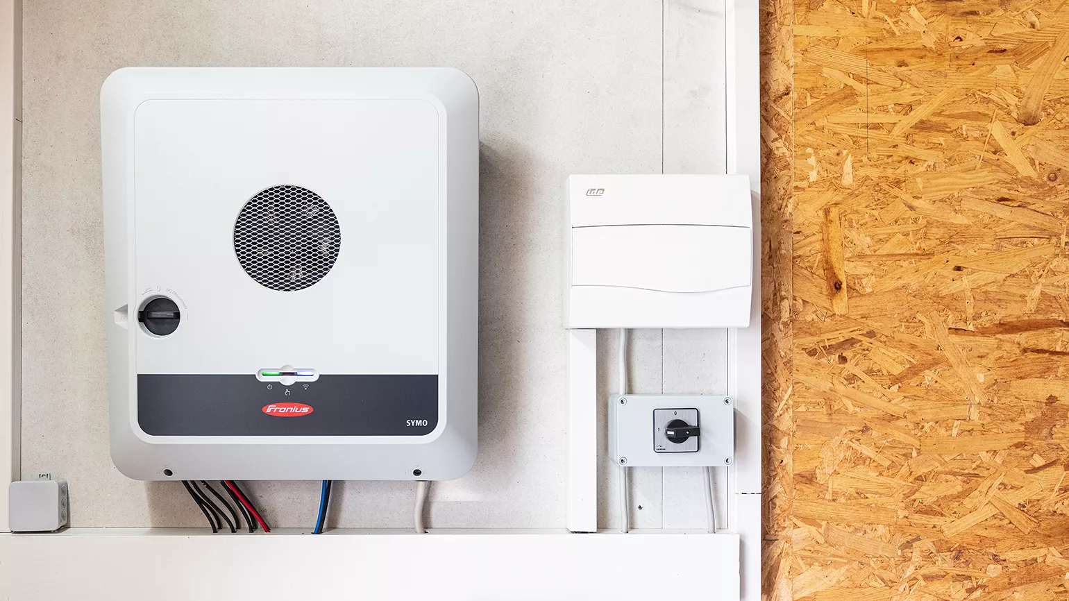

It’s important to note that not all photovoltaic systems automatically continue to generate energy during a power outage. Systems with ‘PV only’ inverters lack additional components such as relays or mains protection, which means they cannot establish a stand-alone network. However, if you have a hybrid inverter with a backup power function, then you are equipped for all (power outage) scenarios. Fronius offers the GEN24 Plus and Symo Hybrid backup power-capable hybrid inverters, for example.

Supplying an entire household in the event of a power outage – including three-phase loads such as electric cookers or heat pumps is also referred to as ‘Full Backup’ by Fronius. This is most useful when combined with a battery.
For those who would like to start with something a bit smaller, the Fronius GEN24 Plus also offers a special basic backup power option, called ‘PV Point’. In this case, a socket in the house is directly controlled by the inverter and then (only) supplied in the case of a power outage. This option is an inexpensive solution if you only need one source of power and don’t require any additional installation work in the switch box – as is the case with the ‘Full Backup’.
