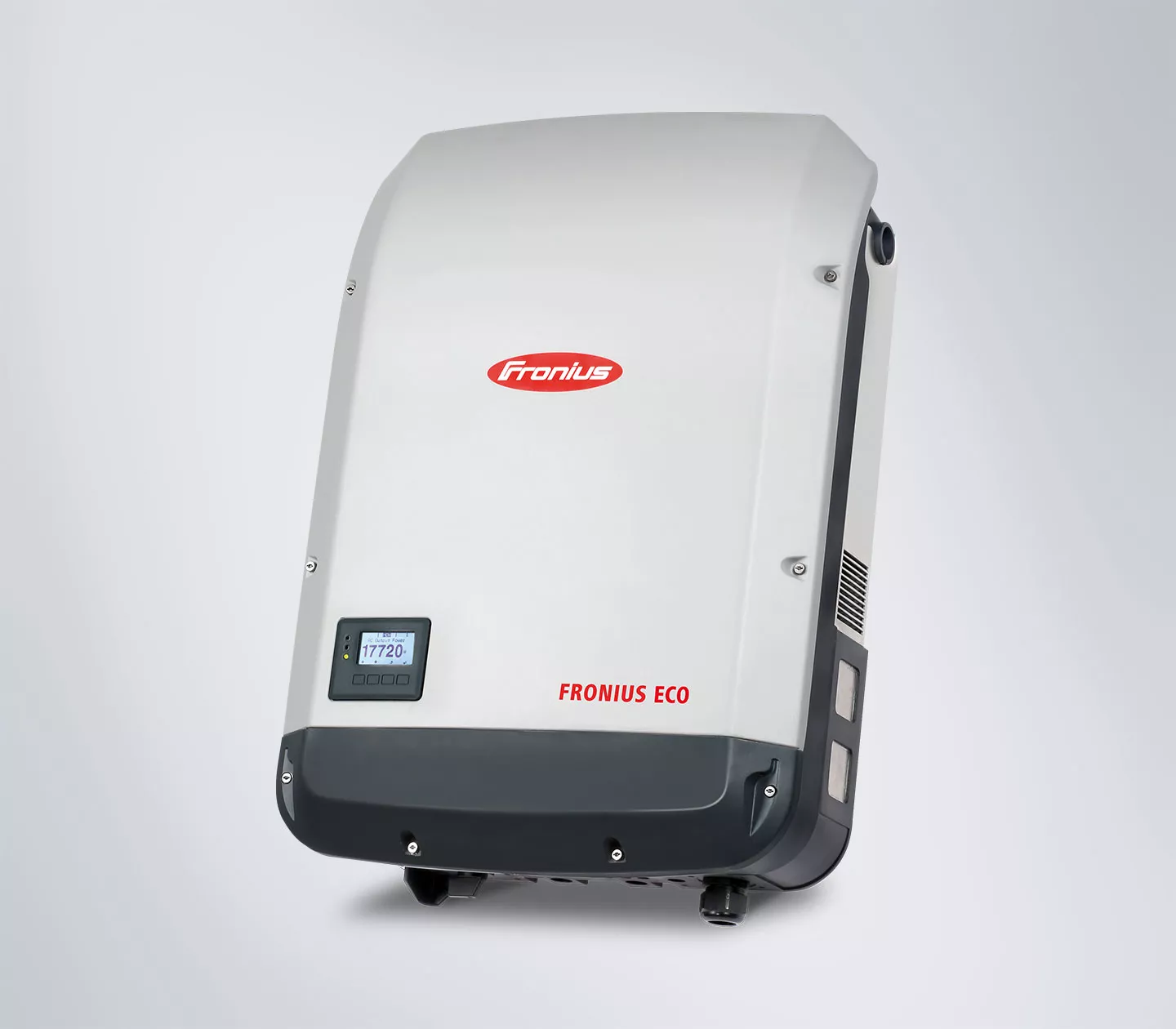

The solutions provider Fronius is launching the latest addition to the SnapINverter range in May 20151. Available in the 25.0 and 27.0 kVA power categories, the Fronius Eco string inverter delivers maximum yields, especially for large-scale PV projects into the megawatt range.

Its lightweight design (weighing just 35.7 kg) and tried and tested SnapINverter mounting technology make for quick and easy installation. With the highest average power density in its power category, the Fronius Eco is sure to impress.

The efficiency level of 98.3 percent is unique in the project area. Another highlight is the ability to connect up to six strings directly to the inverter, meaning that the system operator no longer requires additional DC or combiner boxes. The integrated fuse holder provides all-pole fuse protection for all six strings, and optional overvoltage protection is available for the DC side.
