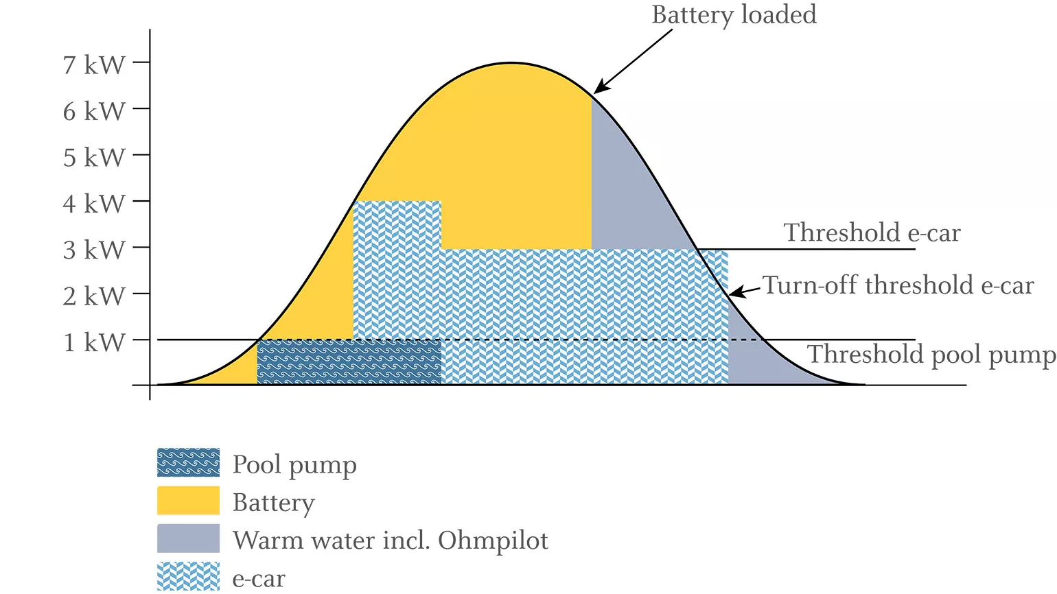

It is now possible to assign different levels of priority to the digital outputs, the Fronius Ohmpilot and the battery. For example, if there is a pool pump, a wallbox used to charge an electric car, a battery and a Fronius Ohmpilot, the order of priority could be as follows:
Priority 1: Load management with four digital outputs
Priority 2: Battery
Priority 3: Fronius Ohmpilot
The consumers connected to the four digital outputs are the top priority and are prioritised within themselves according to their set switch-on threshold, which means that the consumer with the lowest power will be switched on first. In this case, this is the pool pump (1 kW), followed by the wallbox (3 kW) used for charging the electric car. The rest of the energy is stored in the battery, so that solar energy can be used during the evening and at night. Finally, any remaining energy is used by the Fronius Ohmpilot to heat water. The energy is therefore stored in the form of heat in the water.
