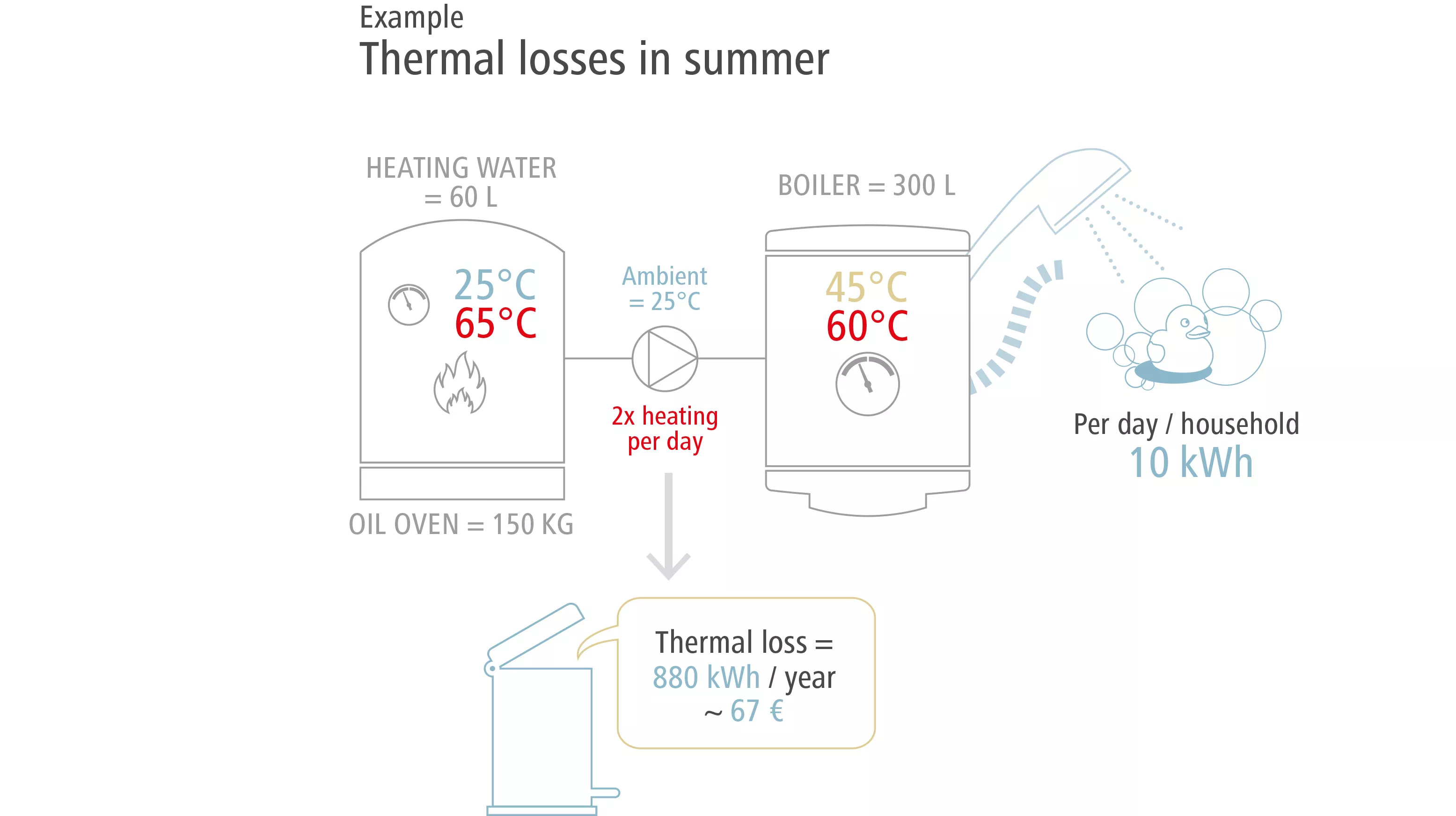

Example:
Oil stove with 60l water jacket 300l boiler, consuming 10kW/day of hot water means that the stove needs to be brought up to temperature twice a day. Thermal losses resulting from hot water production alone in summer = 880kWh/year, ~ €67!
