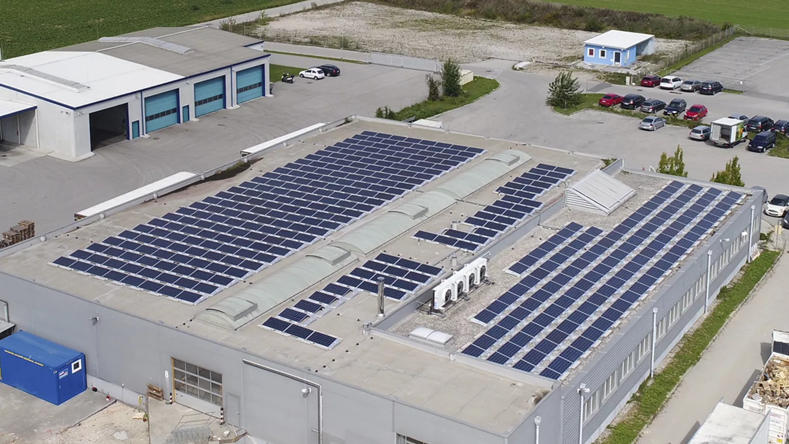

The concept of sustainability is at the heart of Biohandel GmbH run by the Pichler family. Only organic fruit and vegetables are supplied from Hörsching to food retailers, healthcare facilities and businesses. The cooling of the foods requires a huge amount of energy – 40% of which has been generated by the company itself since July 2018. The business also takes a sustainable approach to transport; there are three electric company cars on site, which are charged with the self-generated PV energy.
10,000 EUROS SAVED YEAR ON YEAR
The biggest electricity load at the retailer is the cooling system in the warehouse. However, it is possible to cover 40% of the energy requirements with solar energy thanks to the roof-mounted PV system. “The PV system is ideal for us. We require a particularly large amount of electricity for cooling when the sun shines, so it makes sense to use the energy for our own load consumers,” says managing director Gerhard Pichler. “The investment costs for the system will be recouped in 5 to 6 years.”

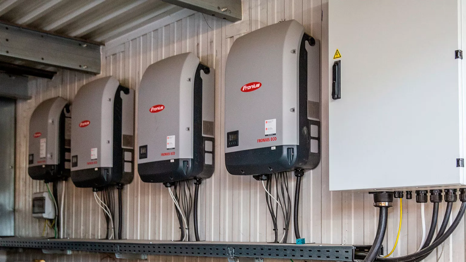

Inverters 1 Fronius Symo 6.0-3-M, 3 Fronius Eco 27.0-3
Solutions for e-mobility Keba Wallbox integrated in the system
