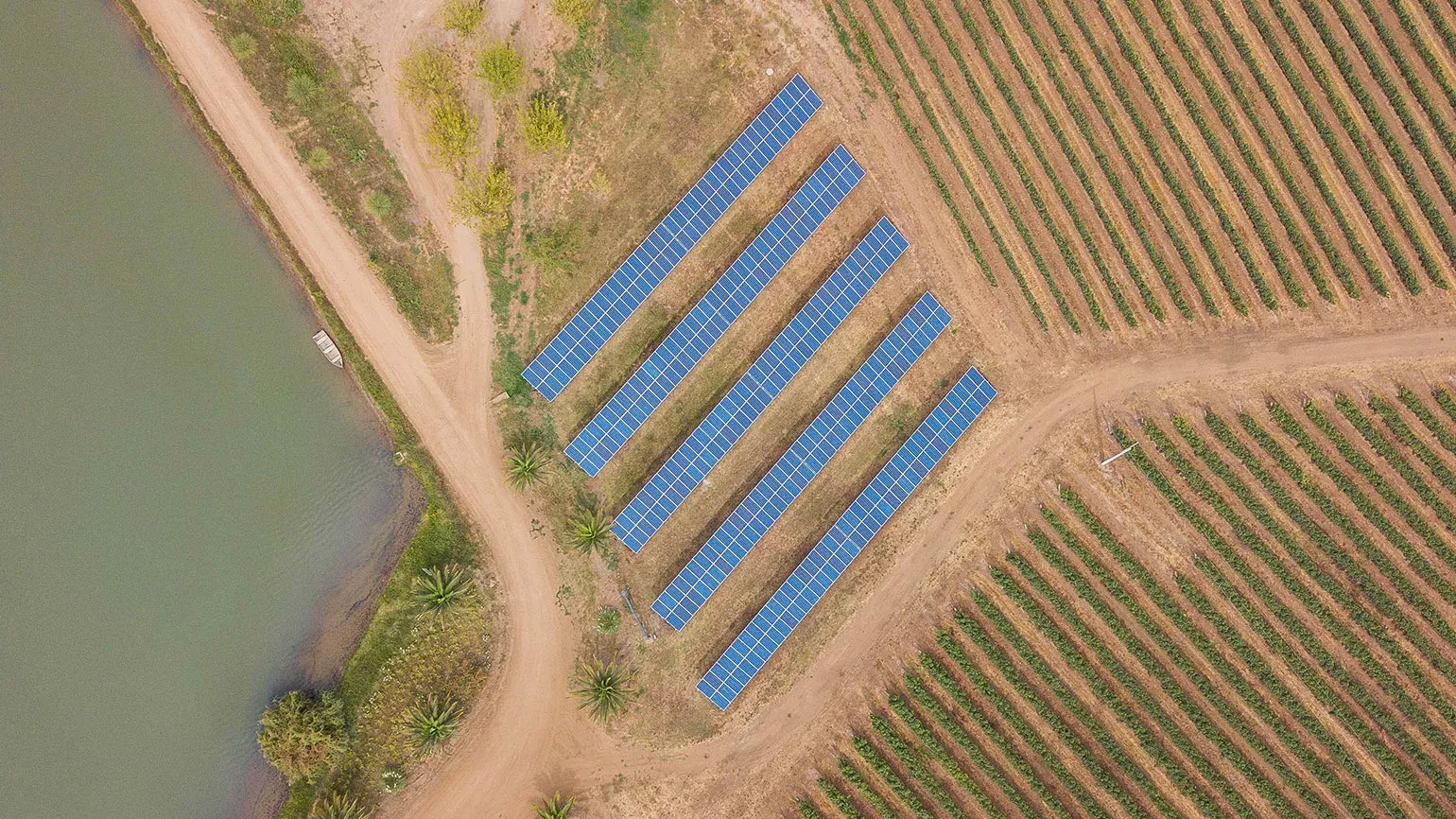

A high level of insolation and the geographical situation in Chile provide ideal conditions for both winemaking and generating solar energy. Vineyard Vina Aresti has decided to take advantage of this situation by installing a 130 kWp PV system on its land. The roughly 206 megawatt hours of energy generated each year is used to irrigate the fields and to produce wine, meaning that the PV system achieves an impressive self-consumption rate of 92 percent.

Size of installation 130 kWp
System type Field installation
Inverter 4 Fronius Eco 25.0-3-S
Commissioned October 2018
Annual yield Approx. 206 MWh
Specialty Self-consumption rate of 92%
