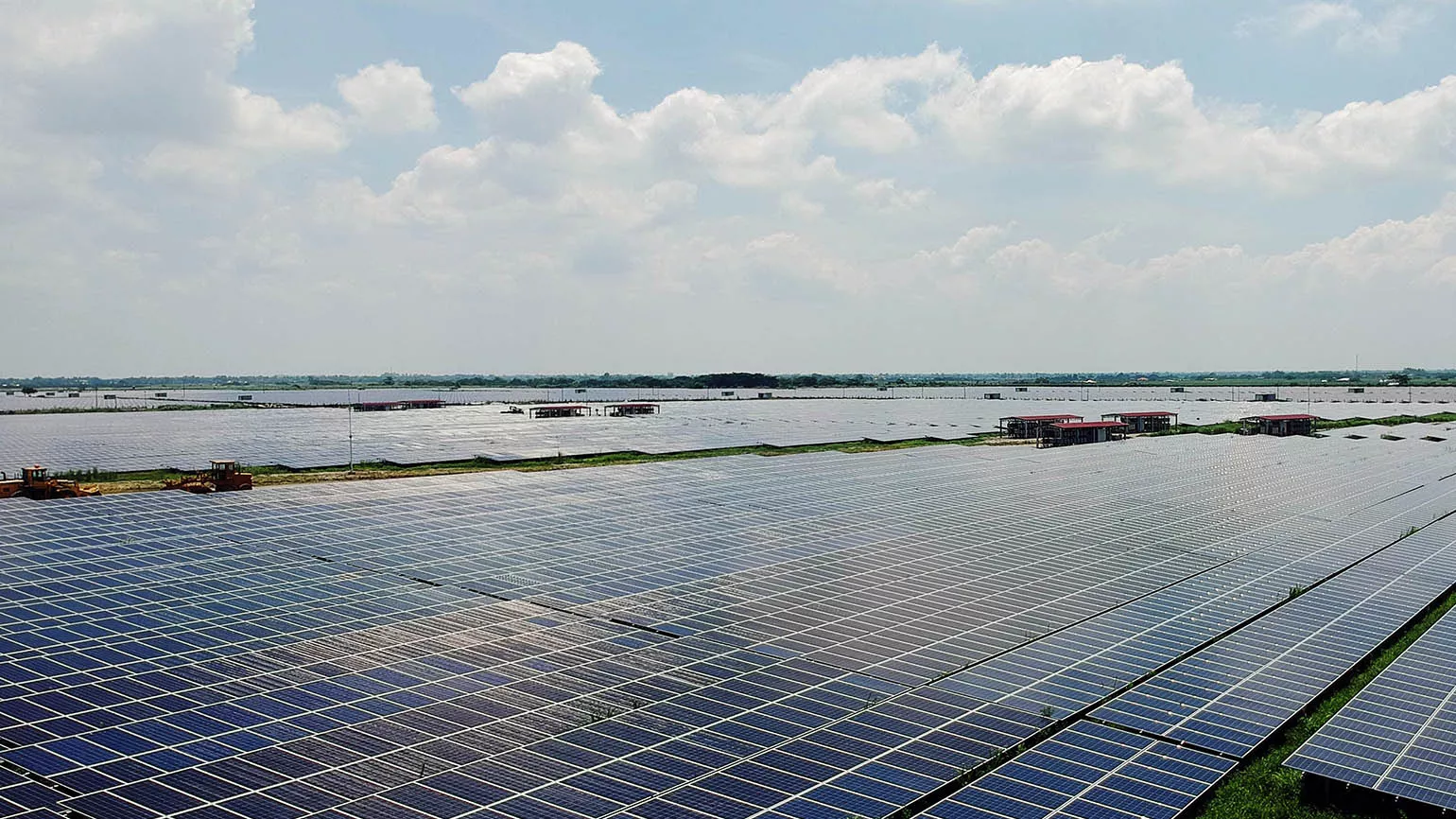

In April 2019, a 20 MWp system with Fronius Eco inverters was brought on line. A total of 612 inverters and 61,200 solar modules had been installed in just five months.

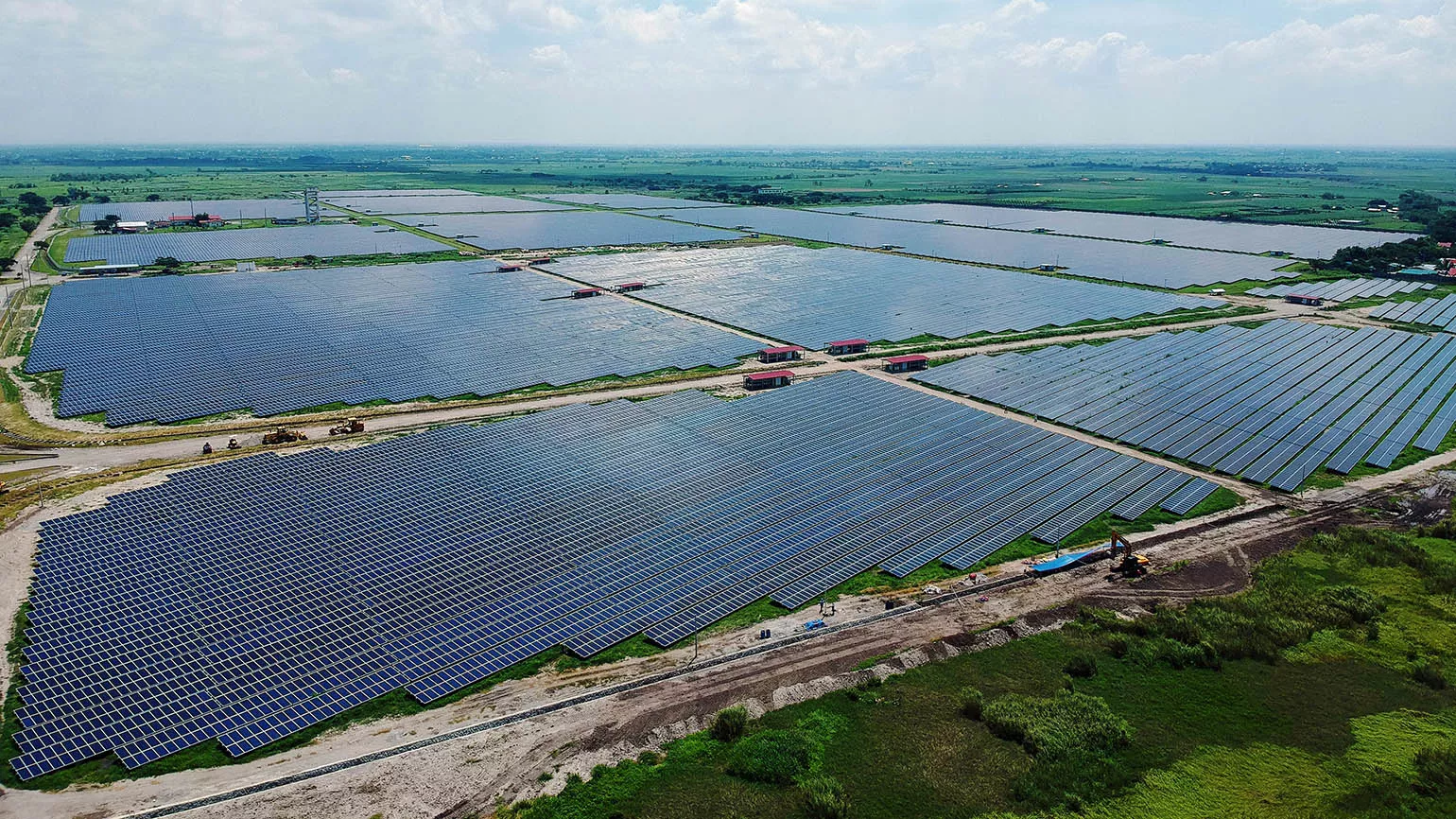

In April 2019, a large 20 MWp system with Fronius Eco inverters was brought on line. A total of 612 inverters and 61,200 solar modules had been installed in just five months.

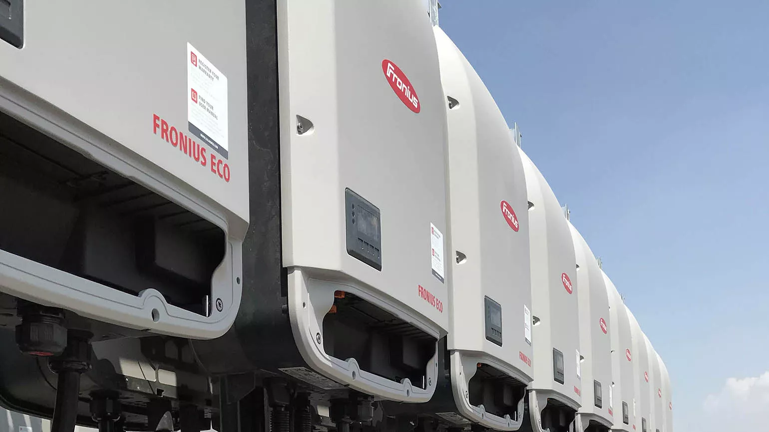

Using string inverters in this size of installation is quite unusual. The fact that Solenergy Systems opted for the Fronius Eco devices brings huge benefits in terms of yield: “Due to the number of inverters, the system works more efficient than it would do with central inverters. This is as the Ecos are better able to deal with conditions such as partial shade, uneven ground and solar module soiling. This 20 MWp Fronius plant has a 50 MWp sister plant using central inverters located beside it. The Fronius plant synchronizes earlier and de-synchronizes later than the central inverter plant - by a full hour! That's more kWh for the client and a greater confidence for us in meeting our guaranteed annual outputs." explains Alidon.
Each year the system will produce 32,000 MWh of clean electricity, which corresponds to a CO2 reduction of 18.6 million kg.

612 Fronius Eco 27.0-3-S
