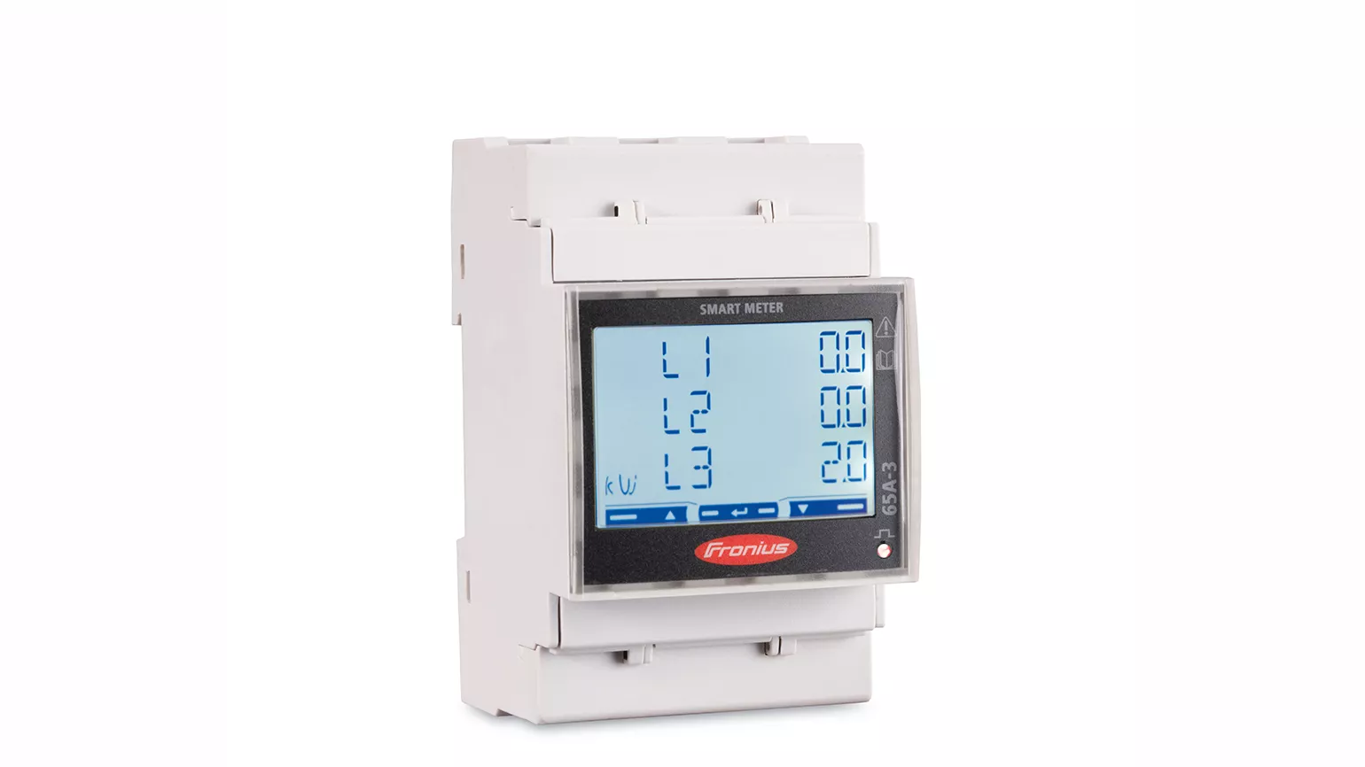

Fronius Smart Meter
The Fronius Smart Meter visualizes the energy flow of the facility. We recommend installing the Fronius Smart Meter in series to the utility meter. In this scenario the Fronius Smart Meter is able to monitor the ingoing and outgoing energy flow of the facility.
