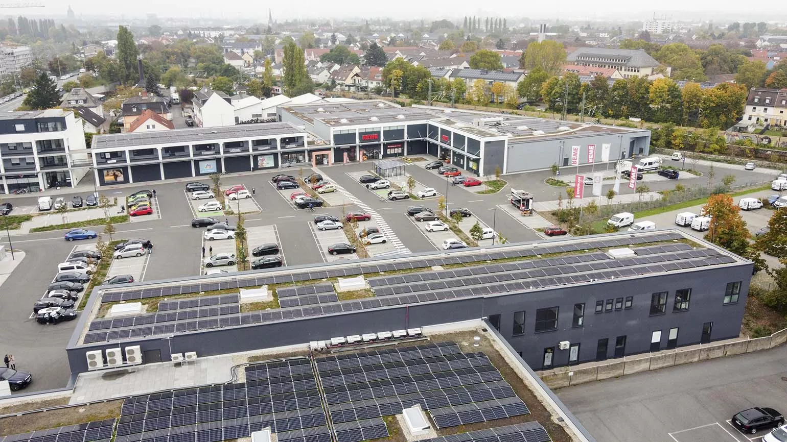

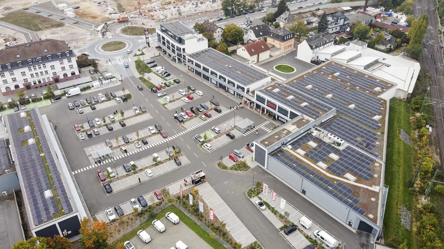

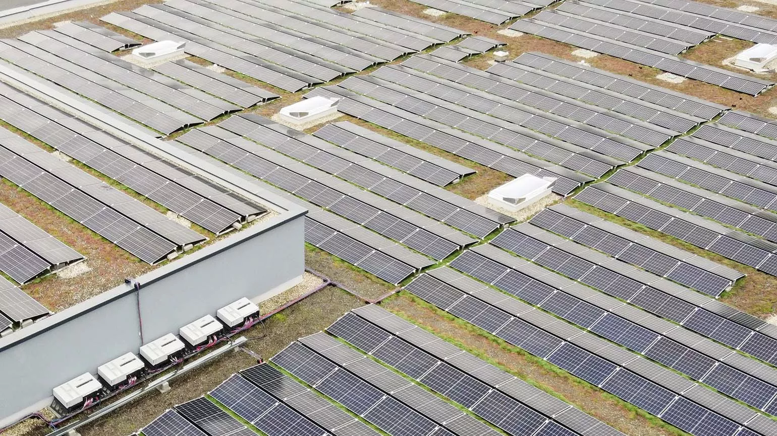

The solar charging park is the first of its kind in Germany and a truly pioneering project in terms of sustainable economic efficiency. A photovoltaic system featuring an impressive 2,300 modules as well as 16 km of PV cable and 1 km of data cable was installed on the roofs of the surrounding buildings. The system generates approximately 900,000 kWh of solar power annually – a gigantic amount of energy that could power a single electric car for an incredible 5 million emission-free kilometers.

Fronius inverters form the core of the high-output, 1,000 kWp PV system

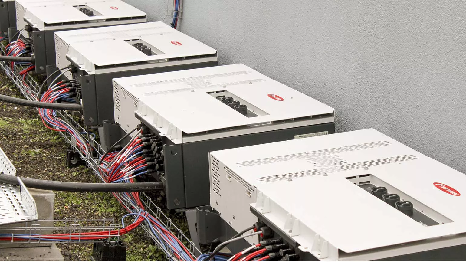

12 Fronius Tauro inverters and 2 Fronius Symo inverters were installed for the large-scale project. The ideal choice for this exceptional project, these rugged project inverters not only offer maximum flexibility in system design but also consistently deliver maximum output even under the most adverse environmental conditions – and also don’t require any overhead protection outdoors. What's more, the Fronius inverters used can be quickly installed and maintained. If necessary, only the replacement components need to be replaced on the Fronius Tauro, and not the entire inverter. This makes it even more economical to operate the large-scale PV system for the solar charging park, while also trimming total system costs to a minimum.

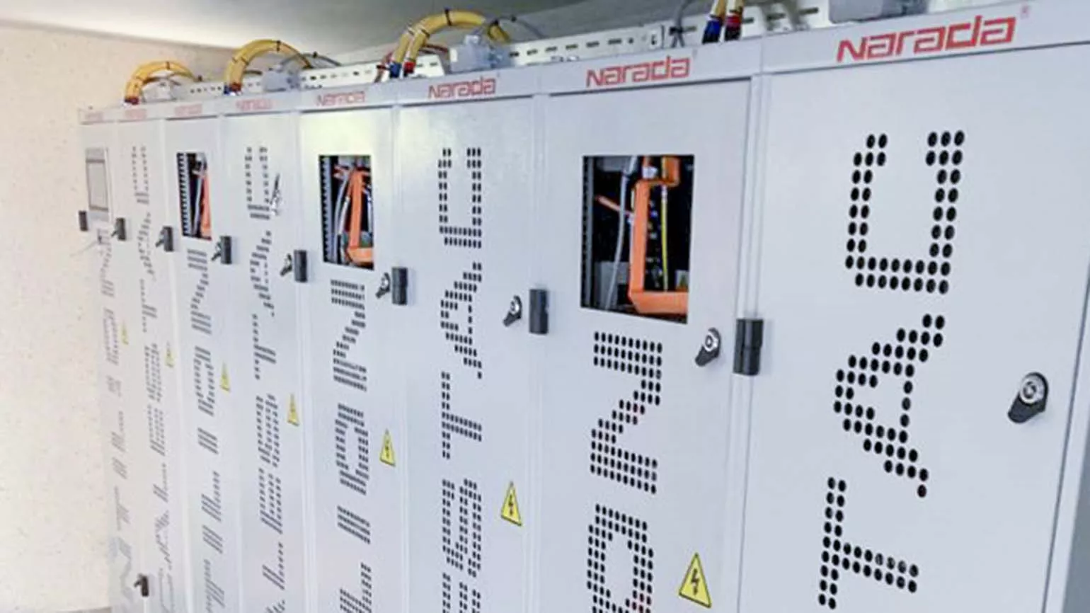

The concept for the Mainz-Kostheim solar charging park has a unique selling point: instead surplus solar power being fed into the public grid, it gets stored at the site in large battery storage units with a capacity of 560 kWh. “This lets us ensure that more than 80% of the electricity we put into the electric cars is generated by the sun,” explains Christoph Hesselmann of Opel Energy GmbH, which built the charging park. In the next few years, this is expected to increase to a full 100%.

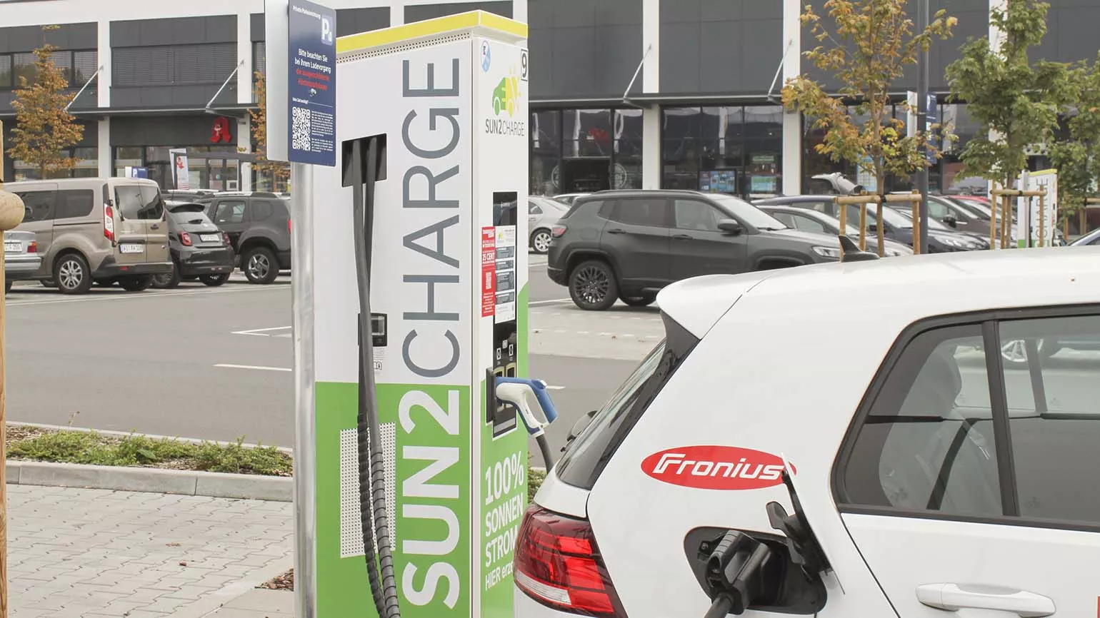

10 charging stations with 2 charging points each are now available to customers of the local shopping center for charging their electric cars while they shop. To achieve this, the output of the charging infrastructure was optimized to match the way the typical shopper charges: “After a 45-minute shopping trip, an electric vehicle is charged on average from 20% to 80%. So the charging points are ideally aligned to use the shopping time for charging the electric car,” says Christoph Hesselmann, explaining the choice of charging infrastructure. While systems with even higher charging capacity are available, they would not directly enhance the added value of the charging park and would instead merely result in higher investment costs.

Only a minimal part of the public infrastructure is used for operation of the solar charging park. This makes it a prime example of a completely self-sufficient micro-power solution. Falling back on the public electricity grid will only be necessary if the PV system fails to produce a yield or all the storage units are completely empty – an unlikely scenario, according to Christoph Hesselmann: “Thanks to our intelligent power management, we don’t expect this to happen, especially in the first few years. So we're basically functional even if the infrastructure around us collapses.” The much-discussed and often-cited phrase “grid overload” in connection with electric mobility therefore plays no role at the solar charging park in Mainz-Kostheim. That’s a reassuring thought for the operators, but also for the users from the surrounding area.
