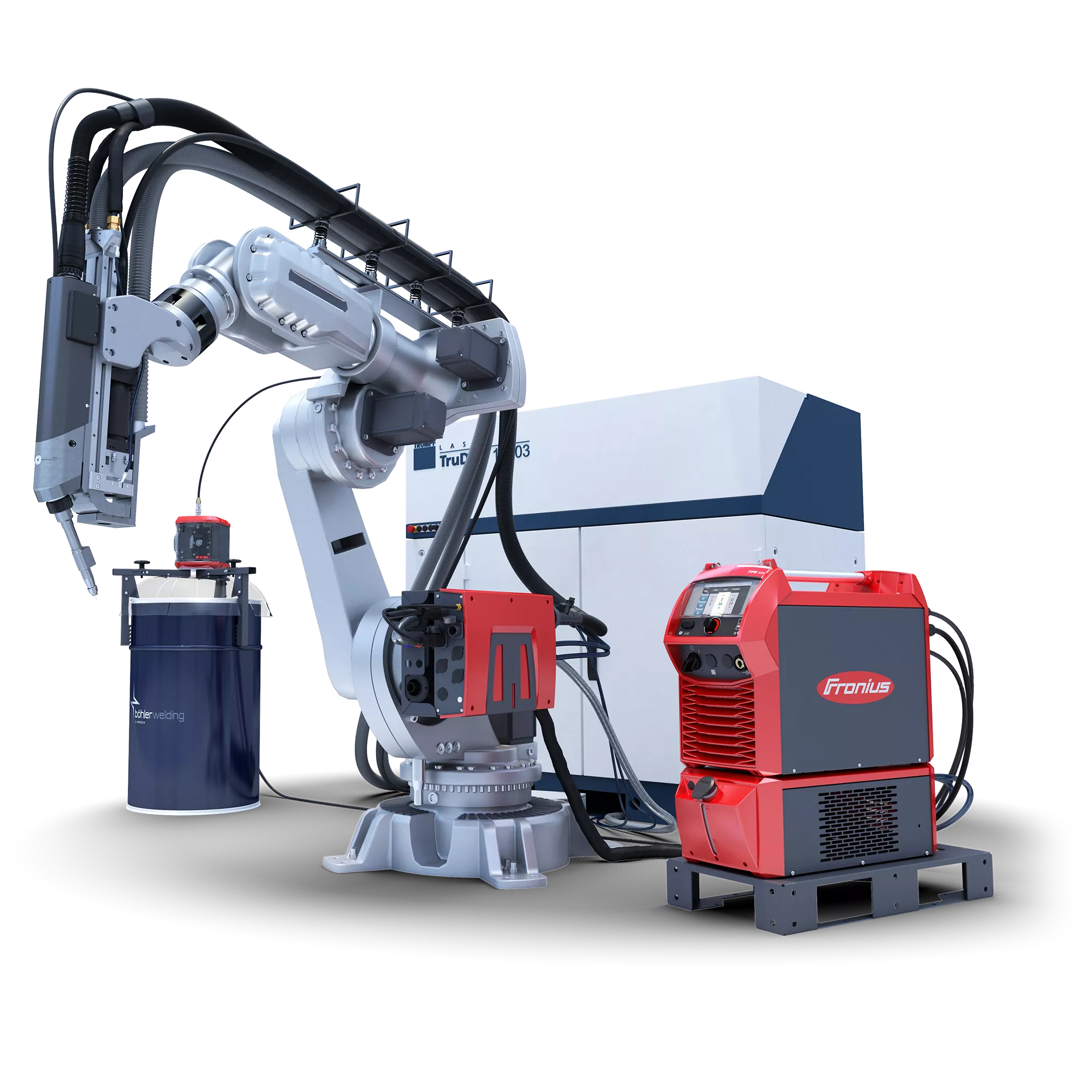

Laserhybrid Konfiguration
Example of a LaserHybrid system
1 TPS/i / 2 Cooling unit / 3 Splitbox / 4 Torch hosepack / 5 LaserHybrid welding head / 6 Wire feeder / 7 Wire barrel / 8 Cleaning station
System
components
1. TPS/i
2. Cooling unit
3. Splitbox
4. Torch hosepack
5. LaserHybrid welding head
6. Wire feeder
7. Wire barrel
8. Cleaning station
At the heart of the LaserHybrid welding system is a compact LaserHybrid head with an integrated MIG/MAG welding torch and laser optics. A robot holder connects the LaserHybrid head to a standard industrial robot. This gives the LaserHybrid head the flexibility it requires to access difficult-to-reach areas of the workpiece. The welding wire can be placed in any position with respect to the laser beam, enabling the joining process to be adapted precisely to the wide variety of weld-seam preparations, outputs, wire types, wire grades and joining tasks.

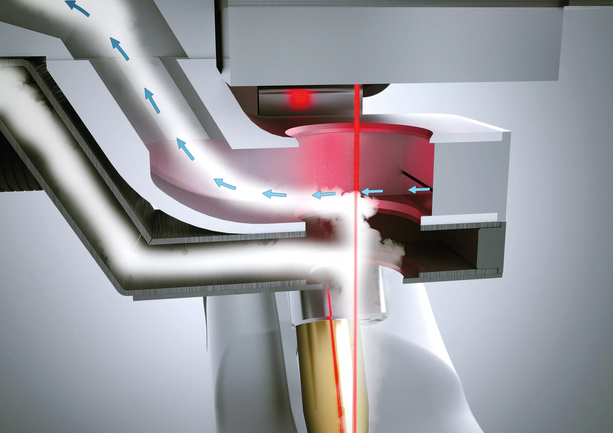

CROSSJET – innovative protection of the laser optics
Crossjet
Coated protective glass is required to protect the laser optics from welding spatter damage. The LaserHybrid head uses a Crossjet unit to ensure that the protective glass itself remains clean, undamaged and transparent for the laser. The air flow effectively diverts any spatter into an extraction channel at a supersonic speed. The air flow itself is also extracted before it can reach the weld area and interfere with the work of the shielding gas. The processing cell also remains free of contaminants and welding fumes. The integrated MIG/MAG welding torch has a dual-circuit cooling system and draws its welding current from a fully digitised inverter power source, which also controls the wirefeeder.
