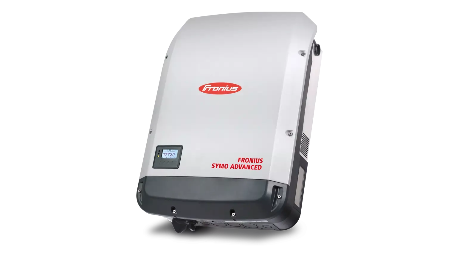

Fronius Symo Advanced
The Fronius Symo Advanced is the ideal compact three-phase inverter for commercial and industrial applications. This inverter combines the benefits of a modern string inverter, such as the Dynamic Peak Manager for shade mitigation and an integrated Power Line Communications (PLC) transmitter for SunSpec Rapid Shutdown.

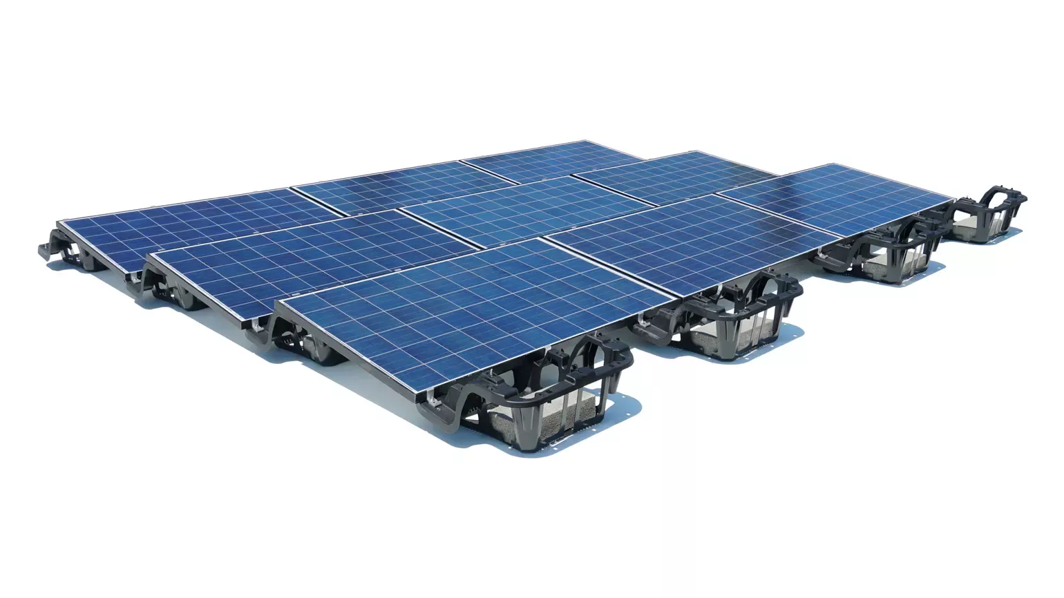

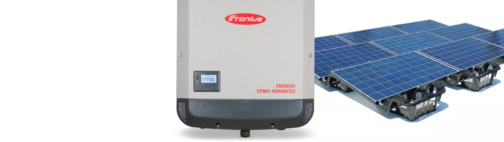

However, when installed within one foot of the array boundary in conjunction with the IronRidge BX Ballasted System, the Symo Advanced is UL 3741 certified and can be used in rapid shutdown applications without additional components.
  • Output classes 10 to 24 kW
  • Ideal for commercial applications
  • Integrated PLC transmitter (SunSpec Rapid Shutdown as standard)
  • Available for all system voltages from 208 to 240 volts
  • Models with 15 to 24 kW operate with 480-volt WYE grids
UL 3741 Certified Power Classes
  • Fronius Symo Advanced 10.0-3 208-240/Lite
  • Fronius Symo Advanced 12.0-3 208-240/Lite
  • Fronius Symo Advanced 15.0-3 480/Lite
  • Fronius Symo Advanced 20.0-3 480/Lite
  • Fronius Symo Advanced 22.7-3 480/Lite
  • Fronius Symo Advanced 24.0-3 480/Lite

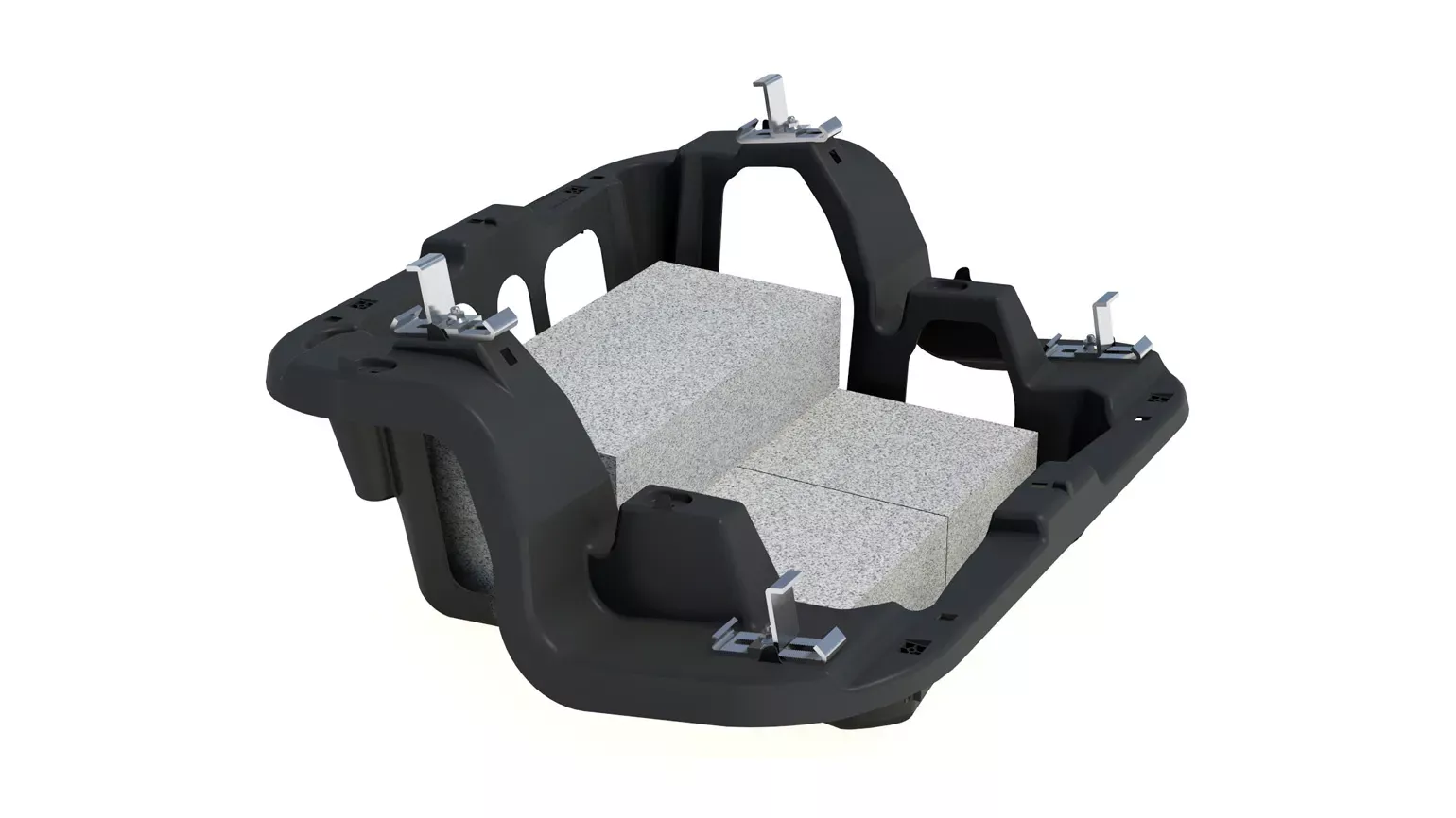

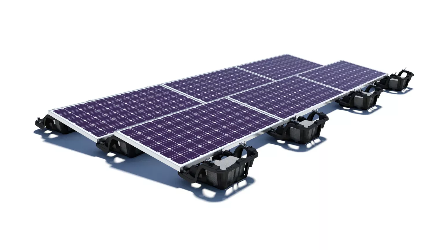

IronRidge® BX
  • Delivers superior power density and design flexibility to flat roof solar arrays.
  • Made of a glass reinforced composite, the BX Chassis is engineered for extreme structural loading, yet is also shaped to be roof-friendly and easy to install.
  • Combined with wire management components to safely route wiring under modules and through raceway channels makes this system perfect for UL 3741 applications.
