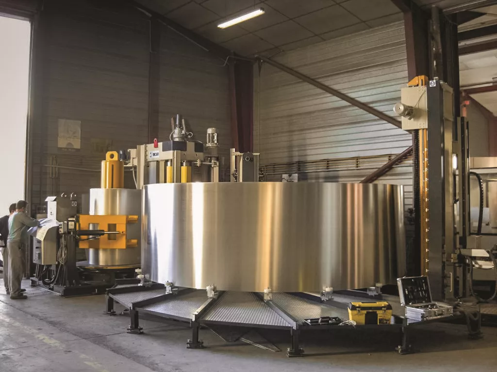

IMCAR Vertical System for Stainless Steel Applications

In the United States, tanks are traditionally produced on massive horizontal machines that use a mix of automated and manual welding. Knowing there was a better way, Weekley and his team examined the process and took it sideways. Manufacturers in Europe use vertically engineered solutions to create better tanks, more efficiently, and in less space. By offering this smarter option, FST customers could use their current floor space more efficiently. Vertical tank production works along with natural laws–such as gravity–instead of against them, eliminating problematic egg-shaping and barrel effect that can produce out of shape vessels. Manual welding and post-weld work, such as grinding and polishing, are vastly reduced with the vertical option, making the whole process more efficient.

Based on averages reported by FST’s customers, the gains over horizontal production are significant. Customers using horizontal tank fabrication (pre-FST) expected a range of 0.41 - 1.01 inches per minute of vessel production, depending on the method used. After installing the vertical FST system, the rate of production jumped to a range of 3.8 - 4.01inches per minute. Some clients have reported production capacity gains of over eight times their pre-installation capacity.
These huge increases are even more impressive when considering the difference in required square footage. A vertical system requires a minimum of 70 square feet for small vessel production and up to 1,000 square feet for larger tanks. Traditional horizontal methods require anywhere from 2,500 to 4,500 square feet of floor space, more than four times the maximum space.
