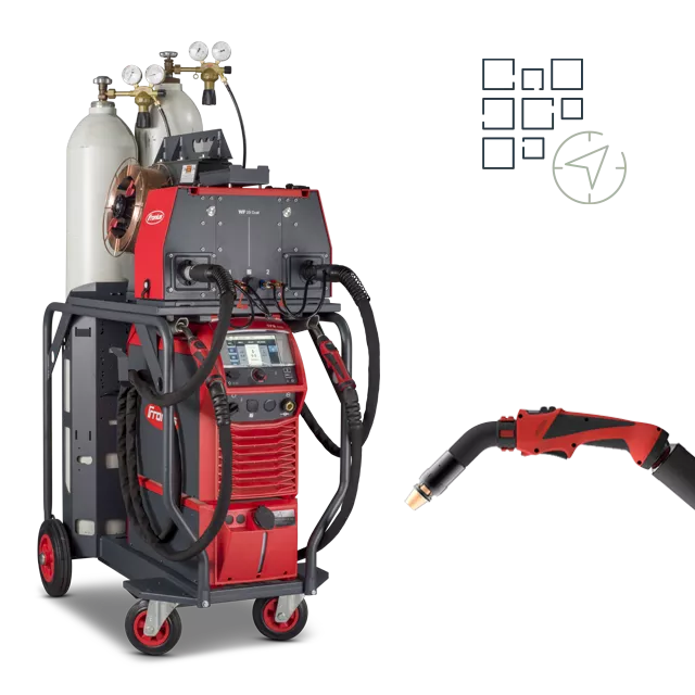

TPS/i – The MIG/MAG Welding System
The future-proof solution: welding with the TPS/i
With the TPS/i, you are ready today for the challenges of tomorrow
The TPS/i is one of the most state-of-the-art welding systems and, with its huge power capacity of up to 600 A, it meets the highest demands for steel, stainless steel, and aluminum applications.
The intelligent equipment, modular structure, and multitude of expansion options of the welding system provide the necessary flexibility and efficiency for all manner of applications.
With the TPS/i, you already have the perfect solution for tomorrow’s challenges at your fingertips, so you can fully unleash your welding potential.

    The TPS/i welding system versions at a glance
    The TPS/i is available with gas or water cooling in the 320i C, 400, 500, and 600 A power categories.
    Compact welding systems:
    TPS/i 270 C and TPS/i 320 C
    In compact units in the lower power categories, the wirefeeder is integrated directly into the housing of the welding system. As a result, the devices are easier to use, especially for manual welding tasks, and also suitable for mobile applications.
