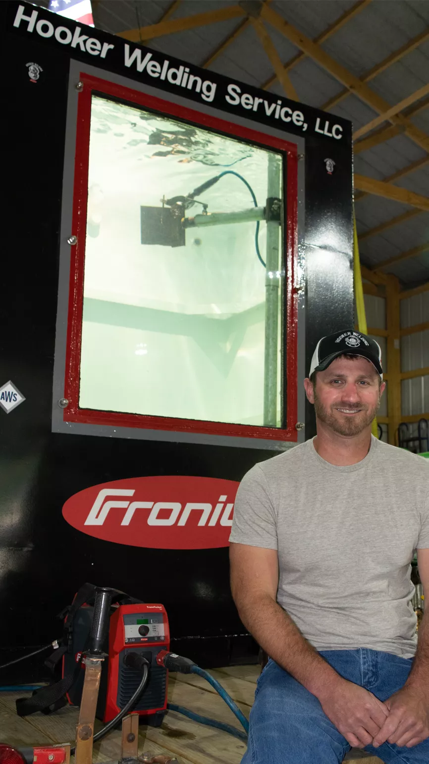

Kirk Hooker poses with his demo dive tank
Kirk Hooker with his demo dive tank
The water inside the tank lit with the brilliance of the welding arc. Specks of debris littered the now cloudy water from the hour Hooker had already spent welding inside the tank. While underwater, Hooker is reliant on his team for his air supply, electrical controls, and good communication to ensure he is safe and can do his work. The mobile dive tank he’s using is his patent-pending design. He travels with it to schools, conventions, and other gatherings to demonstrate underwater welding.
